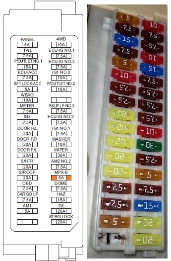

    There's one fuse that maybe you have not verified..it's a slight orange 5 amp.

    Nope, seems fine..

    Seems?;) How are you verifying the fuses?

    Pulling it out and looking for a broken connection

    Your install that caused the 7.5 A fuse to blow could've ruin the internals of the Body Electronic Control Unit...but specifically the IC circuit that handles the signal to the power relay to provide power the fuses of the power windows.
    It's just a guesstimate.
    If you had a multimeter, you could verify power to all the fuses related to the windows. Looking at them is not a sound way to verify them. A sample verification would be: with IGN ON, is power getting to any door related fuse from the PWR Relay?

    Put a meter on it and. Verify. Dont rely on a visual inspection. Seen fuses that looked good not ohm out good

    Door R/L, Door F/R, and Door F/L are all not getting power, got a multimeter and checked. Guess it the worst possible situation. Also check resistance on all fuses and every one was fine...

    So use a small jumper wire to get power to the pin 30 1A in order to verify relay works, without de-soldering it...
