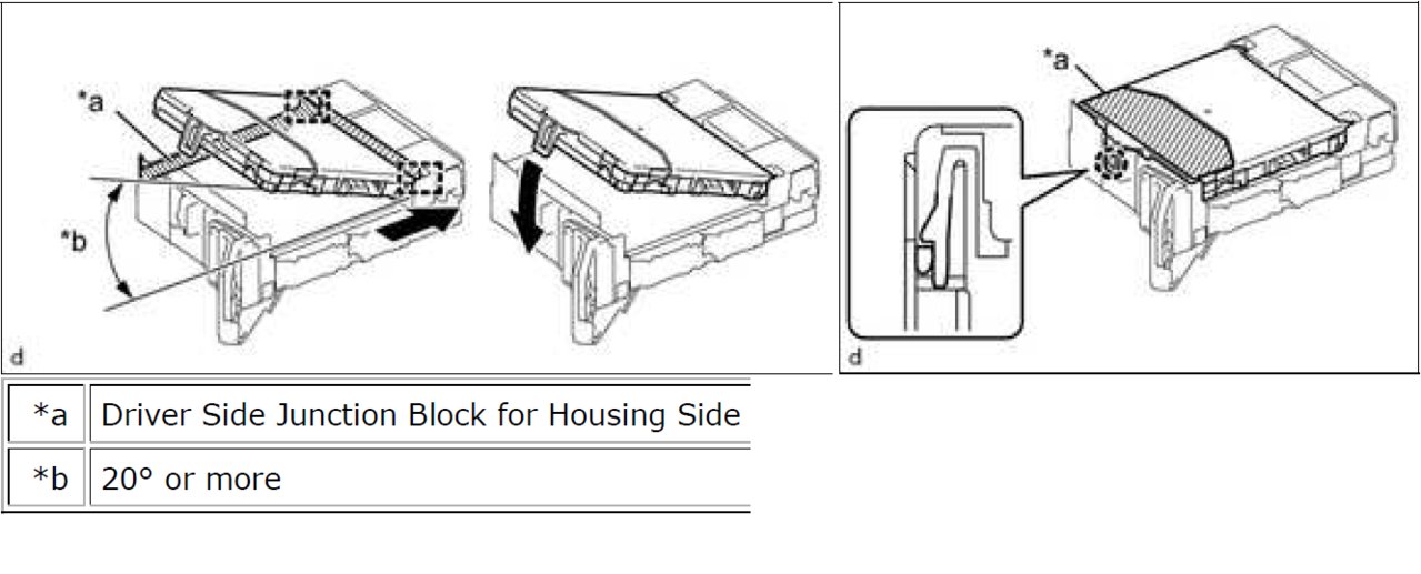

    I have no idea where 30 1A is. What would I be jumping? I’m not electrically inclined at all..

    And what am I jumping, just 30 1A to a 12v power source?

    yes..very small wire...2 person Operation. One holding the wire in place the other testing the windows function...

    But before you do that. Since you have a multimeter now, verify juice at that same location...

    Ok so what is a 12v constant that I can tap into to jump it?

    The diagnosis would be to first find out if the relay is getting signal but not switching on. That's the cheap fix. Even main processors can be changed but at that point replacing the entire board is probably cheaper.
    Don't ask me why but relays use wierd specific numbering for the coil circuit and main power circuit. 85 & 86 are coil, 30 & 87 or 87a are main power. Solid state relays use transistors, fets, or mosfets instead of coils to easily control high currents without any moving parts in much smaller packages but are more sensitive to power surges which a coil relay would more easily tolerate. It's just the kind of part that gets fried by emp.

    Doesn’t seem like any power is going to that pin

    So reduced to the MultiPlex Unit with the Junction Board still unverified. I'd say Stealership time...

    So it is the body control module?

    Yes ...removable from the Junction Board.

    So essentially I can buy another one and pop it in and all should be good, only my wallet will hate me for a while.

    Maybe in the Stealership they would do something quick, like re-initialize the system, since you did replace a blown fuse...I'm guessing here...
