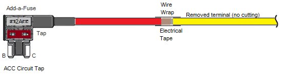

    Temp working fix: remove yellow wire M6 connector. https://www.tacomaworld.com/threads/nitoris-oem-sr-foglight-mod.451495/
    Read and follow the removal/separation of connector.
    Wrap removed terminal with stripped small gauge wire. Cover with electric tape. Get add a fuse. Get a 2 amp fuse. Select your choice ACC fuse to tap. Other end of small gauge wire to add-a-fuse. Place in fuse panel.
    ALL THIS DONE WITH NEGATIVE BATTERY TERMINAL REMOVED.
    Replace battery terminal n verify function.

    I appreciate the help and Info, but that's too much, I travel 90% of my week and don't have time to do this, I'd rather just replace the bad part and and get my truck back to working order.

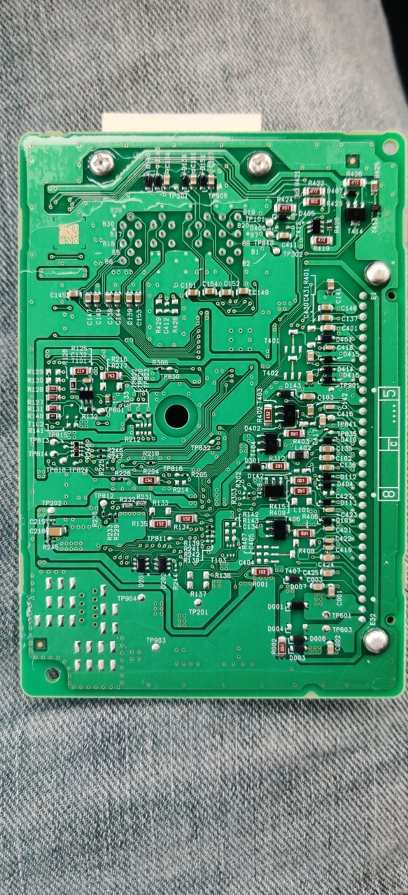

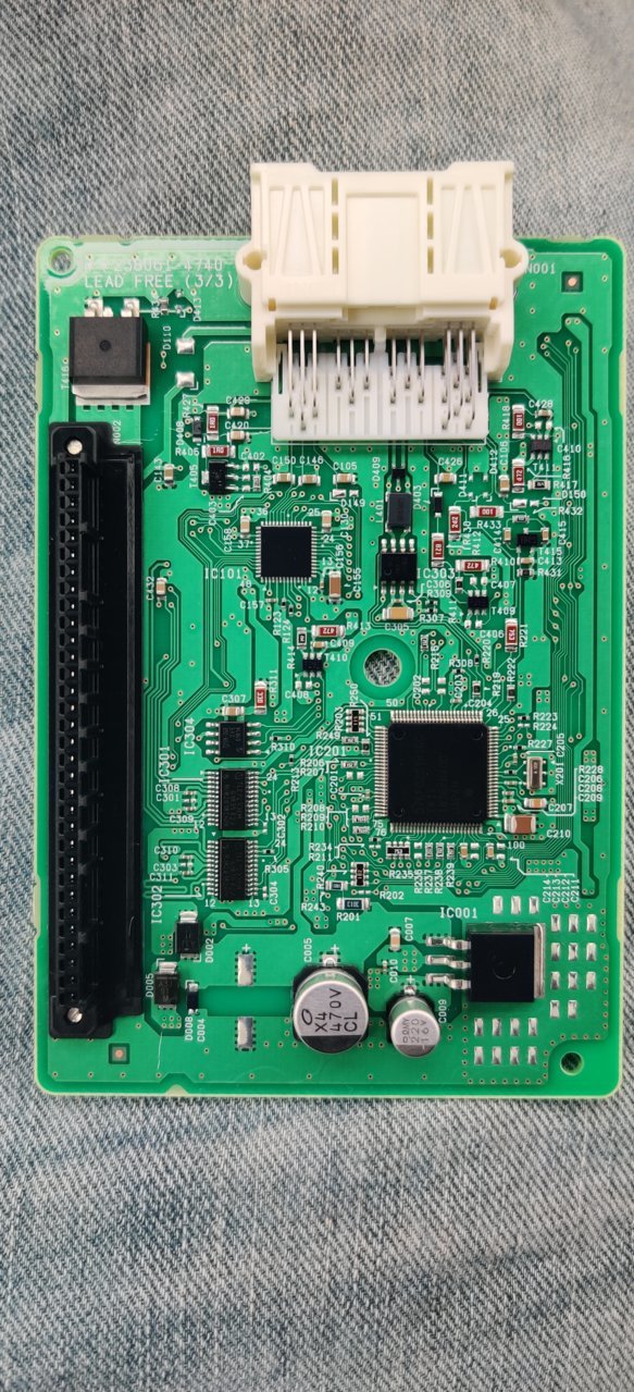

  12. Aug 23, 2019 at 9:39 AM
    #92
    Fatmonk8
    Fatmonk8 [OP] Did anyone ever tell you you're my hero?
    Dec 8, 2017
    #237952
    1,158
    Paul
    Delco, PA
    2019 SR5 Barcelona Red Taco 3.5 V6
    Sorry, not trying to resurrect a dead threat, but I just got a new BCM and windows are working again!
    Also popped open the old BCM just to look and I can't find one spot where it looks like it shorted or anything.

    Any close up pics of the BCM opened?:typing:
    How mulla did it set ya back?
  14. Aug 23, 2019 at 9:43 AM
    #94
    Fatmonk8
    Dec 8, 2017
    #237952
    1,158
    Paul
    Delco, PA
    I'll post pics in a bit, twas about $500.
