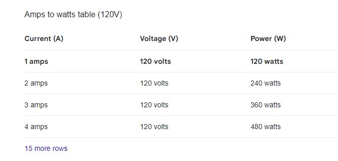

  2. Dec 26, 2021 at 3:39 PM
    boston23
    boston23 [OP] Well-Known Member
    Sep 4, 2019
    #304290
    3,743
    Adam
    Eastie
    2019 SR5 DCSB 4x4
