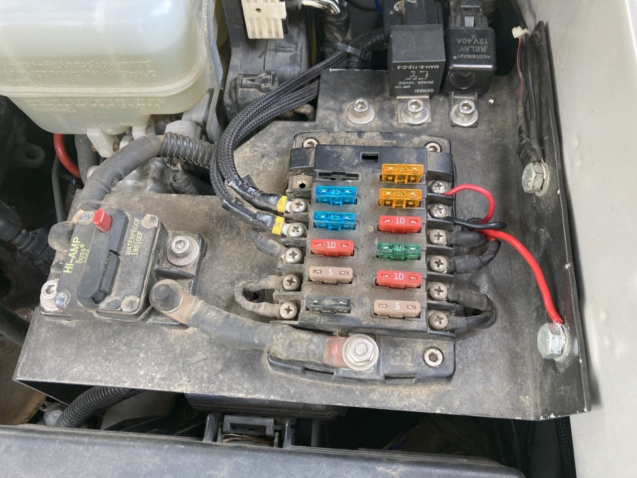

    Why is your ground wire red? :(

    Because for some reason the ground wire on the stupid relay I bought was red. Wasn't trying to repin the harness just to change the color of wire. I agree it's annoying but not annoying enough to change.
    EDIT: it's the same relay that has the black power wire on the fuse block... :rolleyes:

    That's why they make colored tape. Fix that ish' haha.

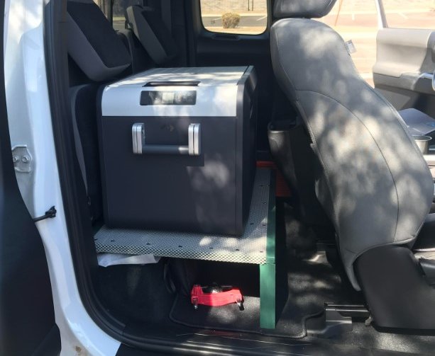

    In my A/C I built a little platform to hold my Dometic, and had someone run a 12-v plug from under the drivers side cubby -
    I plug the Dometic into that while driving.
    When parked it gets power from the Jackery 1000 Pro. When the Jackery needs a boost I hook up the 200w solar panels.
    The A/C Plug up front is where I plug my brake-controller in otherwise I'd use that.
    I can run this little mini-fridge for 4-5 days no muss no fuss and it's as cold as the fridge at my house.
    The 12-v plug in the back runs up under to the battery in an ignition-only setup so it's only drawing while the truck is running.

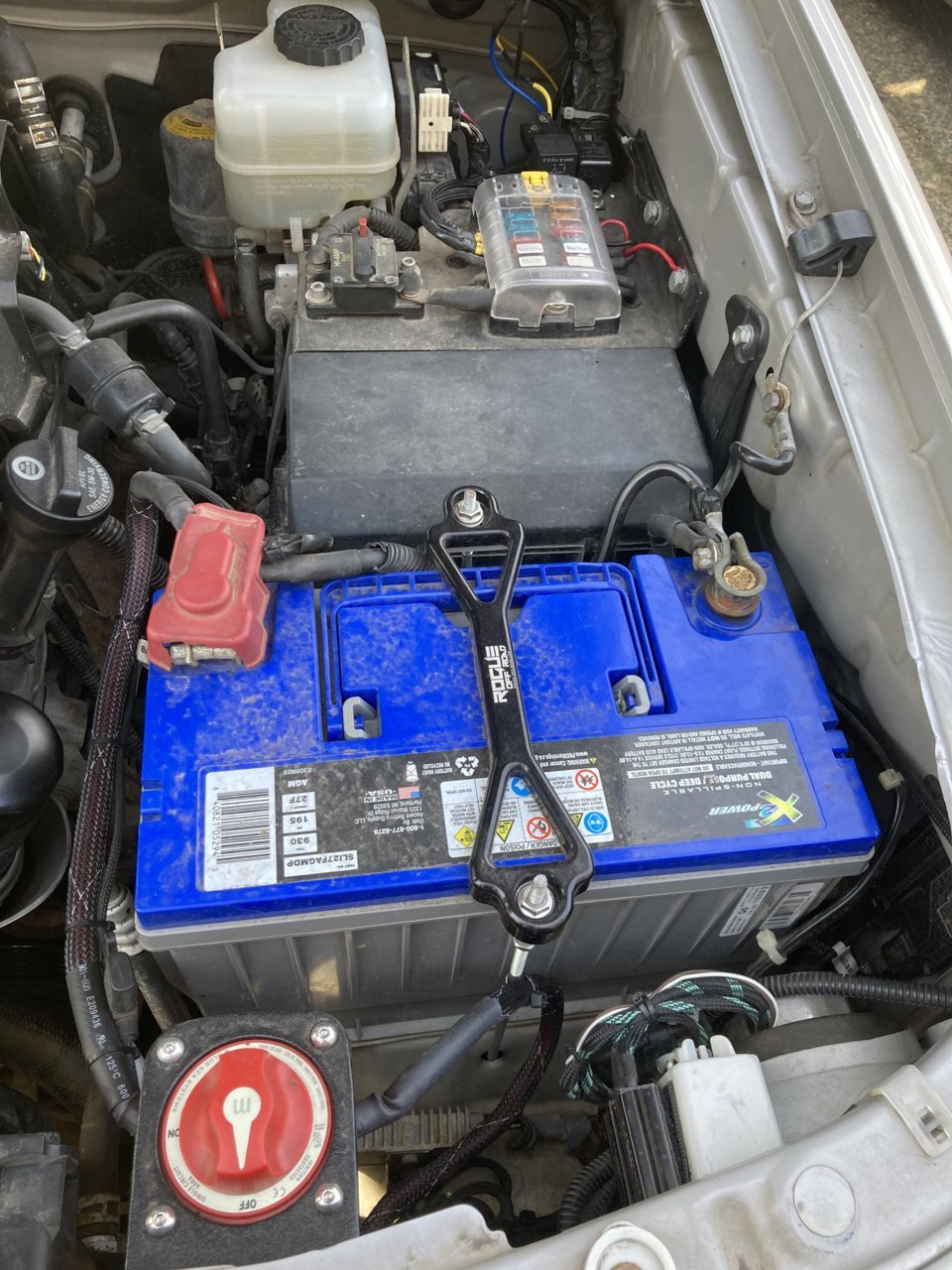

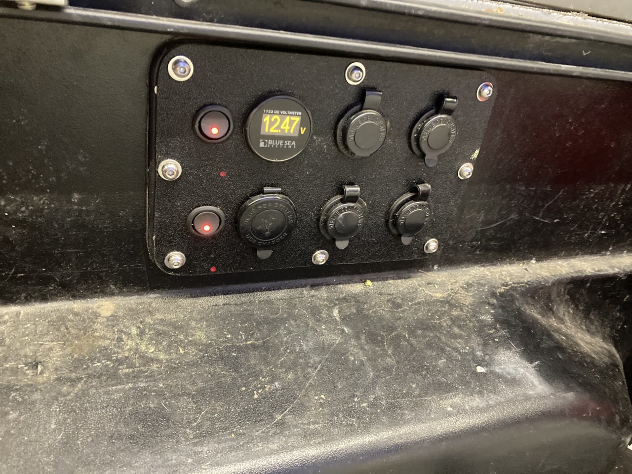

    I have a dual battery setup both agm, cascadia 4x4 solar panel on the hood, dedicated 12v 10 gauge to the back with blue sea panel back there, has a voltmeter, cigarette outlet, and usb. Inside the cab I also ran a dedicated wire to the cigarette lighter. So the fridge can be in or out, and always on.

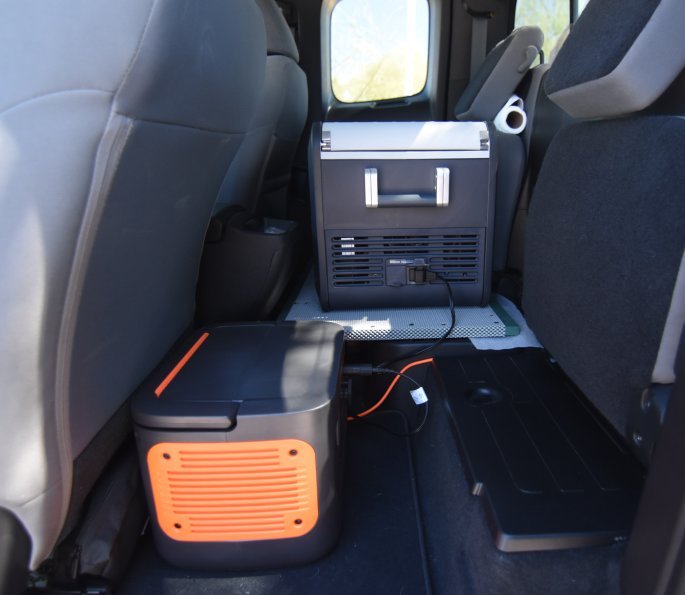

    I did a 12 day trip Running my 1000watt jackery to fridge never busted out my solar panels.
    rear seat delete with my fridge and my trusty companion coco in the back in her bed. Have the jackery plugged in 12v so charges while driving

    This seems like the simplest option I've seen. So you literally just plug the jackery into the outlet and that's it? Also is there a way you can plug it into the cab? I'll be storing my fridge in the back seat.

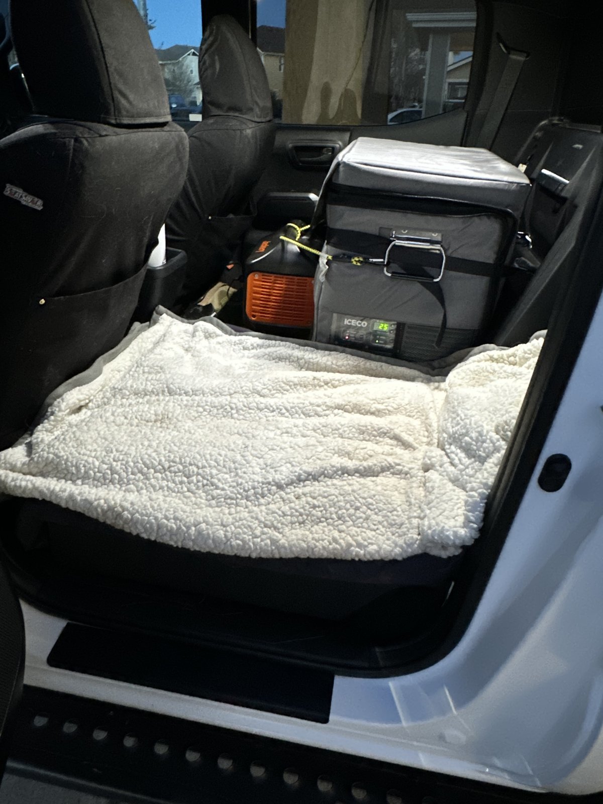

    This is the setup I'd like to roll with. This is probably a dumb question as I know next to nothing about electronics, but where is the jackery plugged into?

    Jackery is plugged into 12v so while I’m driving it is getting charged if needed
