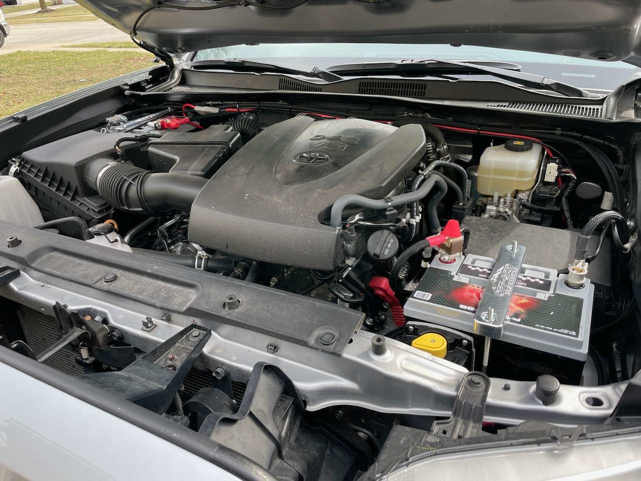

    Yeah this was just an "oh crap" need for a short use. But I ended up getting 8AWG and ran it to the back seat. I can tap into that when I run it to the bed now too! Thanks, Toyota, for waiting until the 4th gen to run 12V to the bed :rant:
    Absolutely. I've seen the blankets work wonders, I don't have one yet. That's a double edged sword for me, I have a 100W solar panel up top. So, the more sun/heat there is, the more juice I get from that! I just got back from a trip where I was parked starting Saturday around 2PM until Monday around 2PM and it started lickity split. Granted, it did get down to about 25 at nights, so it wasn't working that hard.
    And depends on the temperature set too. If I'm just cooling down beers, 45 is plenty cool. If I have ice cream in there, that's a different story :p
    The Dometic I have has a Hi med lo option for cutoff.
    Right now, I am on the stock battery and have a jump pack if needed.
    Once this battery kicks it (it's already almost 5 years old), I'm going up to an AGM which should be more than enough.
    Bonus points, the MPPT controller can get the voltage high enough for the AGM so I don't have to touch the ECU tune to pump out a higher voltage for the battery.

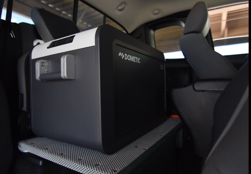

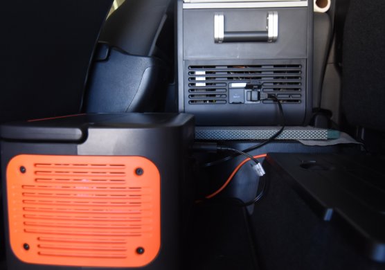

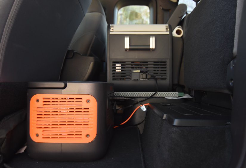

    Not sure if I posted on this thread or not -

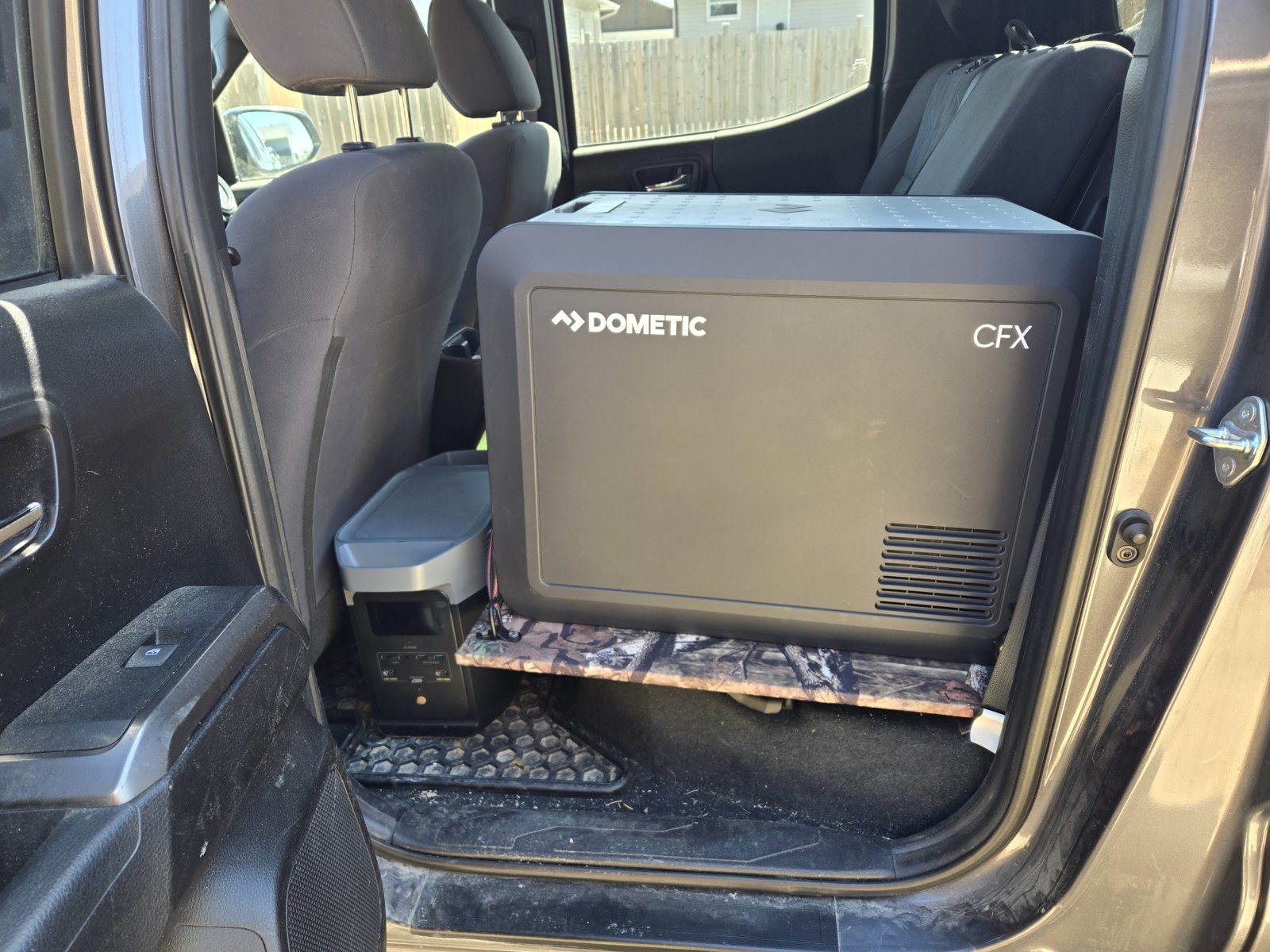

    I too love my Dometic and Jackery setup.
    Ice is a pain in the azz to deal with and this Dometic rocks.
    Very basic 'platform' for the Access Cab and the Jackery sets on the other side.
    The fridge is powered via 12v to the battery ( ignition only ) via a port under the cubby with a notch so the wires
    slip in there sweet.
    Then when the truck is off the Dometic switches over to the Jackery.
    Should I need to, the 200 Watt Solar Panels hook up via the sliding window in the back for re-charging the Jackery if electricity isn't available.
    Got Nukes?.... come at me - I can hook up the little camper and load up some water and dry-goods and go far into the woods and live as well
    or better than a lot of people do at there homes.

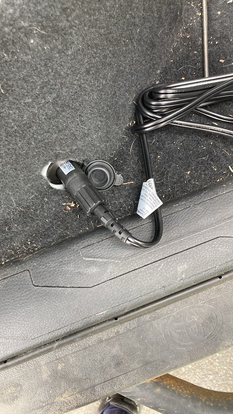

    I have mine kind of janky in the rear under seat cubby. But, it turns out, there's a hole exactly the size of the 12V plug there....
    I have a video of me closing the door. No this is not good. But it's not BAD. It holds it in.
    But I will likely be wanting to go to an Anderson connector for the bed anyway, so I might be changing this up. I was thinking about those, so it's good to have input that the regular 12V is no bueno.

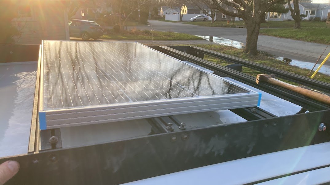

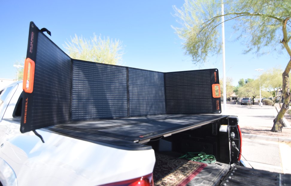

    I use a 100W panel and it keeps up with a Dometic 45L, and a few others have done the same. Single battery - mine is currently stock and doing fine, but will be going to AGM when it dies.
    I might see if I can spin it to be along the truck, so the passenger side can hold my J bars again. But this was fit perfectly, and I wanted to get it up there ASAP for a trip this past weekend. I don't need it until mid May now, so I have some time to rework it.
    So, DO NOT GET THIS ONE. Not because it's bad, but because the max PV input is 120W.
    https://www.amazon.com/Intelligent-MPPT-Solar-Controller-Connectors/dp/B09F697FBV?th=1
    This is the one I have. I got it with a 20W panel last year to keep my battery topped up since it was failing with my short commutes (only 1.5 miles) and the alternator couldn't keep up. Once I got the fridge I just swapped it to a 100W panel using the same MPPT.
    I like it, it works, it does great things. But it won't work for your panel. They have another 20A one on their Amazon store, I'd look at that one.
    Putting a ring terminal connector takes about 45 seconds, I'd say that's worth the hassle.

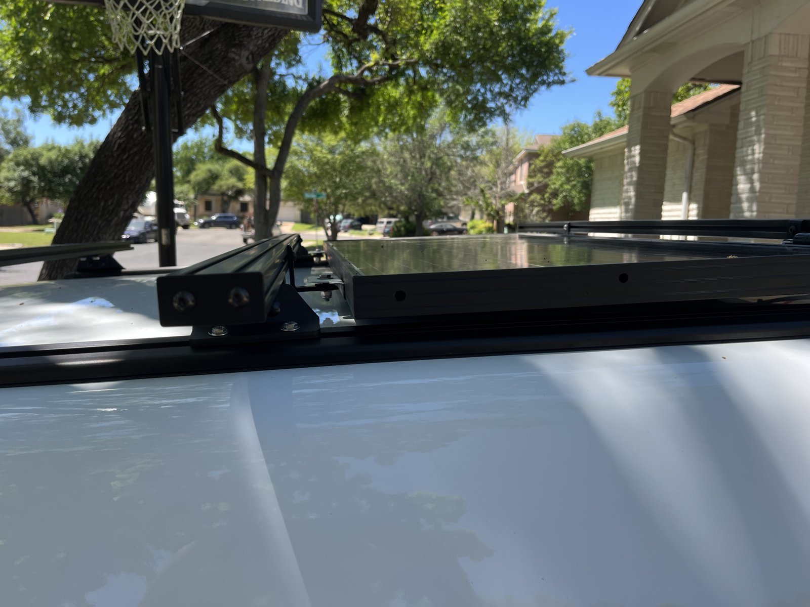

    ^^ Some great setups here! If you removed a couple of your cross bars you could drop that panel down lower and have the remaining cross bars still available to put stuff on. Whatever else you put up there would obscure sun from the panel so it couldn’t be permanent, but it’s nice having a spot to temporarily put a kayak, a piece of furniture, or whatever.
    Mine is secured into the side slots instead of the crossbar, instead of the top, with t-slot L brackets and the Renogy solar panel brackets.

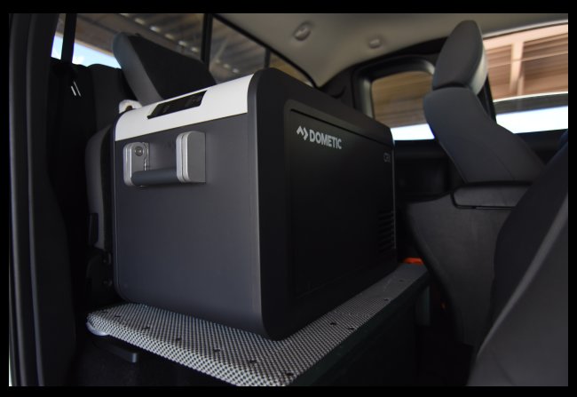

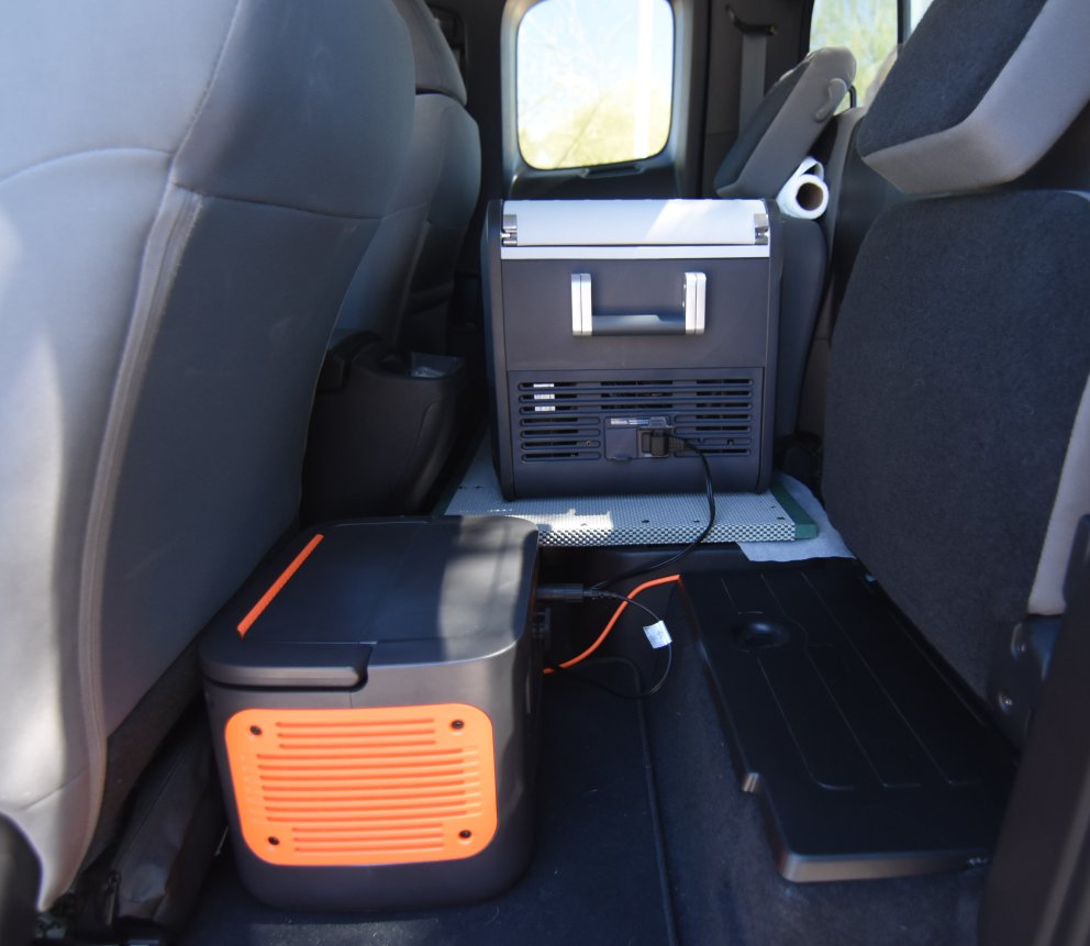

    I use the current 12v cig lighter plug to power my hand-held brake controller.
    I had a shop rig another 12v connection under the rear cubby ( access cab ) and notch a slot so I can run
    the cord into it. That connection runs under the carpet through the firewall to the battery. It's 'turned-on'
    when the truck is running and powers the Dometic while driving.
    When I stop for extended periods ( ie: to camp etc ) it's no longer powering the Dometic so I turn on the Jackery
    to do the job.
    The setup works well we were out for 5 days and it held up well. Worse case is I can re-juice the jackery with electricity
    if available or flop out the solar panels and give it a boost up to re-charge it.

    Jackery setup:

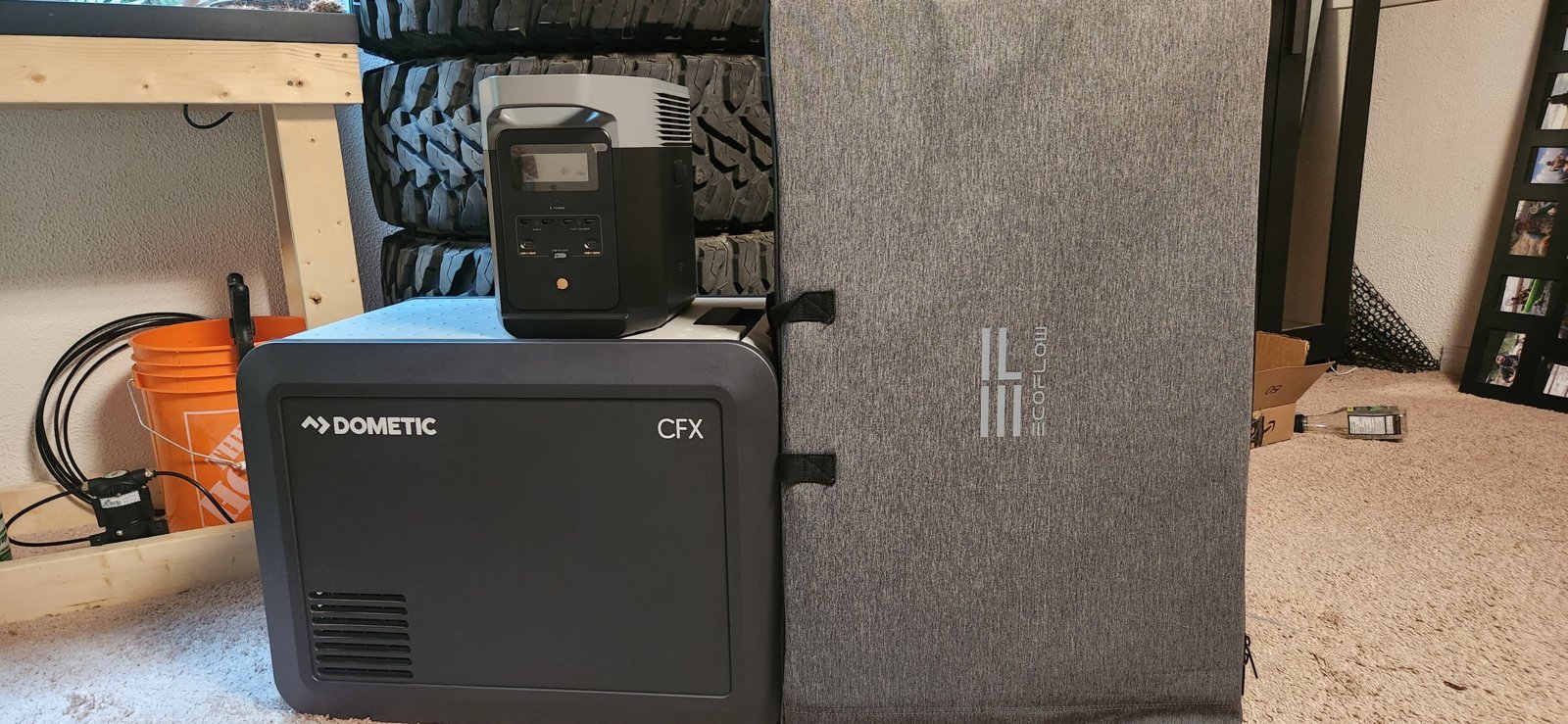

    Got the fridge and delta 2 in the other week.
    Did a bit of testing with the solar while I was out there, I was able to get 160 watts of charge on a low sun afternoon. Dropped to 80 with any cloud cover as long as it's not horribly overcast I should have ample supplemental power for my longer trips when I'm parked in 1 spot for a few days

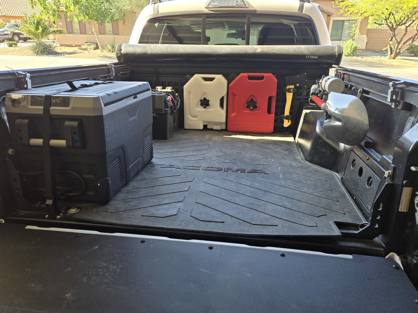

    I chose to run the fridge directly off a 500W power station via it's DC port and feed the powerstation from the truck's 120V outlet. It's able to easily keep the fridge below freezing and the power station fully charged up while moving. I chose that route because I sometimes forget to turn on the truck's AC when I drive off which screws up my whole power/cooling scheme. I know could use the low voltage cutoff and run directly off the truck's battery (I also carry a jump starter) but I don't care to cycle the truck battery like that when there's other options nearby plus I don't like relying on the fridge's cutoff circuitry to protect my battery. I usually run the fridge on the cold side when there's AC available and dial it back when I'm stopped overnight. One thing to consider when running off DC that's wired into the bed is the voltage drop that can occur depending on the wire gauge being used. It can be significant with sub optimal gauge wiring which amounts to allot of waste when there's not much to waste. The fridge blanket noticeably reduced the compressor's cycling. I also keep the fridge is inside the cab when moving where it's much cooler plus I can easily grab an icy cold drink without stopping. I plan to wire in a 100W solar panel also. Mostly for extended stays but I suspect I'll be able to detach completely from the truck's electrical system all the time with a 500W power station and a 100W panel.
    With the intense sun around here solar is a really good way to supplement the system. Many years in the electrical industry taught me a great lesson, eliminating small inefficiencies in the system can lead to significant improvements in the overall system efficiency.

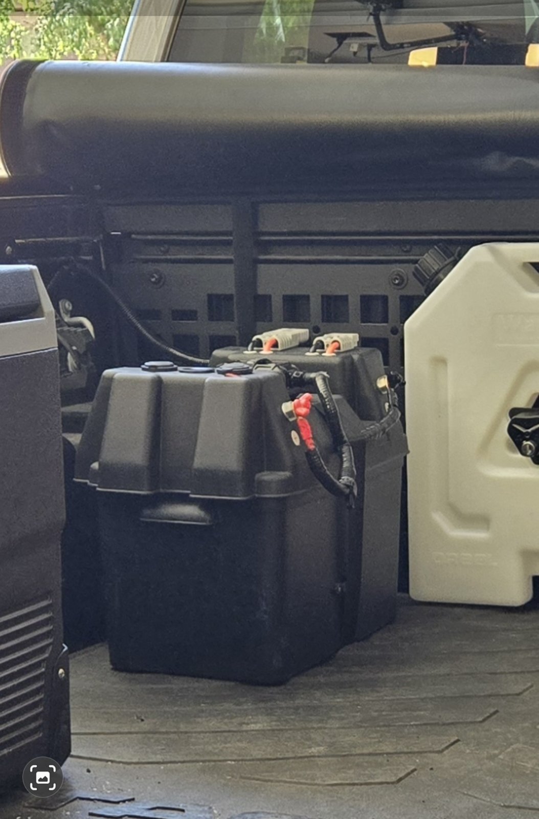

    Took a different approach. I'm still considering the dual battery set up in the future, but not convinced the design is ideal. After reading other stories that the added weight of 2 batteries in the factory location has caused the metal to tear, I opted for a more solid solution, for now.
    Using a deep cycle battery and a smart battery box. Both the cooler and battery at strapped to the floor in the bed of my truck. The box has anderson connectors and so does my power cord to the cooler. I have a batter selector switch that allows me to power the cooler from the main truck battery when I'm driving or, from the deep cycle when parked. The deep cycle does not charge when the truck is running. It has a NOCO charger mounted on the box that I plug in at home. For me this set up works as I'm not off the grid for several days at a time.

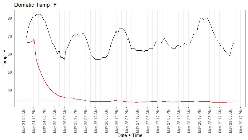

    I did a small experiment. Friday afternoon before the long weekend, I loaded up a room-temp Dometic CFF45 with room-temp water. I parked in the sun, and set it to 34°F. I have a 100W solar panel and an X2Power 27F AGM. I dropped a temperature logger in there to keep an eye on it. I did not move the truck (no ignition) until this morning, May 29 around 8AM (where the data cuts off anyway). I let the fridge bring everything in there down to temp. Picture of what was loaded in there (all water/iced tea cans) down under too. Parked in my driveway which gets a decent amount of sun through the day.
    3 things plotted
    • Black is ambient outside temp (didn't have a way to record truck cab temperature)
    • Red is fridge temp
    • Blue is set temp 34°F
    All this to say I am quite happy with the solar and 27F for a "park up and sit for a week" camp approach. Cycling in water instead of air to keep thermal mass will be crucial.
    Thanks everyone for the help I've asked along the way to get this set up. This will be a game changer :D

    Would be interesting to see voltage on that plot too

    Yeah, I don't have that capability right now. If you or anyone wants to lend me a data logger for battery voltage, I'm happy to run this again over the 4th of July weekend. :D
    This is what I used for temperatures
    https://www.amazon.com/dp/B0BVLYPYT1?ref=ppx_yo2ov_dt_b_product_details

    I'm happy as a clam with mine too. I set mine on a platform in the rear of my Access Cab and had some dudes
    wire up a 12-v connection ( ignition only to the battery ) under one of the jump seats. Jackery 1000 Pro runs the
    Dometic when not driving otherwise the 12-v takes over. We did a 5-day trip last summer ( Arizona heat!! ) and it
    was great. Planning a Grand Canyon trip in a few weeks.
    Not having to deal with ice is great. We load up small tupperware 'meals' for 2 and stack them up along with room
    for drinks and it works like a champ. We don't have to 'cook' we just heat up the good stuff.
    Enough room exists to drop the Jump Seat and stack some of these HDX storage boxes with dry goods, coffee beans,
    grinders, etc. I think I can stack 3 of those on the seat.
