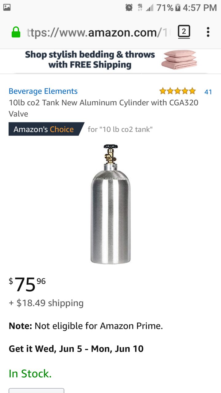

    Here's a 10lb at 1800psi for $25 less.
    It's below in the "other people also bought? Section.

    That's not too bad at all. could be into the whole thing for ~$130. Thanks!

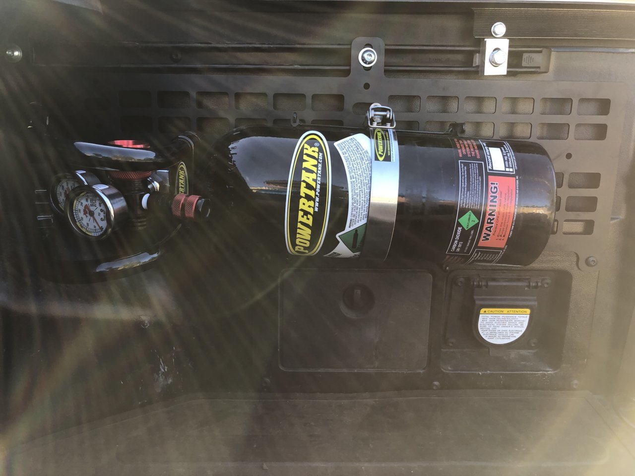

    Buy the regulator from PowerTank then use your own bottles. Remember they expire every five years and it holds the air in liquid form not gas so count on very high pressure. I own a power tank and find it very convenient for airing up but it comes at a cost for the equipment and refills.

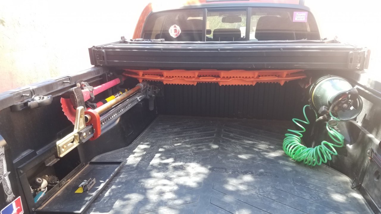

    If you buy a tank from the place you get it filled they will just exchange it every time with no wait and no worries about pressure testing ever. I had a real power tank when they 1st came out many years ago and now I have one that I put together completely from Amazon and the gas supplier. The only difference is the power tank is pretty and the tank you get from the supplier may or may not be every time you exchange it

    I will have to go back and find them as it's been quite a while. But the regulator is a fixed pressure unit with no gauge. No need for one really. The hose it's a $15 cold tolerant hose, and the tank is a 5# tank that I swap every fill. Some people pay for the blingy power tank because looks. I'm a function guy. Carrying the tank anywhere other than the bed or behind the seat just to show it off is just silly.

    I now have a 20 lb tank and this one which is 5.
