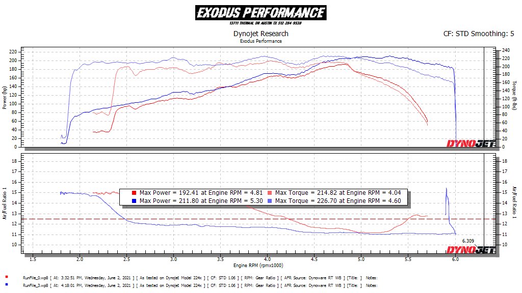

    2017 Tacoma TRD Pro AT Cement - POWERTHIRST v2.4 Tuned
    POWERTHIRST Tuned - My Custom OVTune SSO Slimline Bumper with Stage 2 Kit + BajaDesigns 20" Light bar with Amber Backlight + Smittybilt Winch x2o 10,000lb Synthetic CaliRaisedLED Step Edition Rock Sliders SUSPENSION FRONT A.D.S. - 2.5 Adjustable Dampening Remote Resi Fronts Dirt King Upper Control Arms SUSPENSION REAR A.D.S - 2.5 Smoothie Piggy Back "Rear" Shock With Compression Adjuster Deaver Leaf Pack Cab Mount Relocate by Triple-C Chop Shop, Lago Vista, TX Nitro Gear 5.29 BFG KM3 35x12.5x17 Fuel Rebel6 17" Wheels + Full-size Spare + Rhino-Rack Spare Wheel Strap 4x Rigid Cube Ditch Lights + Cali Raised Ditch Light Hood Mount Brackets + Cali Raised Ditch Light Extension Brackets + 3x Cali Raised Switches + Light Switch Mount Bracket Snugtop Camper Shell with Carpeted Ceiling and Mounting Tracks Prinsu Top Rack and Cab Rack Hi-lift Jack + Hi-lift Jack Mount on roof DEFEND INDUST Recovery Traction Tracks (knockoff Maxtrax) Trimax ST30 Trimaflex Spare Tire Cable Lock (Round Key) 36" x 12mm K&N Intake Canvas 270 RV Awning Rooftop Sun Shelter + Prinsu Awning Brackets Fire Extinguisher w/mount Campbell Hausfeld FP209499AV - 3 Gallon Air Compressor
    I COULD add GL to OVTune (which I have editable files for my ECU) but I don't have the editable OVTune files for the truck I was using for the dyno runs (the most stock taco any of my friends own). I just had the .p5f files.
    Here is the proof! Top chart is HP and Torque. Max torque at high RPM and WOT was about 12ft-lbs better, but most of the lower RPMs it's a steady 20ft-lbs better than stock. HP is max 20hp higher. All testing was on Reg gas, since I wanted to be able to tell the 'average' PowerThirst customer what they can expect.
    Bottom chart is AFR, with the target (dotted flat line) set at 12.7. You can see that blue (PowerThirst) tracks at about 12 for most of the run, whereas stock is WAY too lean then blows past target to being too rich. Getting this balanced better is my goal for the next dyno runs, which should be next Wednesday!
    @PapaRee , @TermLimits , @Chadr7858 , @uploadadventure @Mooseditty17 I know you guys have been itching to see these!

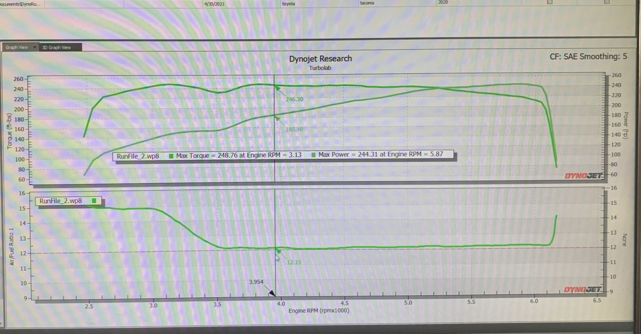

    First off, nice work. I too have had a similar recent experience of going into dyno runs blind and new/dumb to it. It’s a freaky yet awesome and humbling learning experience.
    A few questions:
    1. Why does the stock pull start 700 RPM higher?
    2. That stock AFR looks really strange. My experience didn’t show that shape at all on the stock tune. Did the dyno shop have any input on that?
    *edit - added the stock tune dyno run on totally stock 2020 04B81 ECU, 91 oct.
    **edit edit
    3. Was that a totally stock truck in the dyno?

    So this shop is HPTuner (GM tuning) only, and since you can't even plug in HP Tuner on a 3rd gen Taco to log data, this is all with a tailpipe sniffer, so YMMV, apparently. He was pretty confused at seeing that as well, but really had no comment on it, since he's never had a Toyota on the dyno ever.
    As for starting the pull at a higher RPM, I did the stock runs first, so that was me just getting into 4th gear, and not slowing it down once gearlocked in 4th before flooring it for the pull. Chalk it up to me being a noob on the dyno.

    Got it. The shop drove all the pulls for my stupid noob experience. They also just used the TP sniffer and couldn’t plug in. I added another question above. Was that a stock truck on stock wheels/tires?

    Yes, it was a totally stock TRD Offroad 04B81, stock wheels, stock tires. Well, dude's got a low profile bed rack and a rooftop tent, but that's it! The Dyno is probably the ONLY place that doesn't slow you down haha.

    You’re basically at sea level in Austin, right? The run I posted above was totally stock DCLB OR at ~4200 ft above sea level. It was a 2020 O4B81 also.
    One thing I came away from my dyno experience with was a whole lot of things I’d do differently.
