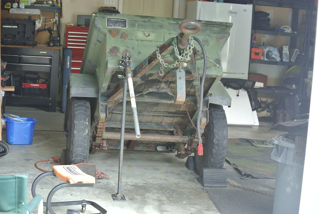

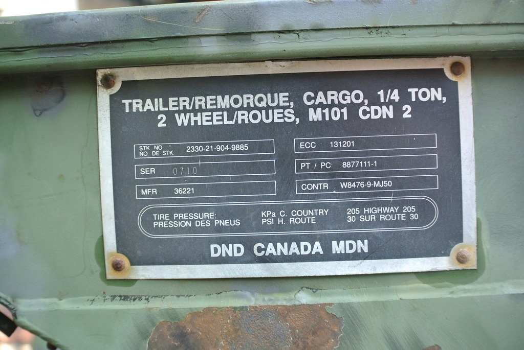

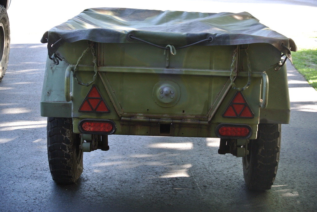

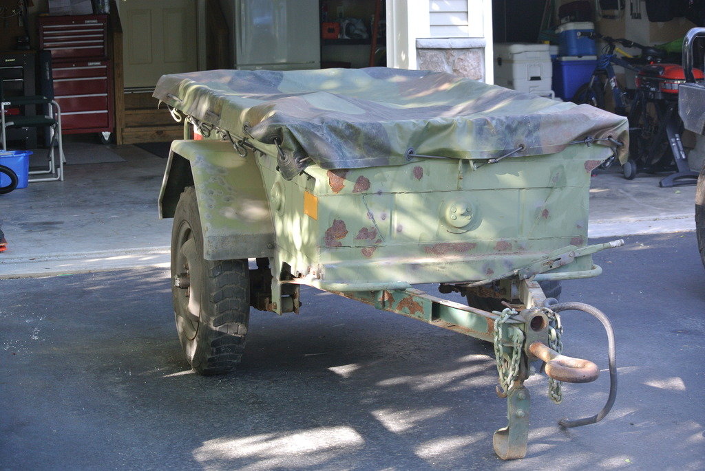

    Finally got myself a new project. I plan on converting the trailer to an overland trailer that I can tow in and out of state parks and other camping areas. As much as I love the RTT I think it'll be a nice luxury to be able to set up camp, then go explore without constantly setting up and breaking down the tent/setup. I've always loved these 1/4 ton military trailers and to me the M101 CDN2 is the best 1/4 ton option out there. Here's the trailer as I bought it:
    SPECS:
    1992 M101 CDN2 1/4 ton military trailer
    3500lb axle w/ SUA leaf spring setup
    Lever-activated Hydraulic parking brakes
    Original weather-proof canvas cover
    WORK ALREADY DONE:
    24v to 12v electrical conversion
    Recessed LED tail lights
    Custom tailgate
    TO BE DONE IMMEDIATELY:
    Complete teardown of trailer
    Temporary paint job
    3500lb replacement axle w/ matching Toyota hubs
    Electric Brakes
    Re-wire trailer for new brakes
    SOA leaf spring setup
    Replace shocks
    33s or 35s w/ Toyota rims
    Rack system for RTT
    PLANS FOR THE FUTURE:
    Professionally sandblasted and painted
    Steel Lid
    Collapsable Rack System
    Extend trailer tongue
    Max Coupler or Lock N Roll
    Battery Setup
    Whatever else I can think of

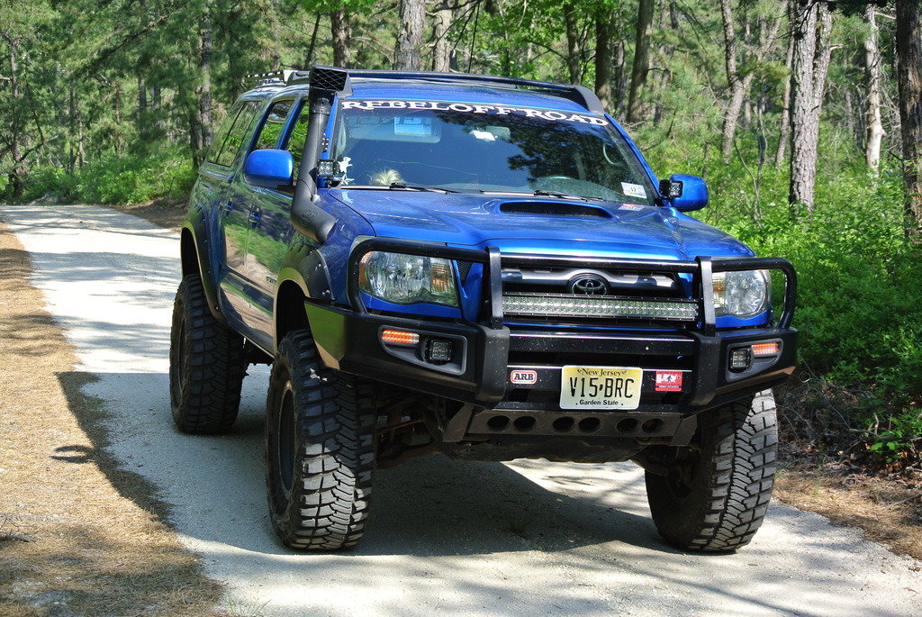

    Tow Vehicle: DSC_6875_zpsuzxphdv7_3b565a671184dc4cb4920bafa96ef833fcdea63d.jpg

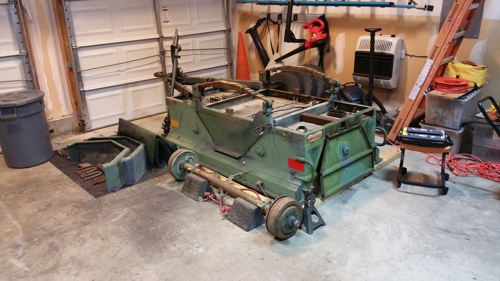

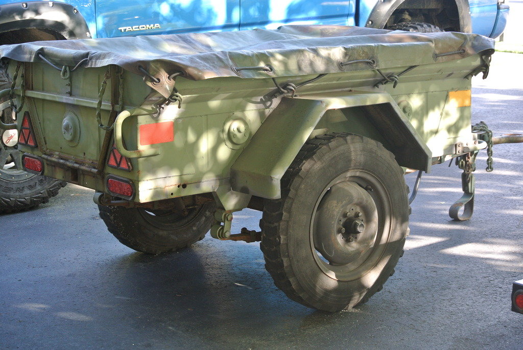

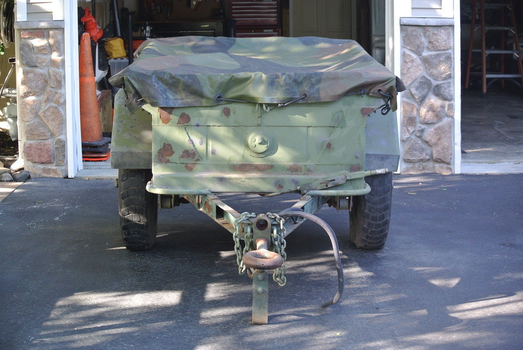

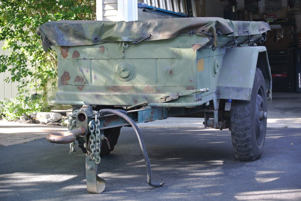

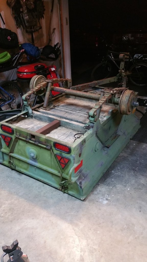

    More pics of when I brought the trailer home:

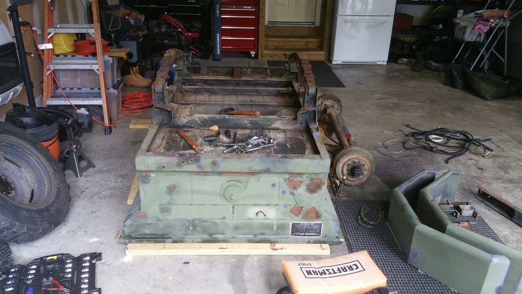

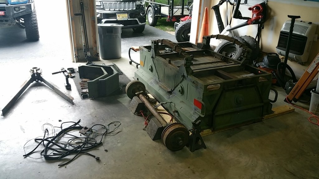

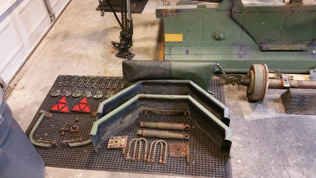

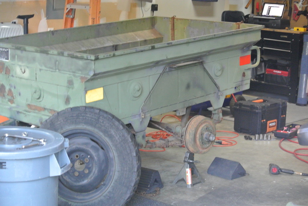

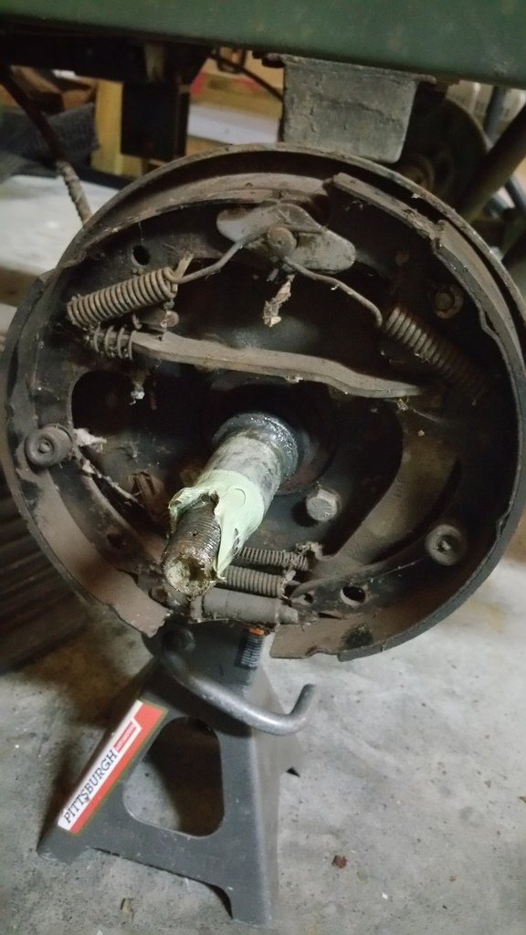

    Pictures of the teardown:
    25 year old brake assembly:
    Torn down

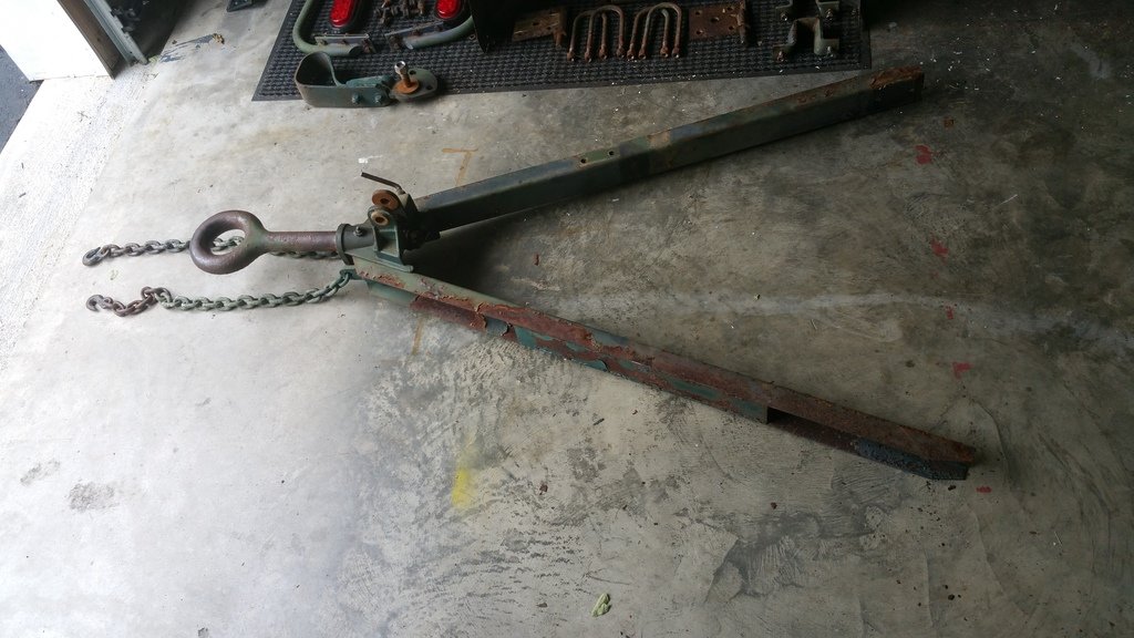

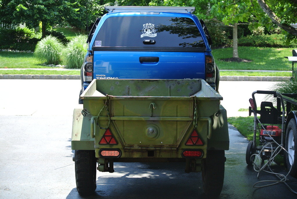

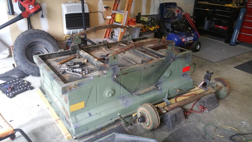

    Did some more tearing down today.. took of the tongue and mounts.. This should be as much as I tear down. Bought all new hardware today also to replace the old stuff

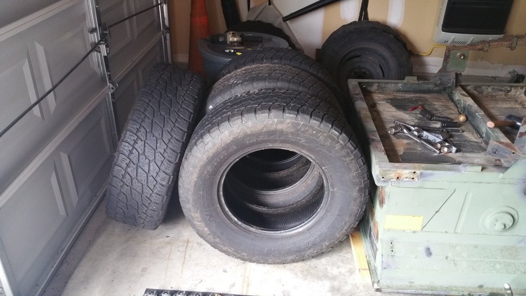

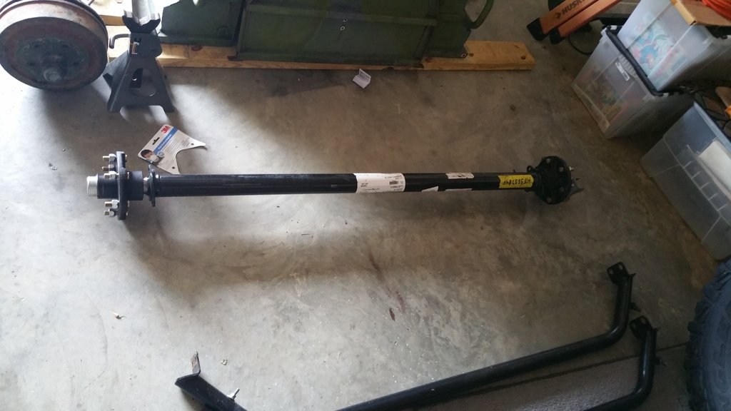

    Some updates on the trailer.. got a lot of new parts for it over the past few days. New axle, electric brakes, wiring harness, and some meats. @philnj let me take his old tires that are collecting dust in his yard. 285/70/17 Nitto Terra Grapplers. Im gonna buy some FJ steelies to use, they're cheap, and look great IMO

    A lot of websites sell brakes, almost every trailer website i looked at had brakes available.. you just gotta make sure they are compatible with your axle. I wound up getting these off some store located out west. They are electric brakes, but can still use a parking brake which I like a lot about the CDN M101

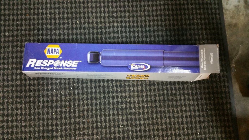

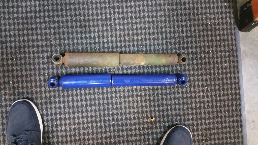

    New shocks came in also, $20 ea plus shipping. They are NAPA replacements with almost identical specs to the stock military shocks.

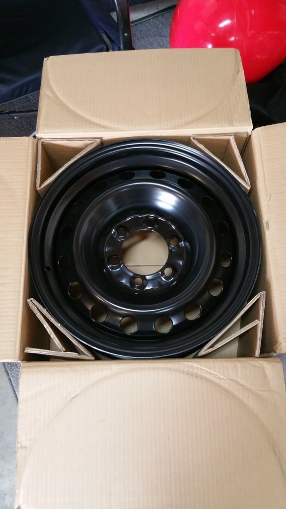

    Rims came in.. Decided to go with 17in FJ Cruiser steelies. Love the look, and the price too!
