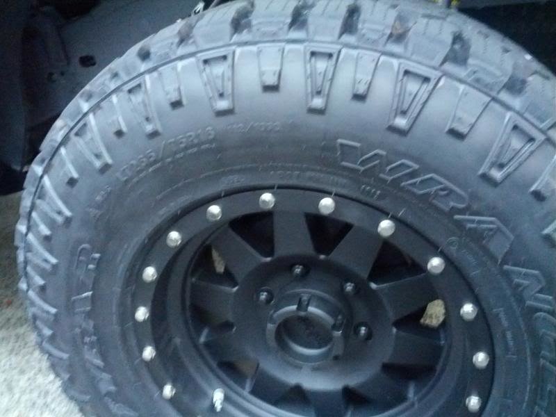

  9. Sep 13, 2013 at 8:53 PM
    gfaria1
    gfaria1 Active Member
    Sep 13, 2013
    #112420
    39
    Orlando, FL
    2016 Tacoma TRD Off-Road CC
    what rim is that?

    should be. looks like a method wheel.
