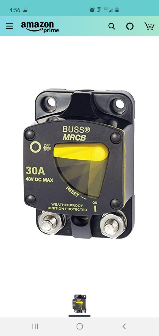

    Yes, each breaker was chosen to trip if that particular line exceeded the design capacity of that branch. I can manually trip them if I don’t want that branch turned in for testing.

    Can you post links for the breakers. Im going this same rout.
    AWSOME build, cant wait to see more.

    I just received the last of my parts yesterday, I ordered these from Amazon.

    Those are the ones. Buss makes top of the line breakers. I got mine from Amazon.

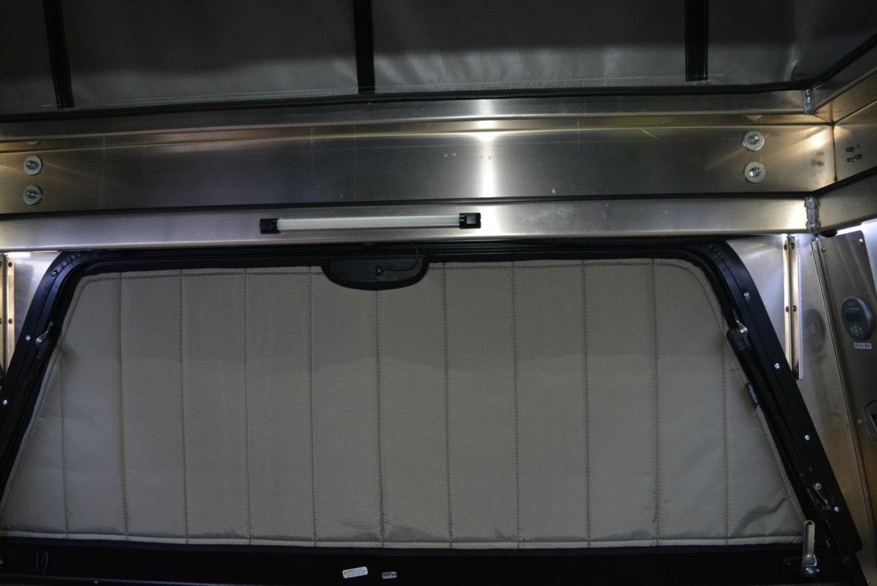

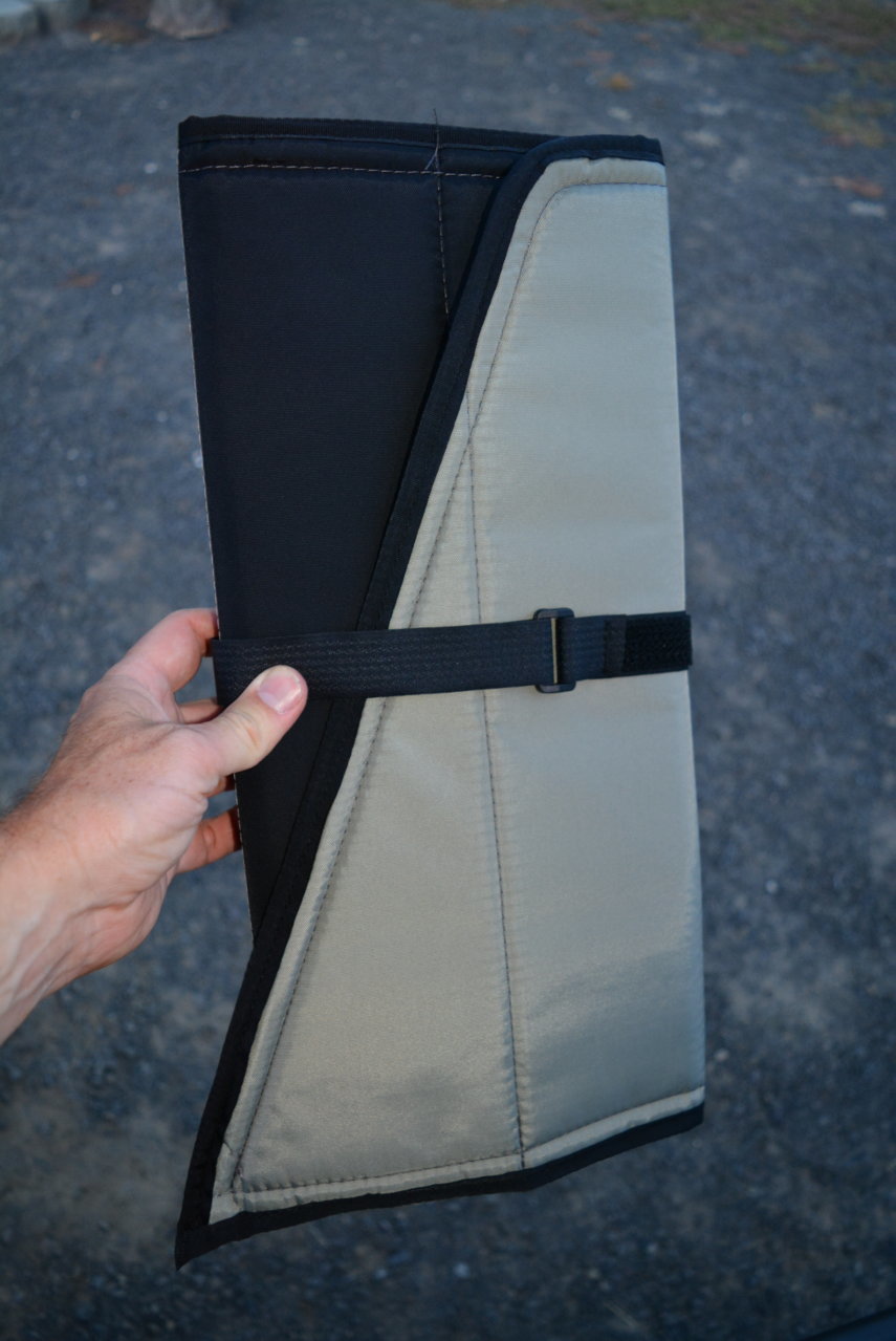

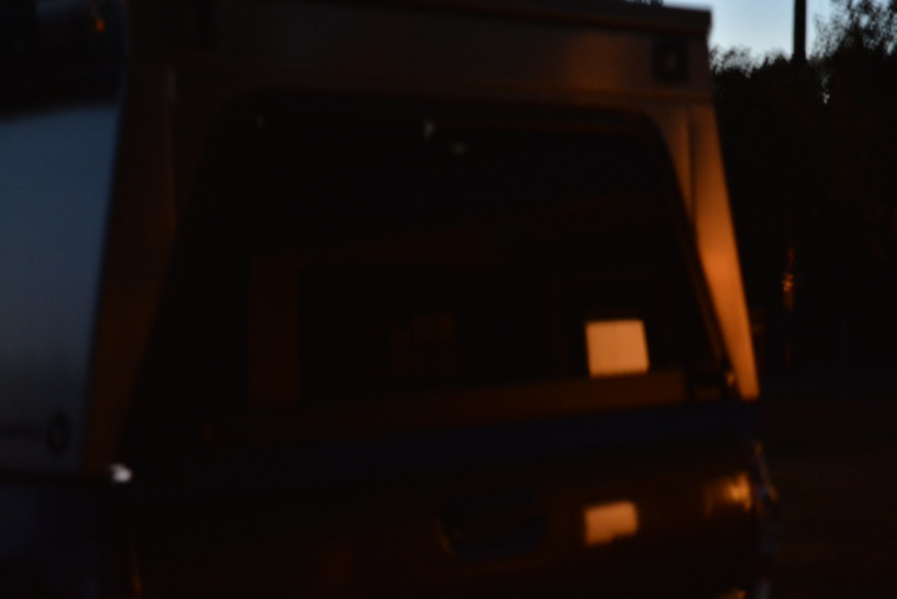

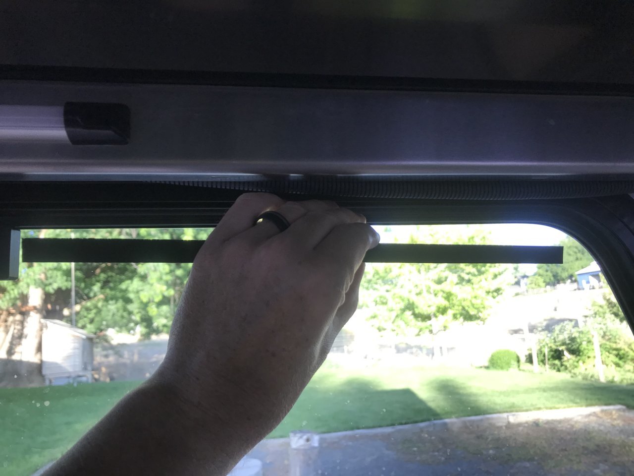

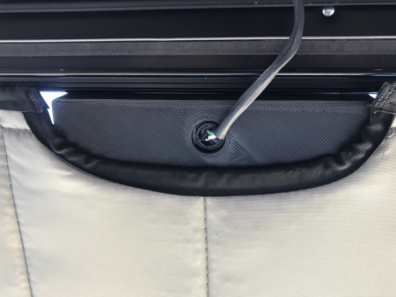

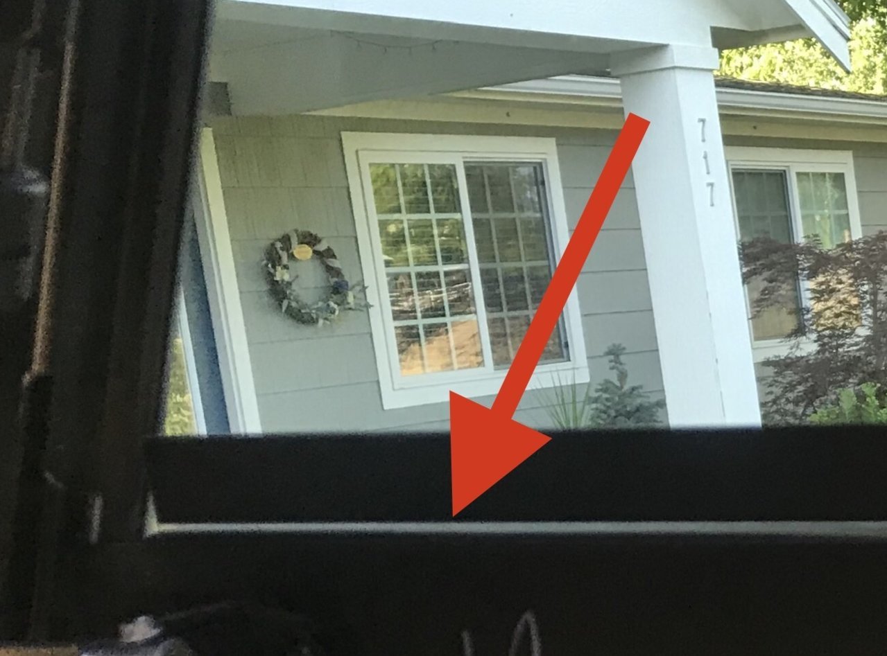

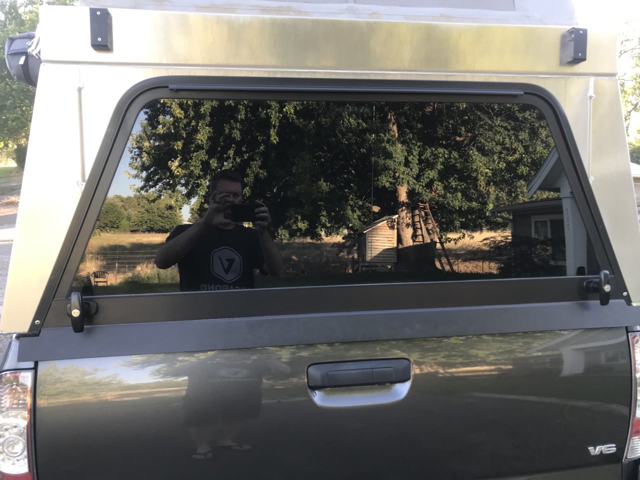

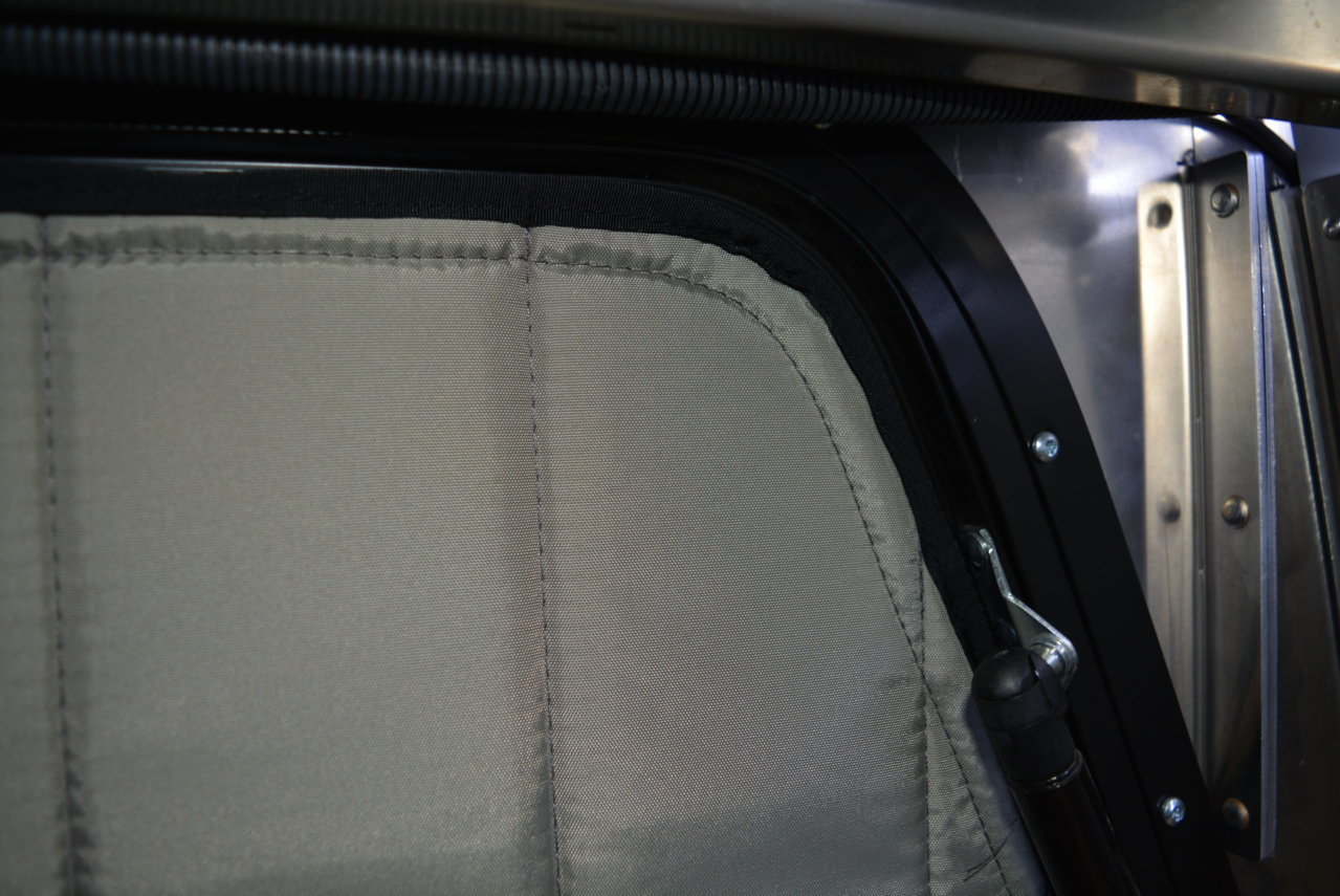

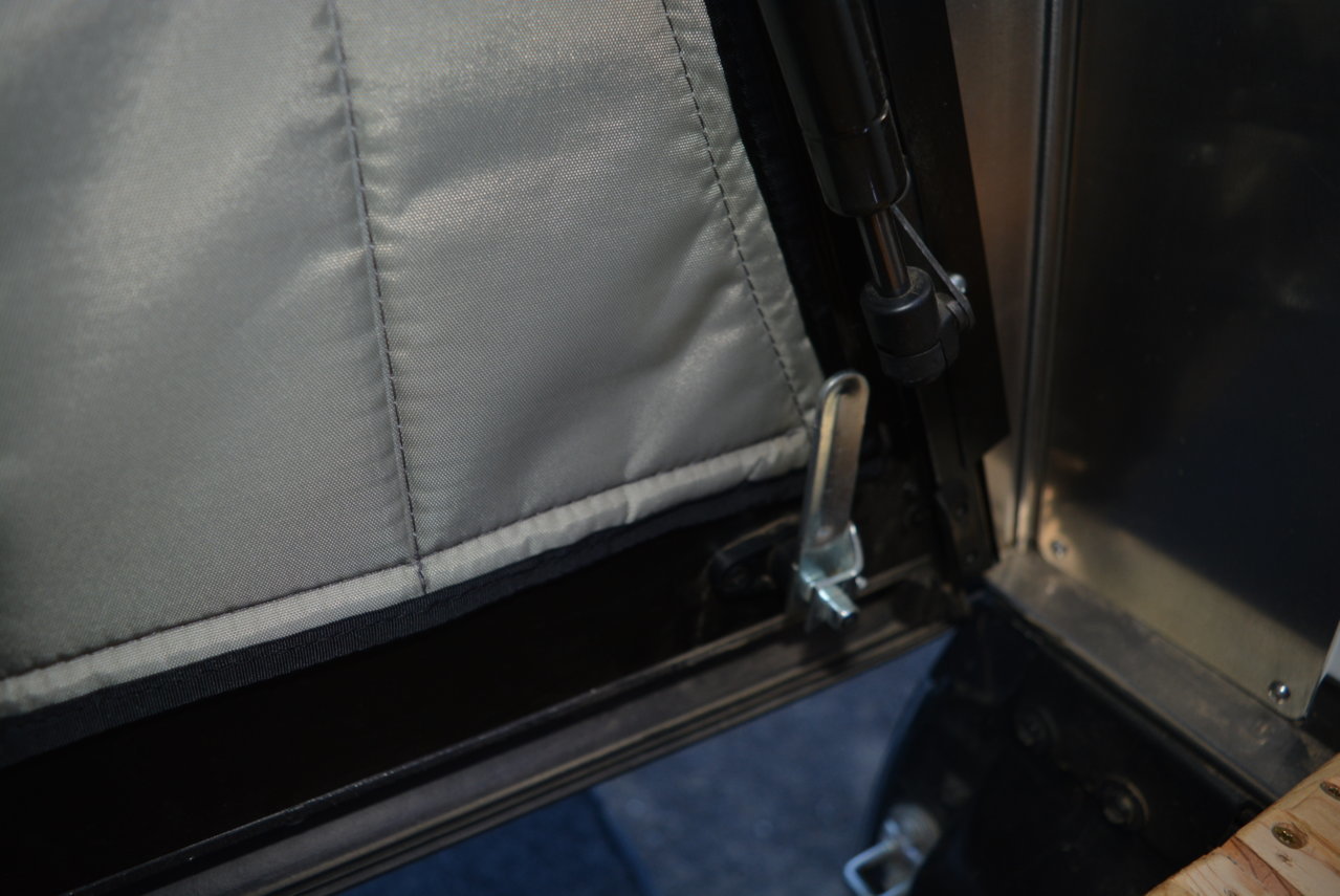

    I recently installed the Strawfoot rear window cover. We absolutely love it and I thought I would post some photos.
    We wanted a way to feel like we had some privacy when in the Drifter and Strawfoot cover seemed like the best option. I will walk through the install process and point out features I like.
    The cover uses magnets on the window and in the cover for attachment. Since the rear hatch is made of aluminum, you have to install some magnetic strips on the window itself.
    If I were installing again, I would pay more attention to sticking these down. Note the small gap between the edges of the hatch and the magnetic strip. This is a source of light leak at night that I don’t know how to resolve.

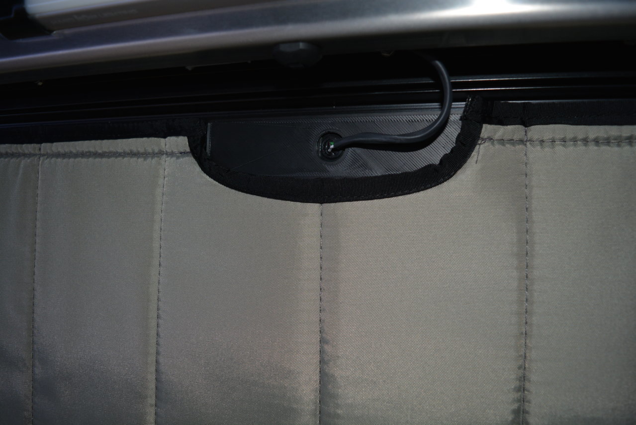

    There are big gaps at the corners. I used some black electrical tape to seal up these corners. My goal is to be able to have the light on inside the camper with the top down and stealth camp.
    I also sealed up the gaps around the third brake light.
    When the window cover is installed, the magnets in the cover stick to the magnetic strips on the glass. It sticks so well that we have driven some very rough roads and it doesn’t slide, at all. We chose a lighter color for the interior color so that it would feel too dark inside.
    Here are some closeups of the perfect fit that the cover makes in the hatch window.
    As you can see, from the outside the black side of the window cover makes it look like it is tinted.
    Of course, the proof of the pudding is the night shot. Can you tell that the light is on in this photo? You can see a little spec of light near the third brake light. The spot at the bottom left is the tailgate gap. I am planning to install a tailgate seal to eliminate this point of light leak. From a distance, you couldn’t tell any light is in inside.
    Best of all, the cover folds down into a storable size. The internal magnets cause the cover to stick to itself, making the Velcro strap redundant.
    Overall, I am very impressed with the quality and precision of the Strawfoot window cover. It is fantastic to have fellow Drifter owner @belloinsella

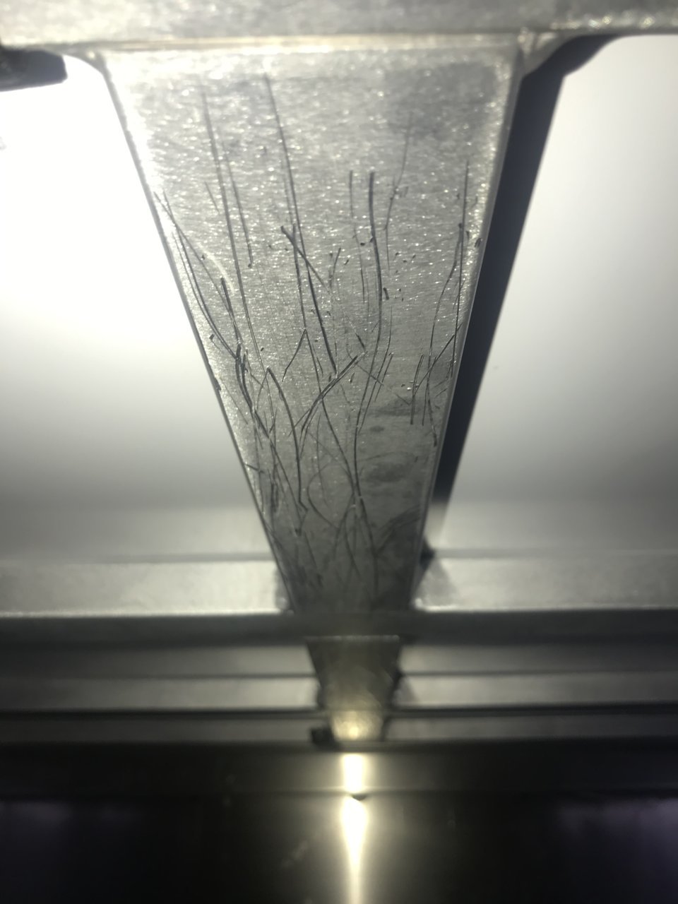

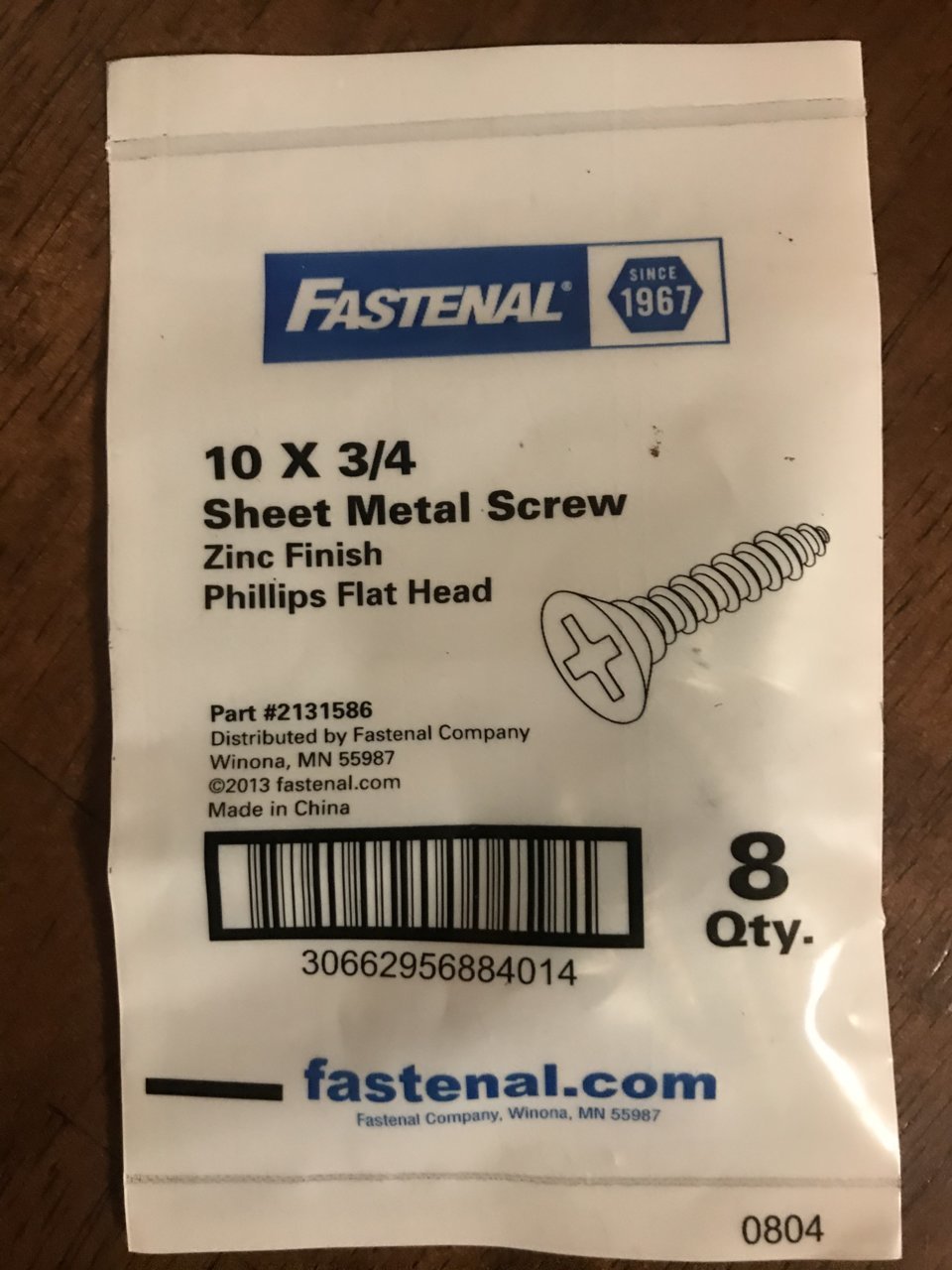

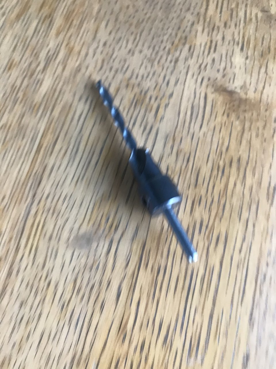

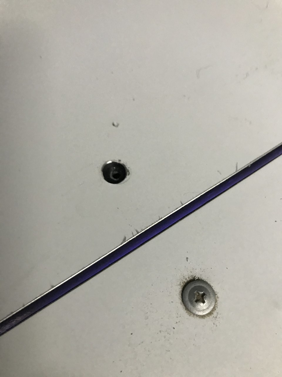

    I finally got around to countersinking the screws in the overhang. I was getting lots of scratches on the underside of the bed platform because the screw heads scrapped every time I opened the bed. I would recommend this improvement for everyone.
    I used a counter sink drill bit to allow the screw head to lower below the composite layer.
    (a little blurry, I know).
    I initially tried #8 x 3/4” sheet metal screws, as they were the same size as the original. But I found they only worked in the center screws. The majority of the screws are very close to the edge, and the drill angle caused the hole to enlarge. So I ended up using these #10 - 3/4 screws from Fastenal.
    In the end, you get a hole that allows the screw head to seat into. This has made sliding the bed panel much smoother and doesn’t scratch the supports as much. I would highly recommend.

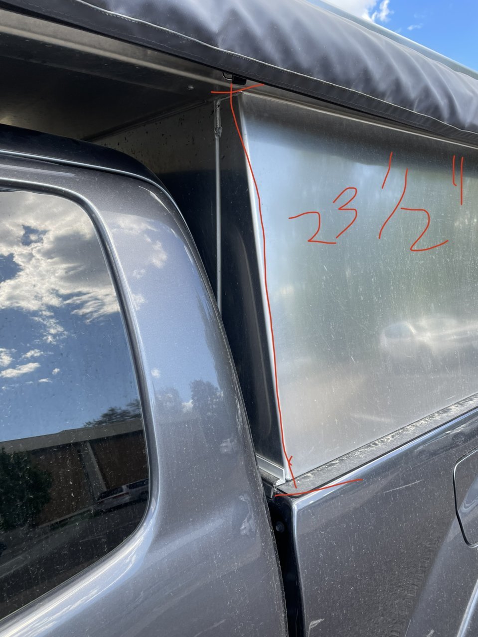

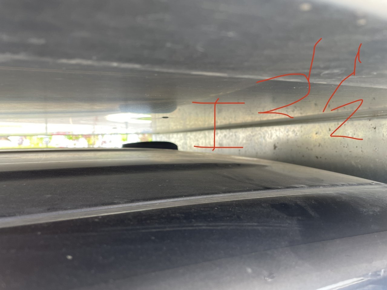

    hey @MapJunkie how much room is between the top of your antenna and the bottom of the Vagabond overhang?
    I know my setup will be slightly different because Im getting a GFC, but I just installed the KB Voodoo bed rail caps this weekend, in preparation for the GFC soon. I believe on the 09-11, there is a smaller antenna (that is not a sharkfin) thats only 3/4" tall (if Im remembering correctly). I am just trying to double confirm with myself that everything will clear.
    this is what mine looks like:
  12. Apr 27, 2021 at 11:17 AM
    #32
    MapJunkie
    MapJunkie [OP] Well-Known Member
    Apr 2, 2018
    #249153
    314
    Washington
    2015 Tacoma OffRoad w/ Drifter
    I measure 2.5” approx from root to bottom of Deifter. I replaced the antenna with the @Anderson cap, so I can’t measure from the top of the antenna for you.
    I hope that is helpful.

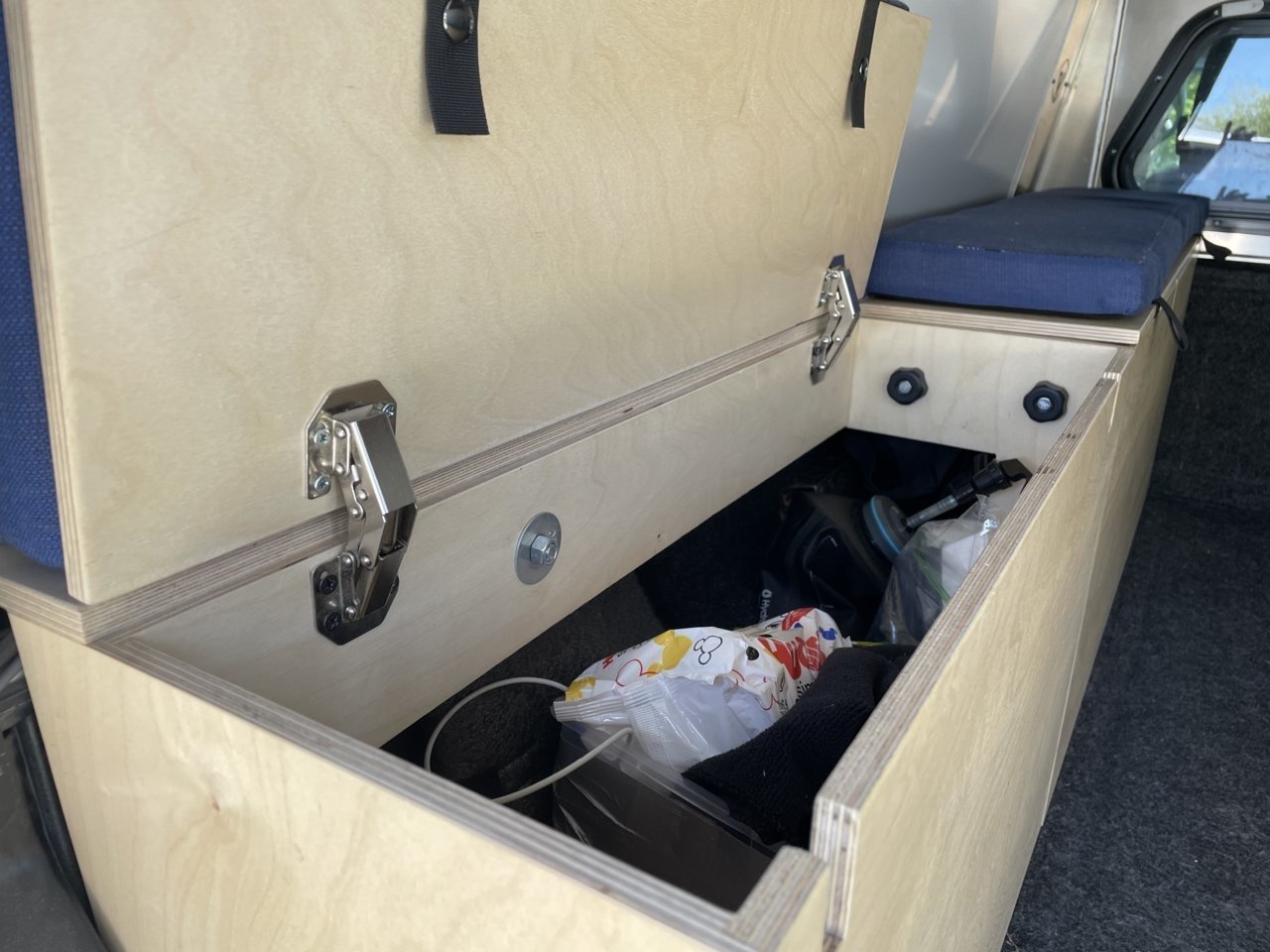

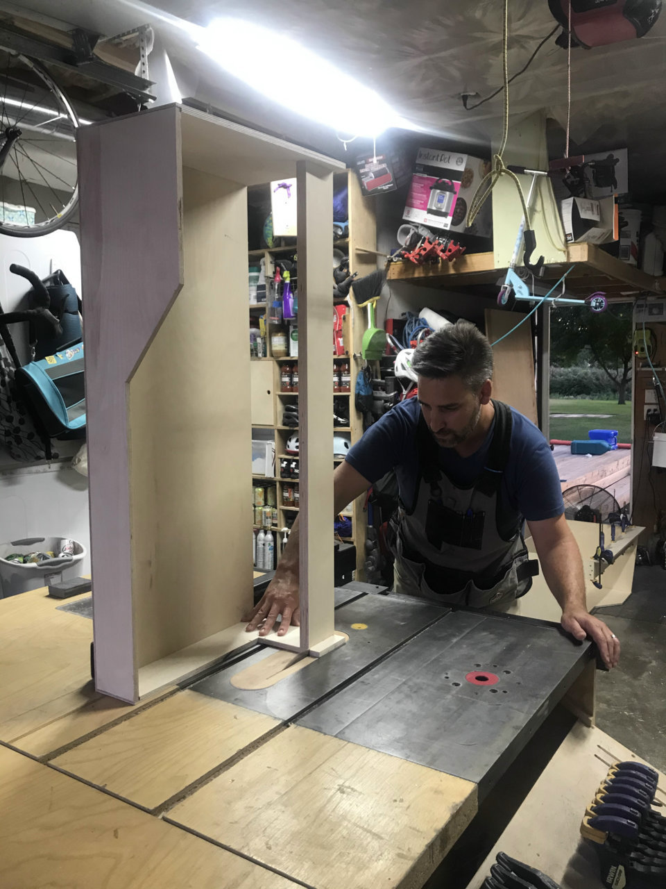

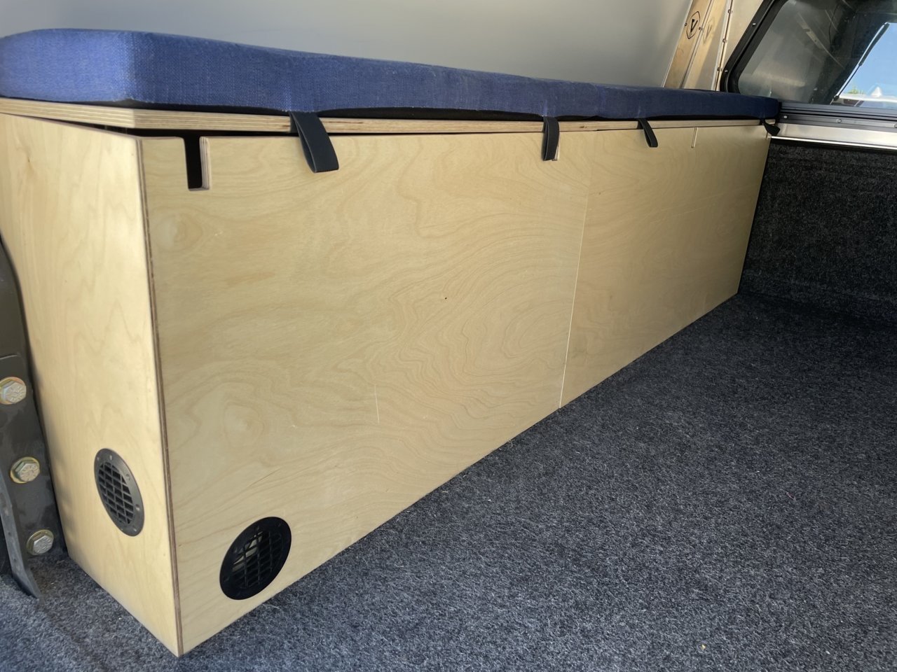

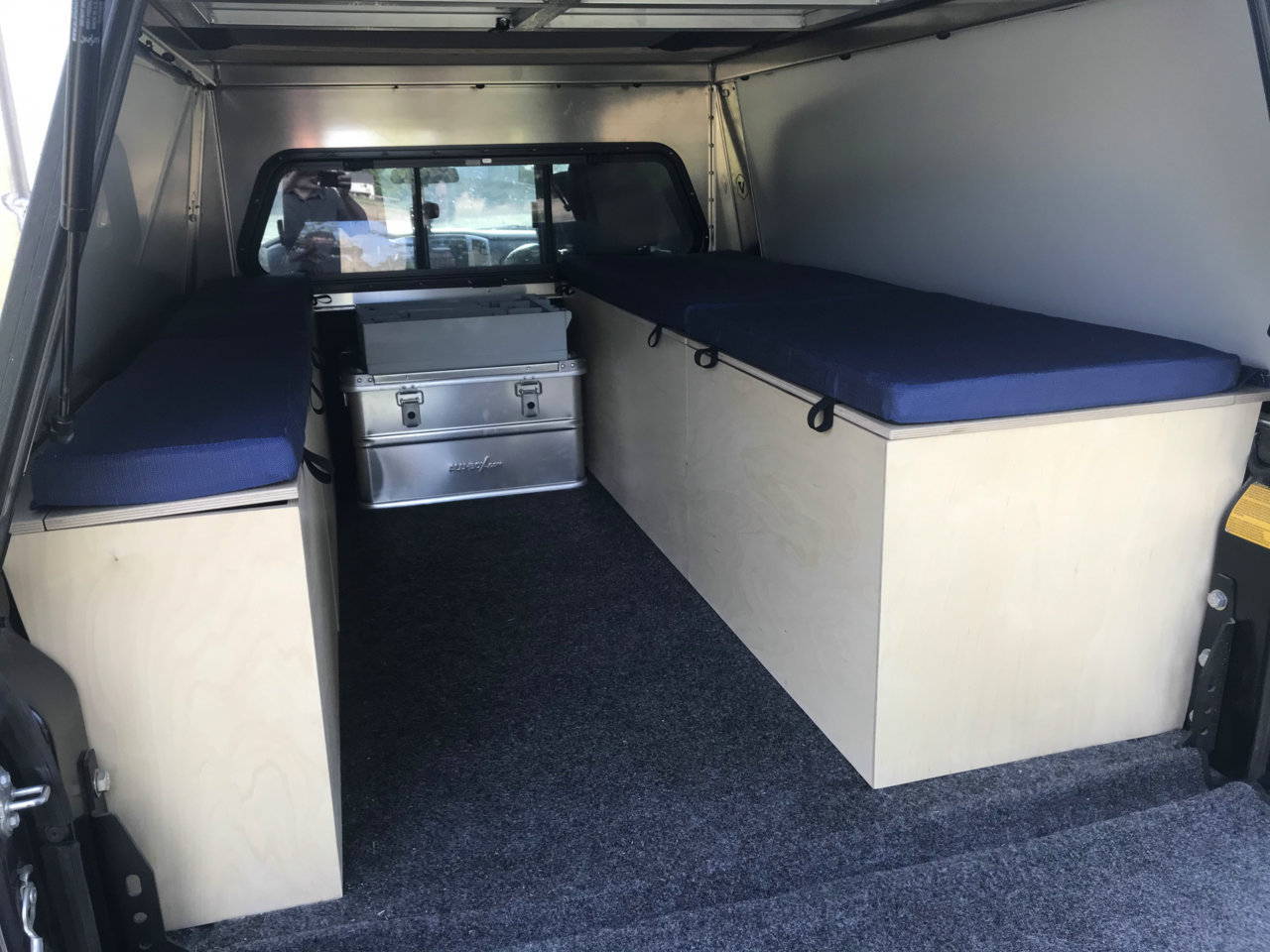

    I wanted to catch up on some building that I did last Summer. I wanted a simple build that allowed me to store all of our camping gear, while allowing a place to sit when the weather is bad. I wanted to create something that was remove-able (4 bolts to the bed-rails) so I could use the truck bed.

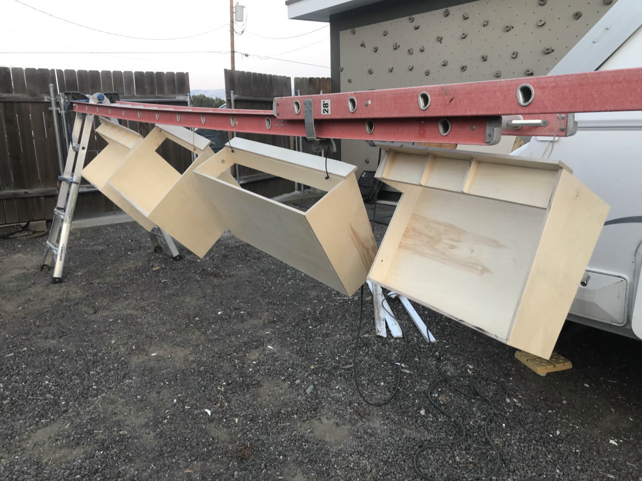

    We built everything out of 1/2" Baltic Birch. In retrospect, it would have been nice to use 3/4", because some of the lids aren't exactly flat. But the weight of the thicker wood is just too heavy. We did create a glue-laminated beam of double thickness plywood to provide extra stability where the module bolts into the bed-rails. I have a friend that is a genius with wood that helped me with all the cutting.

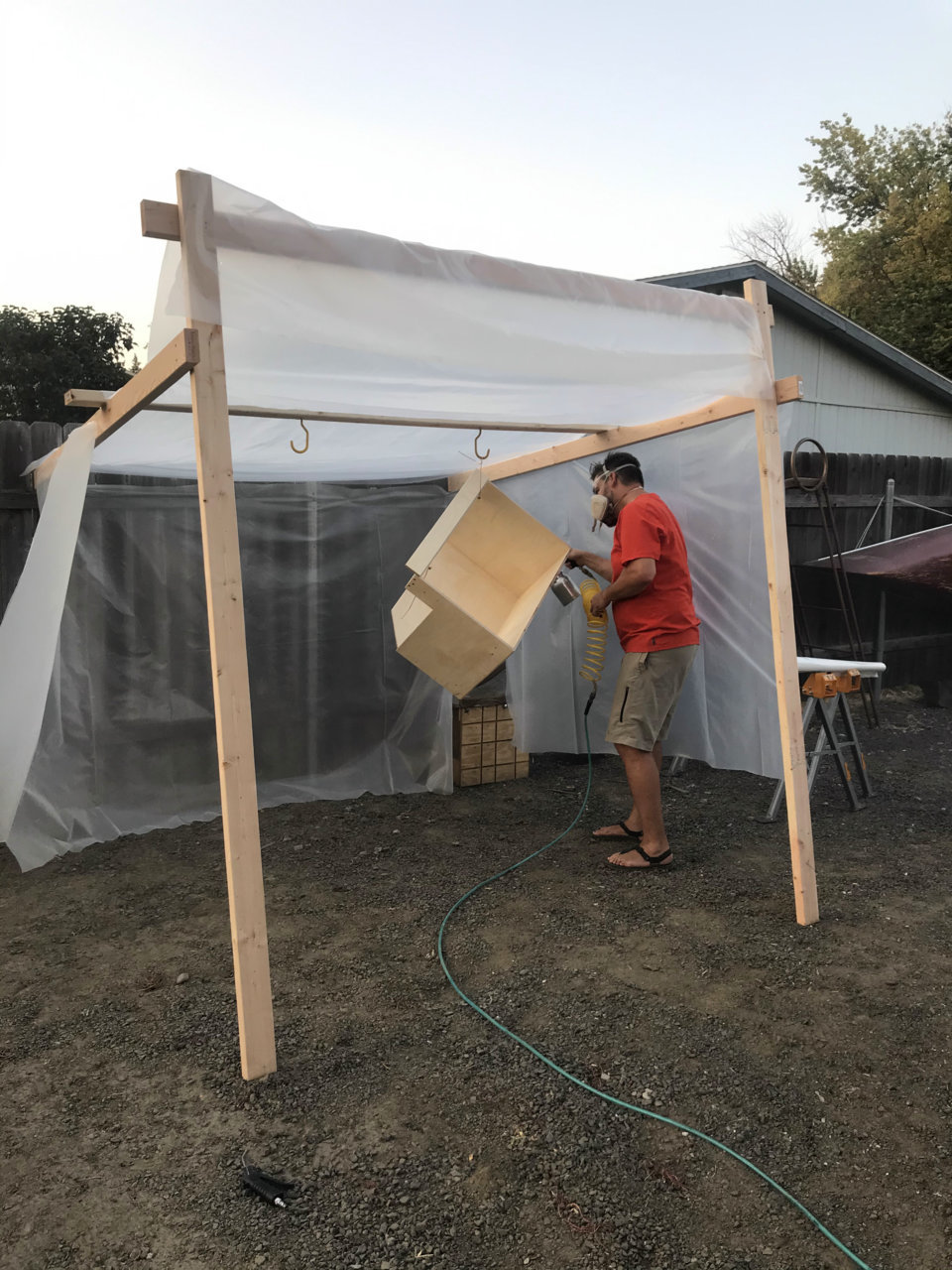

    This is how you spray wood without access to a proper paint booth. It worked OK, although I think the high temperatures
    Here is the entire line of pieces drying. Each side was designed with two separate modules to make it easier to handle for a total of four.
    The build sits on top of the BedRug when installed. We designed the lids to be just above the bolts on the camper clamps. I found a local RV upholstery guy to sew the pads on top of each bench-seat. They work great for sitting, although they were pretty expensive ($600). I will note that it is difficult to find a foam that is comfortable for sitting as well as sleeping in stealth mode. This foam is not great for sleeping, unfortunately.
    The center isle was designed to fit Alu-boxes for extra storage.

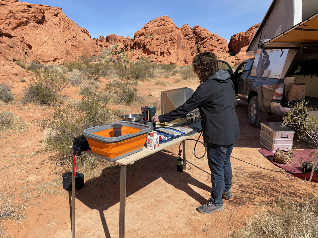

    We designed a folding table into the build that performs three functions:
    a) Outdoor table
    b) Indoor table
    c) Stealth sleeping platform
    The legs for the table bolt on when needed. These same legs can be used a supports for the table as a stealth platform. The folded table also mounts below the c-channels in the camper to use when the weather is bad.
    The table performs great as a prep table, because it is the right height with lots of square footage for cooking, prep, and cleaning.

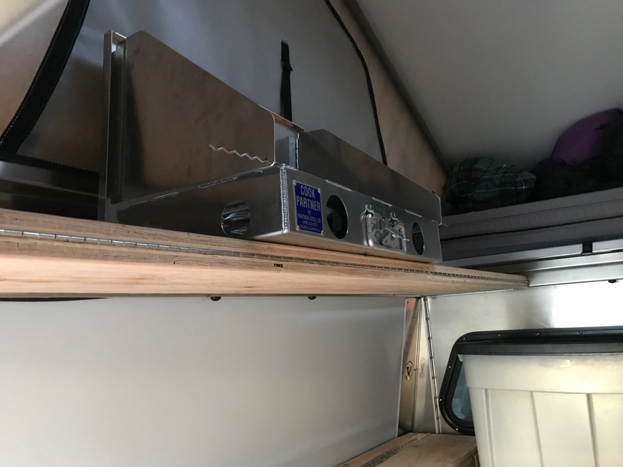

    In indoor mode, it is narrow, but will fit a Cook Partner stove, with some prep room.
    When cooking inside, make sure you open windows and run the fan! We found that Carbon Monoxide climbs rapidly when using a stove indoors unless the fan is exhausting fumes.

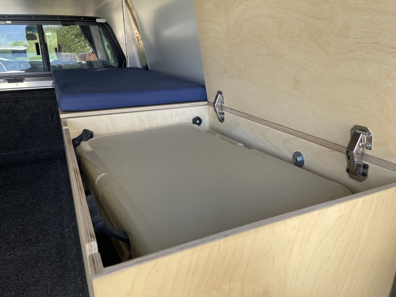

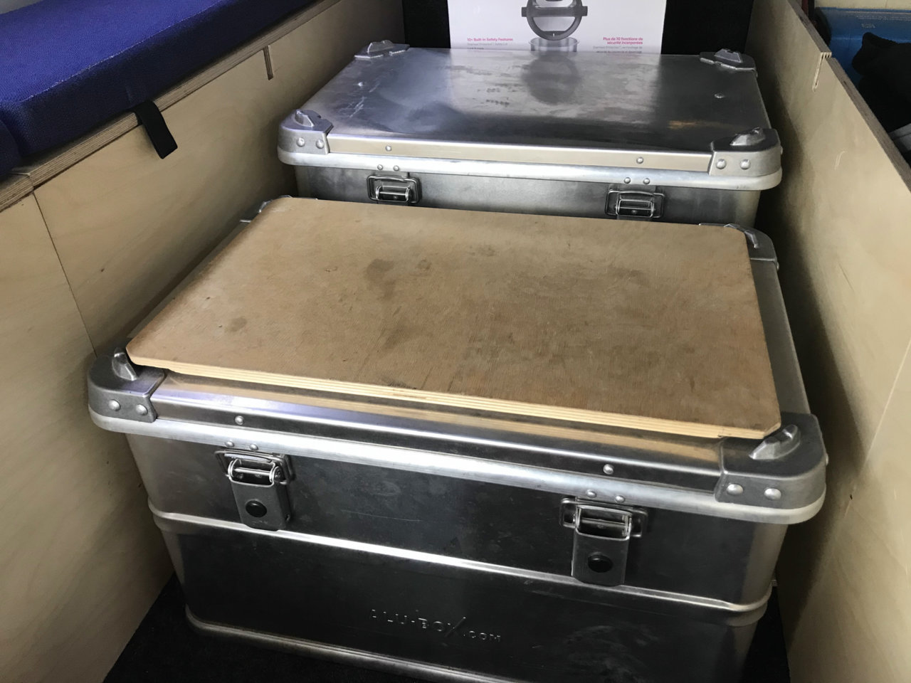

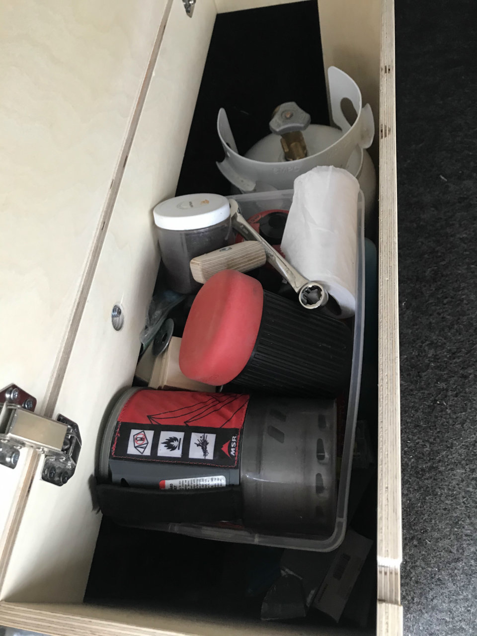

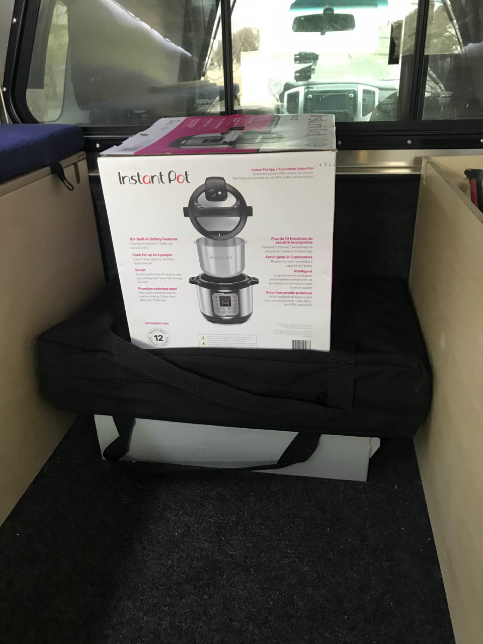

    Here is how are currently using the storage space. We store two alu-boxes in the aisle that we remove when we get to camp. The shorter Alu-box has a step-plate.
    We use the driver-rear module for storing items we need to access constantly: Water, fuel, and camping accessories.

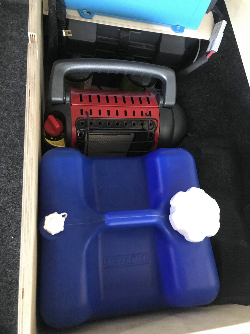

    We installed a Propex HS2211 in the fender, so the vents exit this module. More on this later.

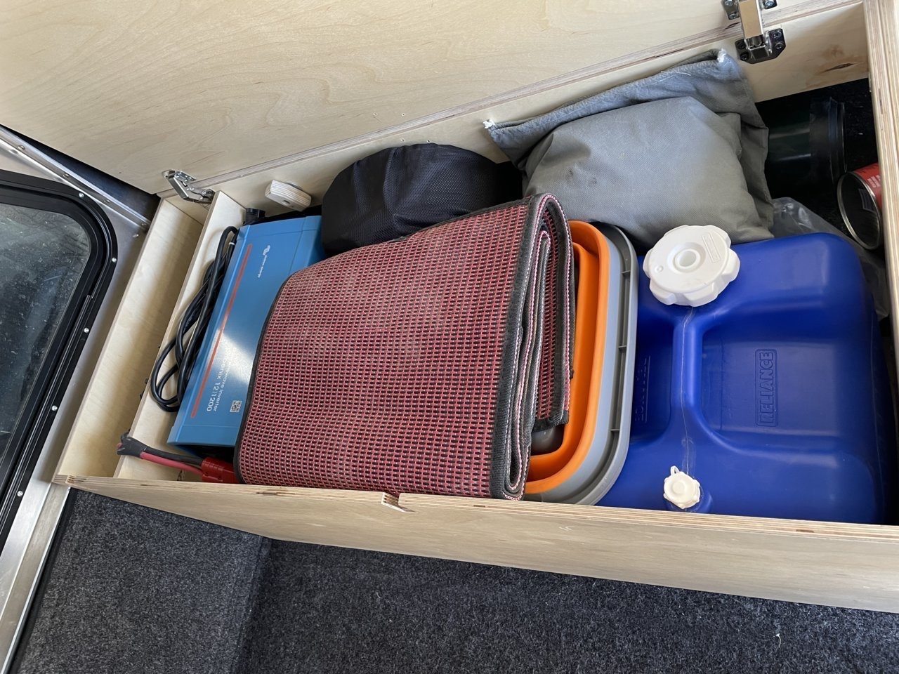

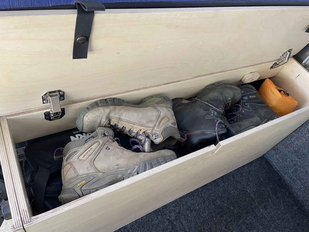

    The driver-front module stores all of our boots, longer items like hiking poles / table legs, and recovery gear.

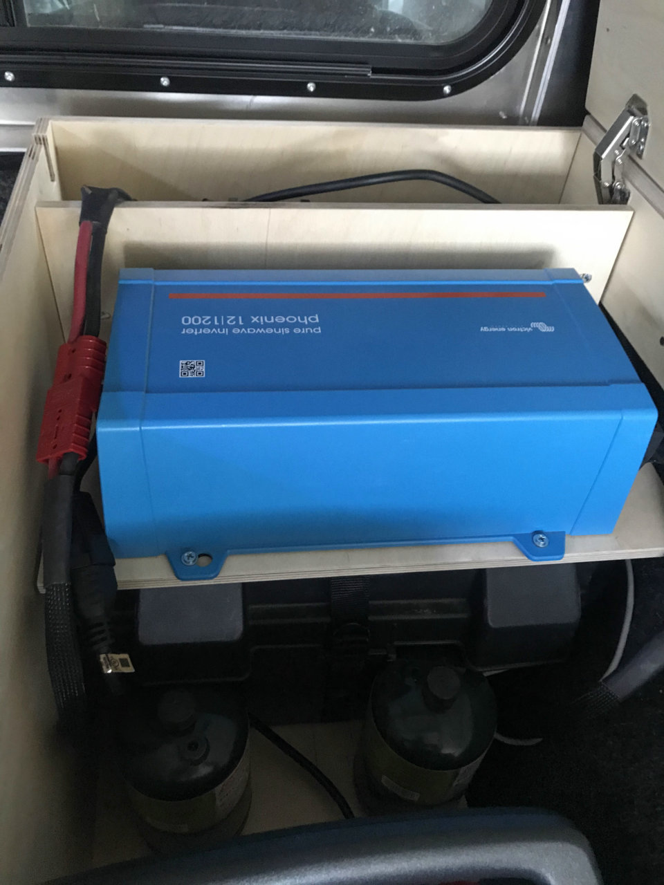

    The passenger-front module houses all the utilities such as electrics (inverter, solar charger, etc) and water. We can carry 14 gallons of water in this module using 2 Reliance water containers. I have a water pump (not shown) to pump water into a sprayer. Yes, I know electricity and water don't mix. But, there is no pressurized water in this module, as it is only drawn out of the Reliance water container. Any leaks drain quickly and the electrical components are mounted away from the floor level.
    The battery is under the blue Victron 1200VA inverter. You can see more details of my electrical build earlier in this thread.

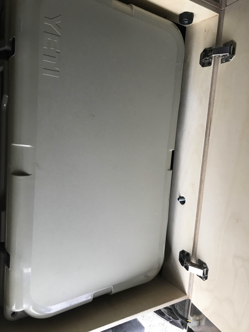

    While this build looks simple, it actually took quite a bit of time due to the joinery and attention to detail to make it look refined. There are no nail or screw holes to be seen! Our goal was to build a space that felt homy and less like a garage. Since we use our Drifter in all four seasons, it was important to have a useable space during the cold-winter months, when we used to stay home. We have found that with a heater, we can go out in the coldest weather that Eastern Washington throws us.
    I want to thank everyone in the VO community for posting ideas and being willing to discuss solutions to issues that we have run into. We couldn't have done it without all of you!
