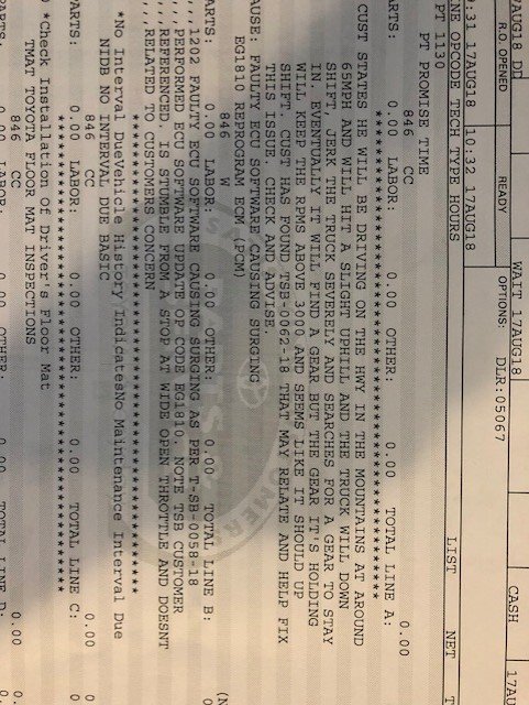

    TSB.jpg Went to Mountain States Toyota in Denver, CO today. They flashed TSB 0058-18 and said 0062-18 wont apply because its only for WOT issues which I do not have. I am not sure why they dont flash it anyway, but I will report back once I drive around some more with TSB 0058-18. I hope it is an improvement.
    Funny how another dealership told my there "were no updates, my truck has them all" about 2 weeks ago...

    Every stealership has different people working. My service guy was really cool and the place I go is friendly. Tell them "I bought my XX,XXX dollar truck here and expect you guys to service it at my request. This is covered by Toyota warranty and I want it done regardless of your opinion."
    Be firm with these assholes, you are the customer and every stealership should go by the motto "the customer is always right".

    Yeah, when I go in for 5000mile service next time, I will be more firm with 0062-18. I only have 1200 miles on the truck, so they said the ECU is still "learning" which could have an affect on the transmission. Once I hit 5000 miles, they cant use that excuse anymore.

    That's a garbage excuse anyways. The ECU is constantly monitoring hundreds of inputs and adapting many transmission and engine variables. The ECU never stops this process. Its not as if the ECU will "learn" for a set period of time and then stop, it will continue for the life of the vehicle.
