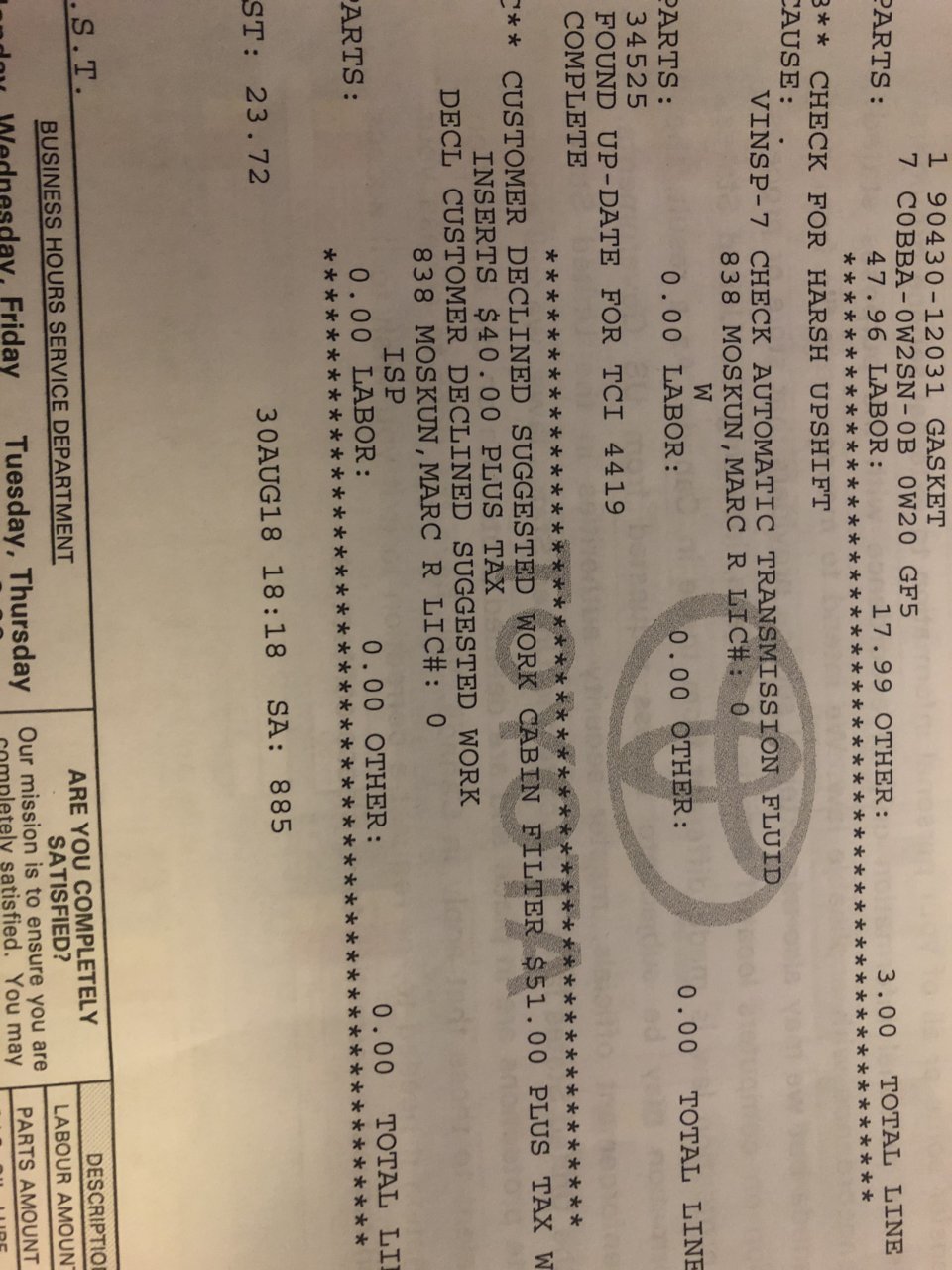

    I recently purchased my Tacoma TRD Sport 4x4 double cab built June '18. It is definitely doing the erratic shifting and the hesitation when pressing the gas from a stop. I just called the Toyota dealership and told them I'd like to get the T-SB-0058-18 update. They put me on hold, came back after 5 mins and said, "I'm sorry sir, we ran your VIN through our computer and your vehicle doesn't show any available updates."
    I told them about the transmission issue and they said I could bring it in but there aren't any updates.
    Is this a possibility? Thanks for any help with this.
  20. Sep 18, 2018 at 11:48 AM
    #480
    Bulldogs129
    Bulldogs129 Don't find fault, find a remedy
    Sep 8, 2016
    #196750
    1,316
    Malcolm
    Mississippi
    2018 TRD, OR, 4wd, Dblcab, 3.5l, & 2002 Tacoma 4wd, SR5, TRD, 3.4L, auto
    Well the dealerships are careful how they word things. These trucks actually drive as Toyota designed them. So technically speaking, there isn't a problem. However, we owners do not like how the truck prematurely shifts, lunges from P to Drive, and loses power due to early shifts (Honda CRV's have an "eco" mode designed to save gas and putt-putt along). Bottom line is you aren't asking will they do the TSB, you are unsatisfied and prefer YOUR truck shift normally. I promise you my truck felt like it shifted from 1-3-6 gears, trying to keep the rpms at 1,000-1,100 all the time. But now, it shifts normally. Take a copy of the TSB to the dealership. They know about this issue, it seems like they are trained to resist.
    You need to check your VIN/VDS# against the TSB attached.
    Good luck
