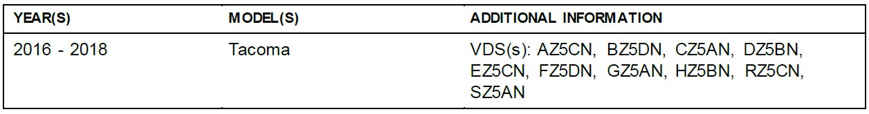

    Yes, here are the VINs that are covered by 0062-18.
    dangeroso likes this.

    Well great. Mine's not on the list, but I have the same symptoms that others are having.

    Thanks for posting those vins again. I am included.

    No, those ones he posted are not the first 5 of the vin. They are a few numbers/letters in the vin. Just an FYI so people aren’t confused.

    So how does one verify if your VIN is included?

    So to make it even more simple if those combinations of letters are within you bin Toyota thinks you should get the update

    Look at your entire VIN number. If you are covered by this T-SB, one of those five digit number/letter combinations will appear in your VIN in order. For example my VIN is xxxCZ5ANxxxxxxxxx and is covered.
    trazerr and dangeroso[QUOTED] like this.

    Ha! Mine is CZ5AN as well. I called them back and they changed their story to “must be able to duplicate”. Time for a new dealership.
