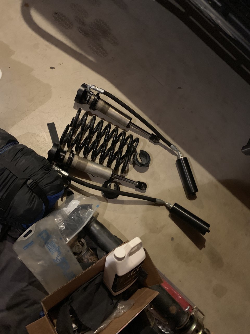

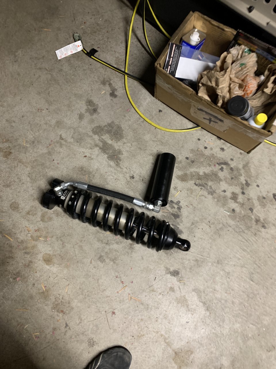

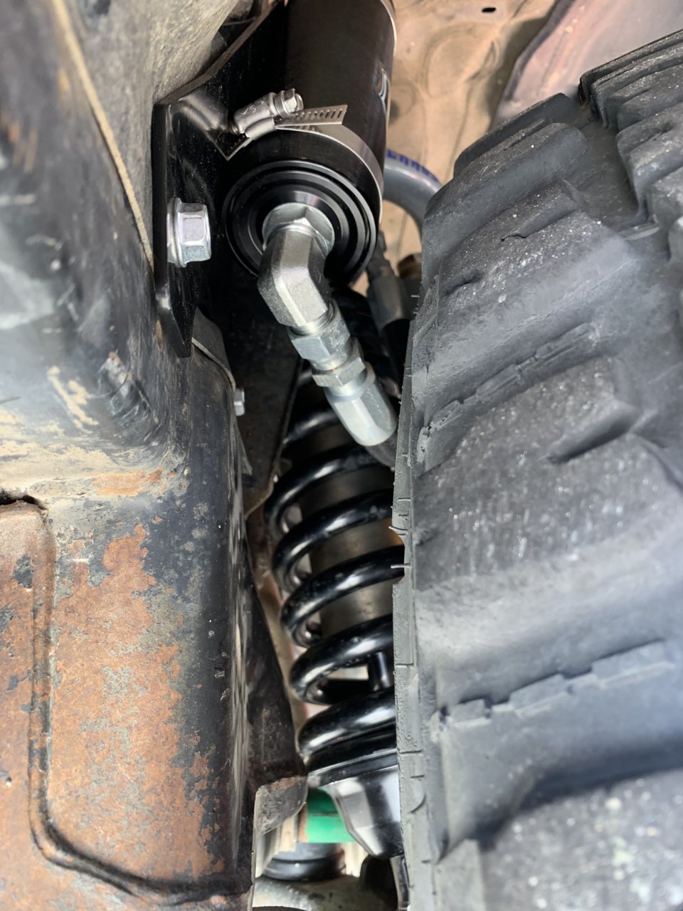

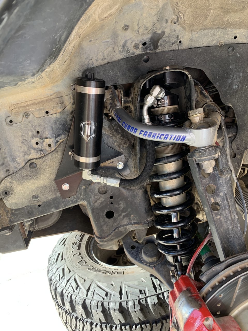

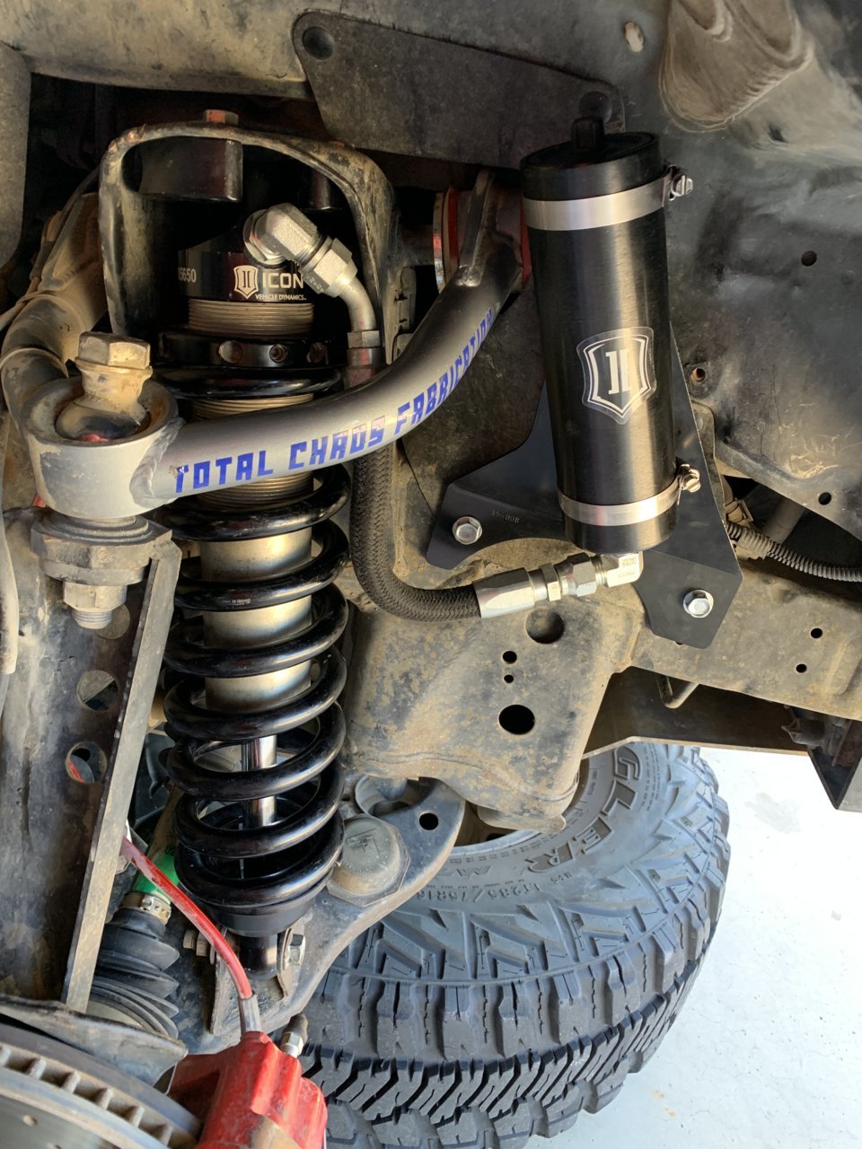

    So a little update...ran into a bit of a hiccup after adding resis, the hoses were african american length, vs the asian length my first gens tiny wheel wells could handle. So i was left with the dilemma of removing the goddam coils again. Its not cheap and with a few friends needing rebuilds we went in on a coil compressor
    This thing works like a charm and with 700# coils I put it to the test. It was a but scary, but after the first one came off without a problem, second one was off
    You can see the elephant hoses are way too long, but whatever its a quick fix and we will get it right the second go round.
    Unfortunately I hit another hiccup and had a set screw strip so I could only get one done last night.

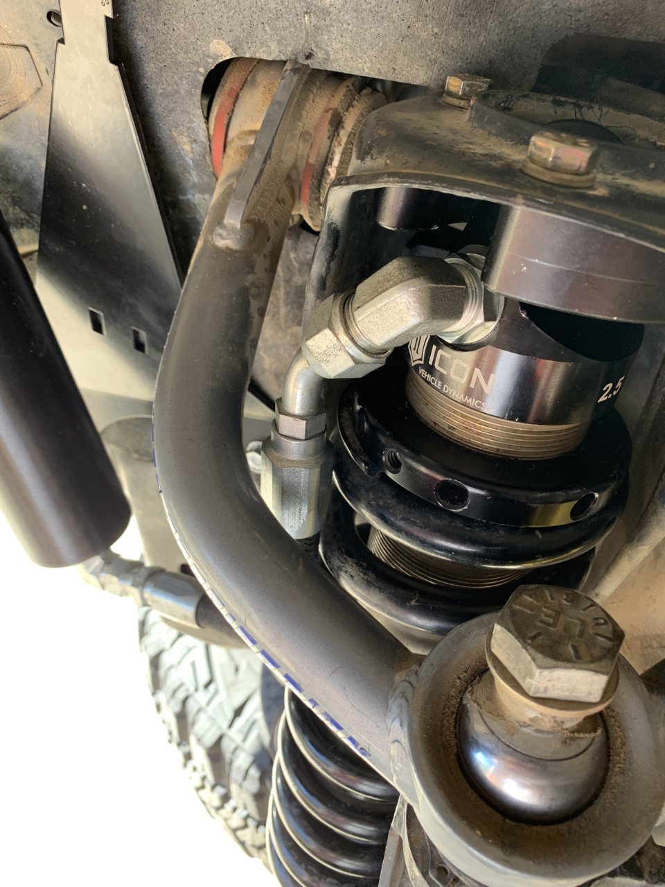

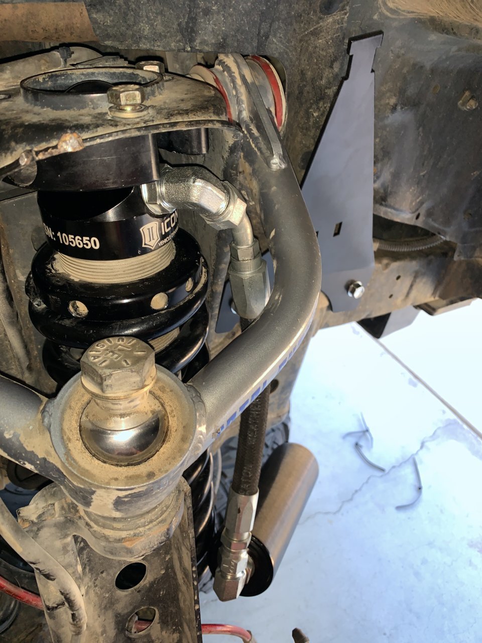

    So it should get all put back together tomorrow. But at least I got one back on and test fit. Just need a minor adjustment with the 45° hose fitting, but placement is way better. Brackets came from Icon. I had tried to get intouch with MCM Fab for weeks but looks like Icon has the same bracket

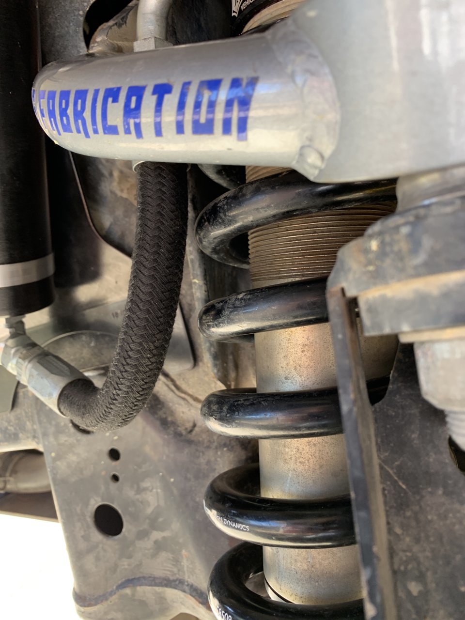

    Do you rub that resi at all?

    I dont think I will with that location, but Ill find out in the next couple days. With the longer hoses it was gonna rub for sure, probably on a speed bump. Ill give an update when I get em both back on and give it a good test run.

    Lets see how theywork, but that location Seems to be where people get the best results

    Your hose is entirely too long for this location.

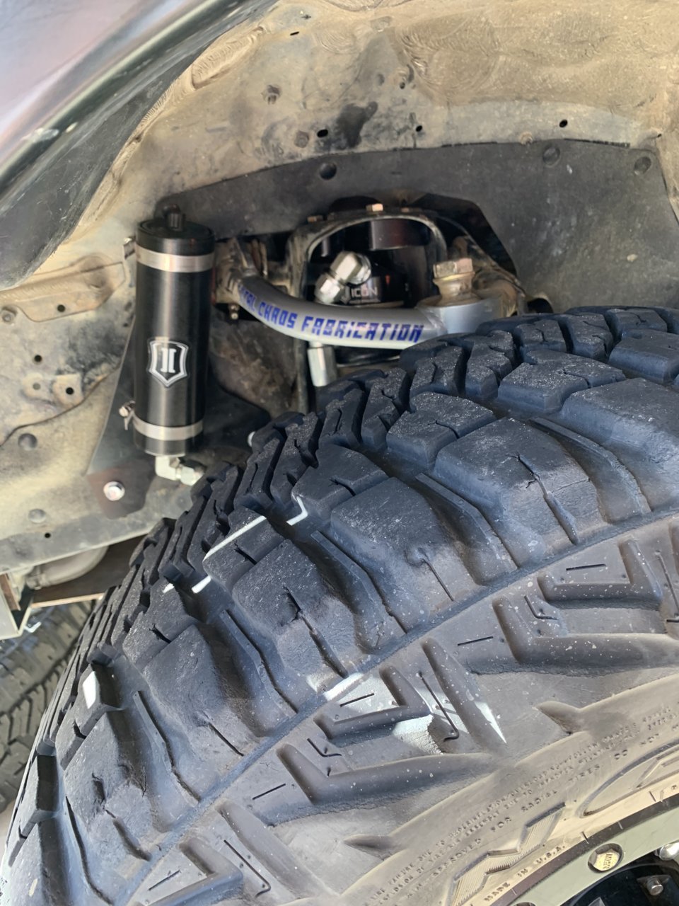

    So got the DS suspension on today and the truck is off the jack stands again! Everything looks pretty good to me.
    Its hard to get a good angle with the phone cam, so you'll have to trust me that Ive got plenty of room. Maybe at full lock and full stuff I will rub the resi. I don't find myself doing that too often, probably just jinxed myself. Maybe if I threw some spacers on there it would give me more room...but Im not too concerned. For now Im stoked and will get a good run at it to see for sure.

    I use this mount because I rubbed the reservoirs really bad in the stock location. I haven’t had any issues.

    Those bolts they send didn’t work for me at all. I ended up tapping the original holes the next size up and using a hex bolt to keep them on.

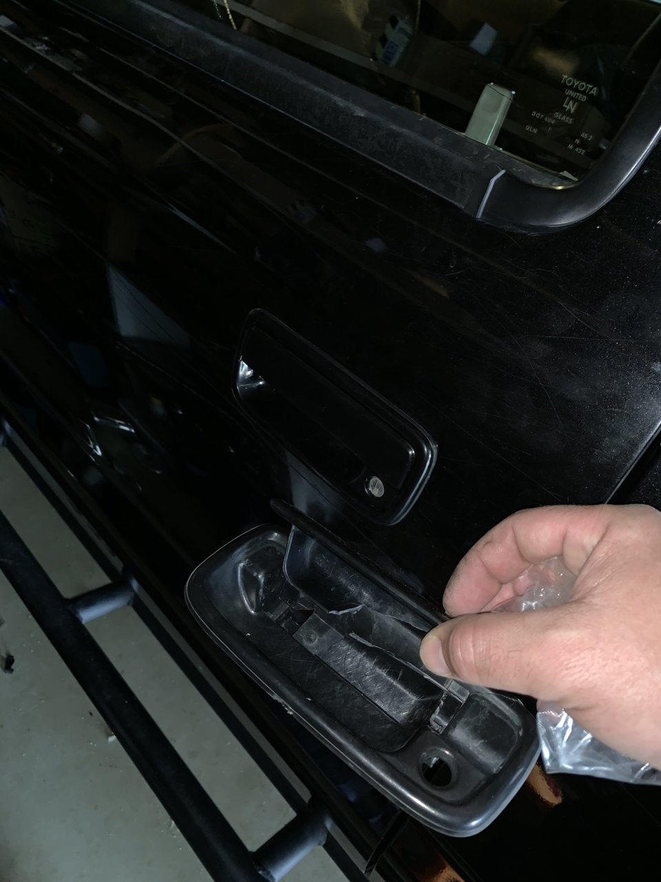

    A little update as well, I do rub on the resis slightly, and I think its as a result of my wheel BS...but I dont really give a fuck hahah. Its not bad, and only when im in the rocks at slow speeds. Eventually I will get some spacers, and I am sure that will fix it.
    Side note, I replaced my door handle today, old one broke. Thanks for the door handle rec @eon_blue that thing works like a charm. F6D0448C-5B08-4BA3-BEA1-590C2728F808.jpg
