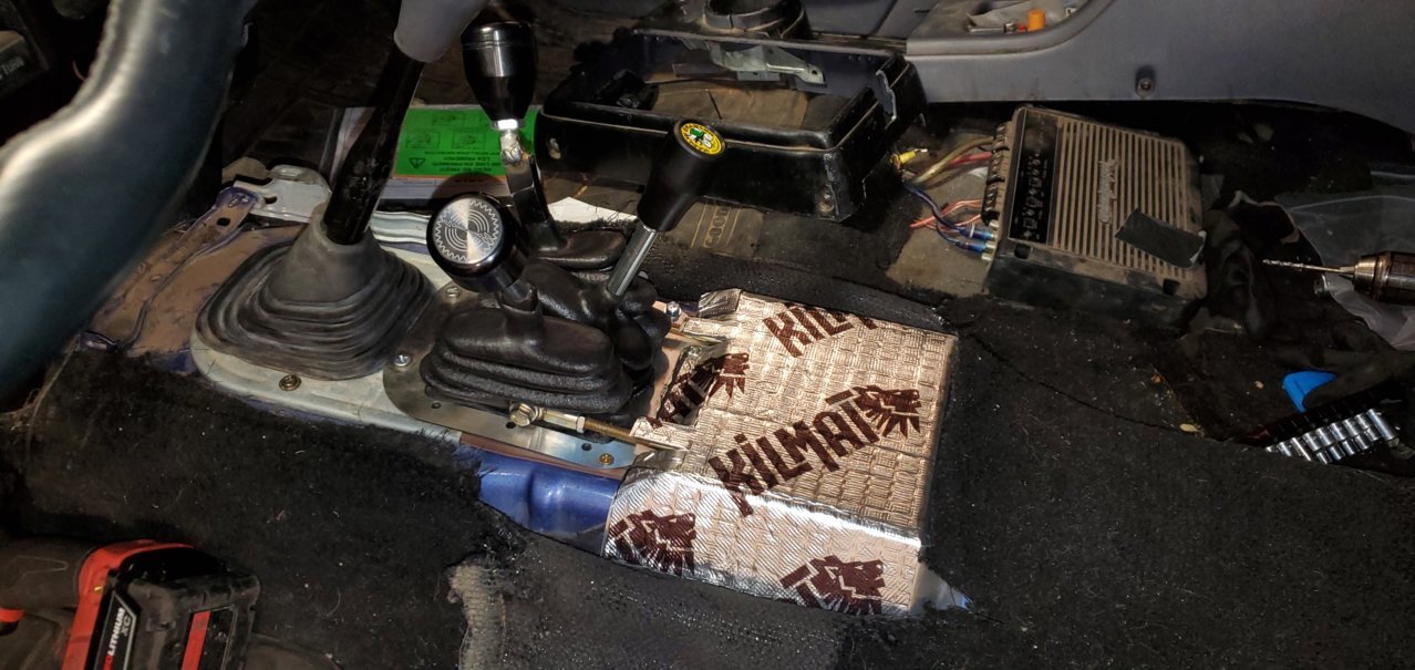

    I Checked out your build man. Im gonna have to copy some shit you did. Do you have pics of the plate you riveted to cover up the hole in the floor?

    Thanks. Happy to answer any questions you have.
    I don't have one of it off the truck, but here's one. I think like 20 gauge stainless steel sheet is what I used for it. Adhesive window sealing stuff between the body and the plate to create a seal. Then covered it with leftover 50mil sound deadening I had (top and bottom). That helped make it much more solid
    Without a body lift, it was kind of a pita to get the triple stick linkage covered up. There's still two small holes open to the ground below that the rods enter the cab through.
    Maybe somewhere down the road I'll get super custom with it and make a better panel to properly seal it completely up, but for now it works for me. It's a wheeling rig after all though....

  7. Nov 24, 2020 at 5:57 AM
    #587
    slander
    slander Honorary Crawl Boi
    May 10, 2013
    #103909
    8,964
    Hickory, NC
    02 Tacoma, fixed with curse words.
    I did something similar on mine, my advice is to make it removable as being able to access the top of the cases is nice if you have to adjust the linkages or inspect something. I found some plastic nutserts at the hardware store that I should have used, instead I used sheet metal screws and seal it with foil tape. It works but it's kind of redneck. If I did it all over again I would get fancy and weld some nuts to the trans tunnel and use bolts and a gasket. You will need to seal everything up really good, if you drive with the windows open on the highway it will suck air from the trans tunnel up into the cab and your cases will got hot as hell. No joke if I roll the windows back up and turn the AC on I can feel the shifter and floor get cooler as I drive. When I first built my cases I kind of blew this advice off and regret it.

  8. Nov 24, 2020 at 10:52 AM
    #588
    betterbuckleup
    betterbuckleup Well-Known Member
    Jun 26, 2017
    #222483
    4,801
    Ian
    Concord, CA
    2000 Tacoma SC 2.7 4x4 5spd
    Yea I took notes from your build & others on being able to access the top of both cases. Made the rest of the install much easier once I had both cases in.
    On the highway my cases stay cool, they get the most hot in stop and go traffic or around town.
    Don't you also have the lefty which is gear driven?
    I believe gear cases run hotter than chain driven ones which probably plays a role with heat in your setup too.
  9. Nov 24, 2020 at 2:05 PM
    #589
    slander
    May 10, 2013
    #103909
    8,964
    Hickory, NC
    I do, it got hot pre lefty. It's an airflow issue on mine, I made a bunch of mistakes in that area along with the shifters and stuff. It runs cool with the windows up, once you open them on the highway it heats up and you can smell the gear lube and feel the air leaks.

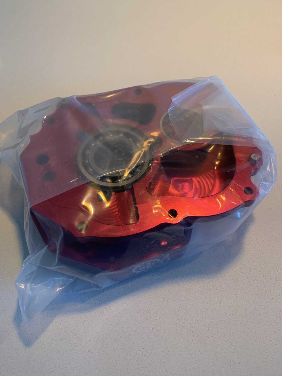

  10. Nov 25, 2020 at 5:00 PM
    #590
    Prayn4surf
    Prayn4surf [OP] 20 minutes late
    Jan 6, 2017
    #206776
    6,016
    Socal
    2004 Tacoma xtra cab
  11. Nov 25, 2020 at 5:12 PM
    #591
    eccracer104
    eccracer104 O.G. Member
    Apr 9, 2008
    #5854
    14,169
    San Diego, CA
    2016 Tundra 4x4
    Oooooh damn that's a pretty taco box :drool:
  12. Nov 25, 2020 at 7:29 PM
    #592
    betterbuckleup
    Jun 26, 2017
    #222483
    4,801
    Ian
    Concord, CA
    Gotta love that red anodized aluminum. Hawt

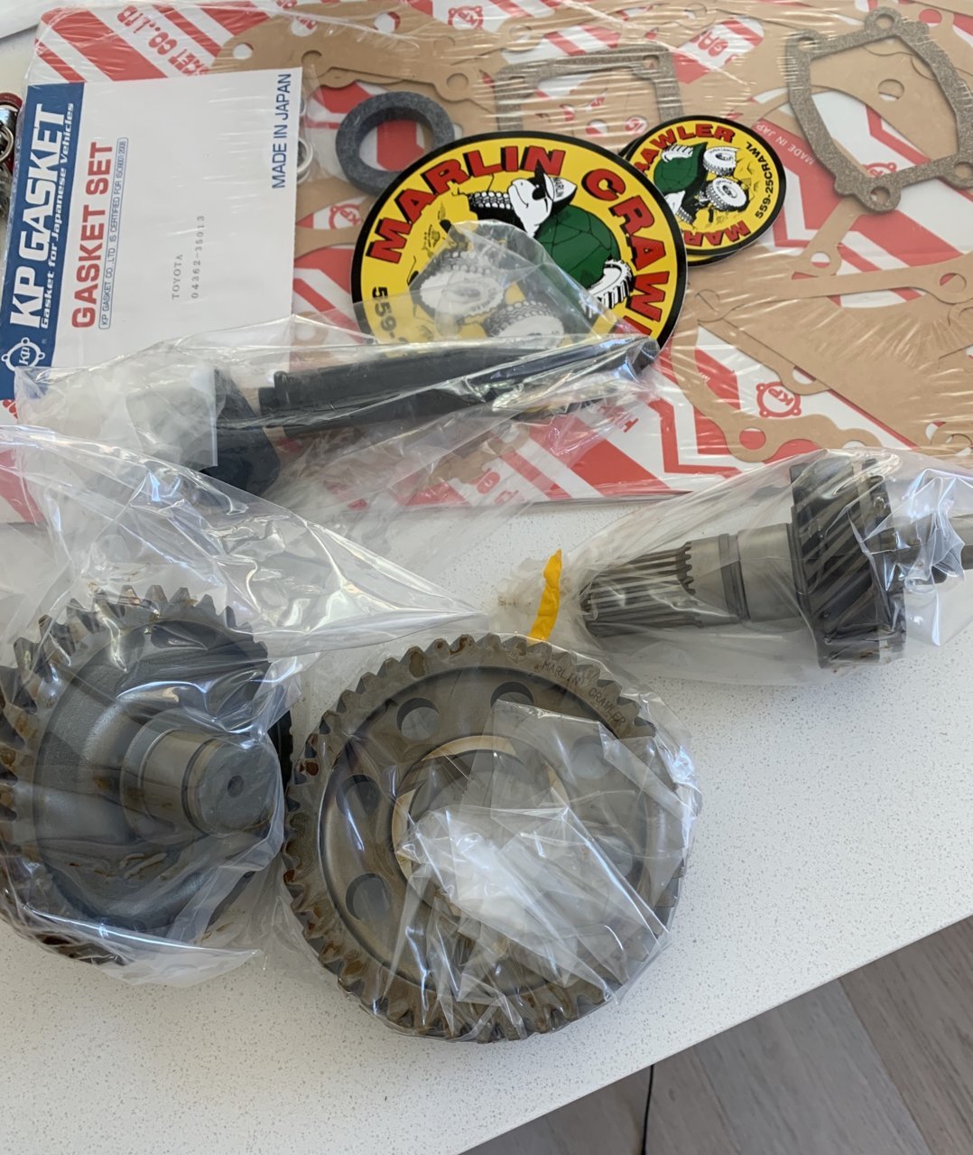

  15. Nov 27, 2020 at 7:40 AM
    #595
    Prayn4surf
    Jan 6, 2017
    #206776
    6,016
    Socal
  16. Nov 27, 2020 at 12:43 PM
    #596
    betterbuckleup
    Jun 26, 2017
    #222483
    4,801
    Ian
    Concord, CA
    The ultra black is designed for oil resistance. For like an oil pan, etc.
    The ultra grey is designed for torque load resistance.
    I used the ultra grey and haven't had any leaks so far. Again, one of those things that some people have had luck with and others haven't.
    I made sure to follow the instructions to a T and let the rtv setup with all the hardware only hand tight for an hour before torquing it to spec.
    I mainly used it because it was what I had on hand.
    I do really like that you can get "the right stuff" in a power can like that though. My fingers were so beat after squeezing that tube for so long to seal up every surface.

  18. Nov 28, 2020 at 8:49 AM
    #598
    Prayn4surf
    Jan 6, 2017
    #206776
    6,016
    Socal
    :fistbump:
    Thanks Dillon.
