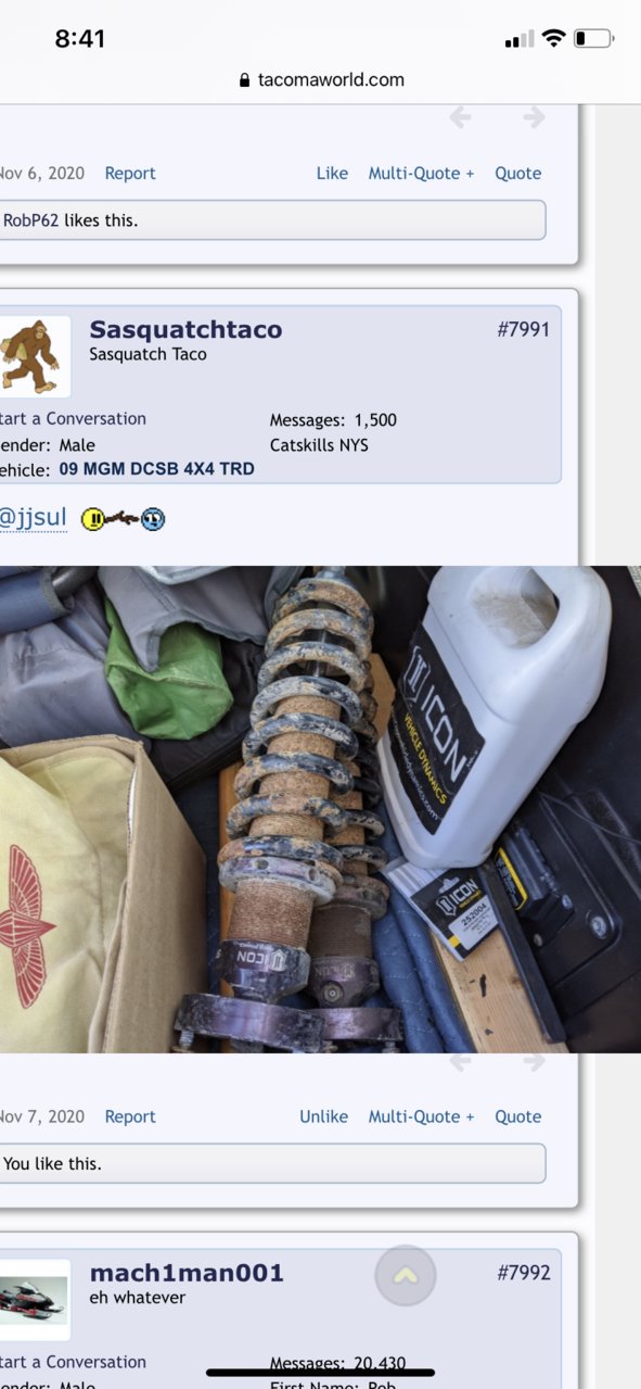

    @Prayn4surf hey boss I’m hoping you can chime in about your experience w the different coils you’ve had on your icons.
    I just picked up a used set of extended travel icons that need a rebuild and I’m wondering about revalving and spring rates. It looks like you’ve had 13” 650#, 14” 700#, and 14” 650# coils. How come you went back down to 650?
    also, how did you decide on your new valving? Did you get the flutter stacks from icon directly? Accutune told me theirs don’t work with icon shocks.
    thanks for any thoughts!
    James

    I’ve got an OME kit in the truck right now and grabbed the extended icons for $200. They def need a rebuild and possibly new shock bodies, but they were so cheap I figured I’d give them a go. They have some 650# springs but I’m not sure if they’re tired or not. Was thinking of just replacing those too and starting as fresh as possible.
    I don’t like the ride of the OME kit. It is so harsh....brick dump truck style even with plate bumper, skids, and steel cable winch. My bed is empty, so the rear is stiff as well. Just wanna smooth things out and get an upgrade at the same time.

    I haven’t ever had a set of proper coilovers let alone rebuilt any, but where would the fun be without something new to learn. :thumbsup:
    Seems straight forward from what I have seen. Gonna plan for new seals, shock bodies, and whatever the bottom mount bearings are called. Given their state I’m wondering about coils
