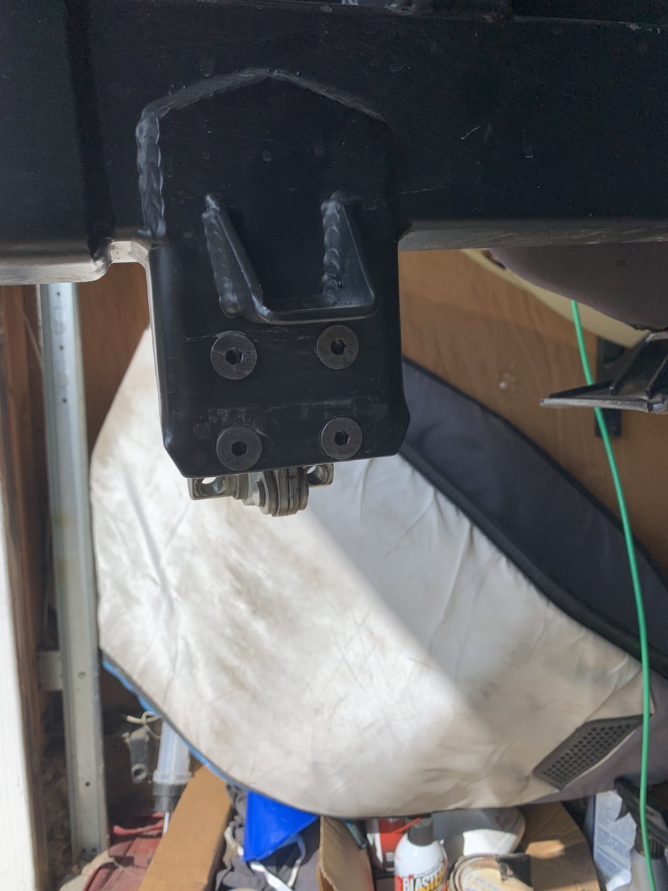

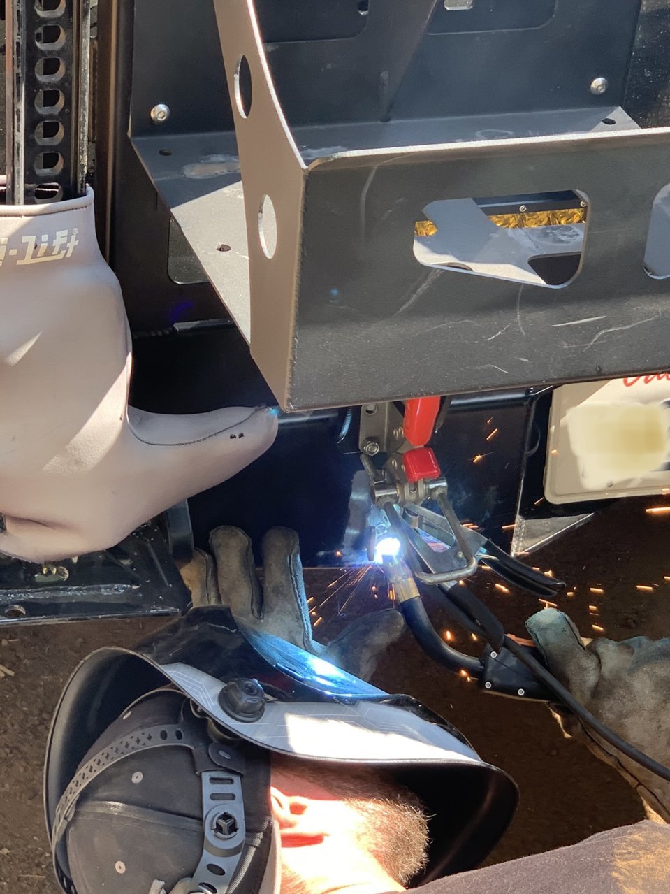

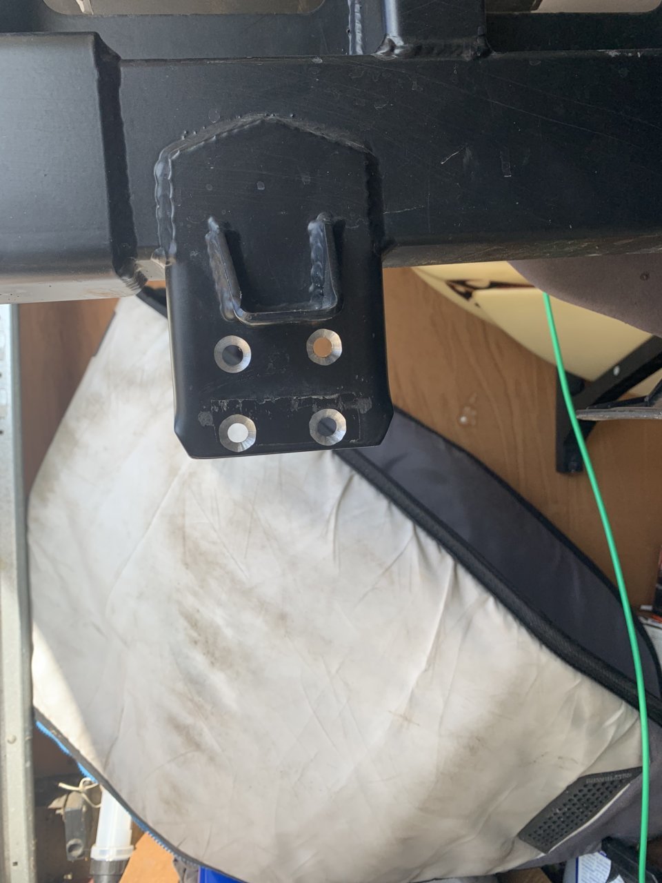

    So its been a minute. But I finally got around to addressing two things. First off, I have to give tons of praise to Shane for always helping me out with most of my projects! I try to reciprocate but admit I don’t always do so. I love ya man and truly appreciate you brotha.
    So the bumper, I hope this fixes the issues, or at least minimizes it. I went over to @desertjunkie760 place and we bounced ideas around, and both kinda came to the conclusion this was maybe not an end all fix, but will definitely minimize vertical movement. There was enough room on the plate that rests on the bumper to get another latch on there and not compromise exit angles. Im still waiting on the uhook for the latch to show up, so when they do Ill take some pics. I also want to add some kinda pin to lock the two swingouts together eventually.

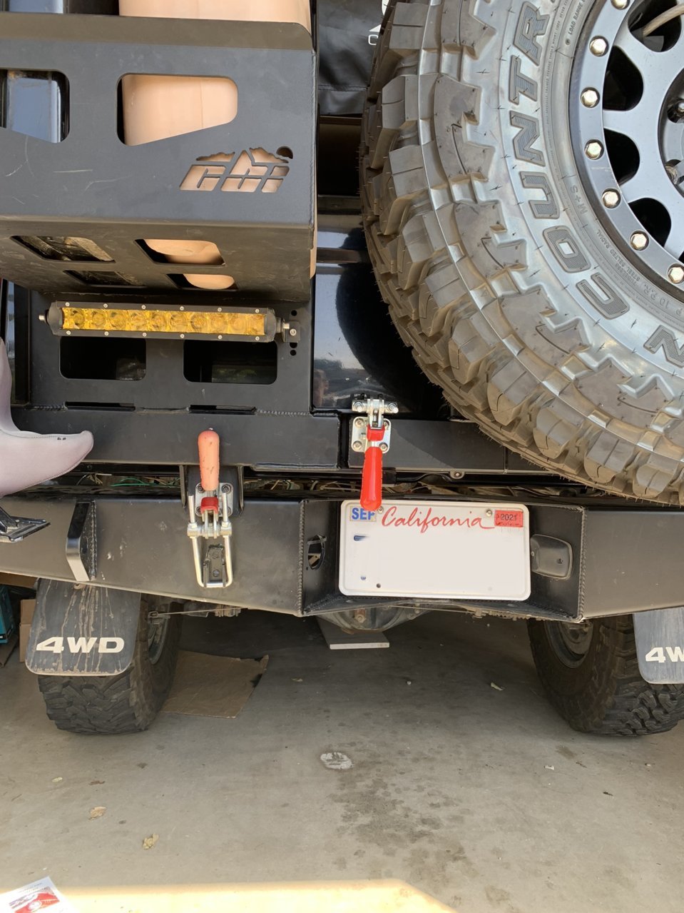

    I finally added a cheapo light bar for dustlights that @desertjunkie760 has been telling me I needed for maybe 3 years now hahah.

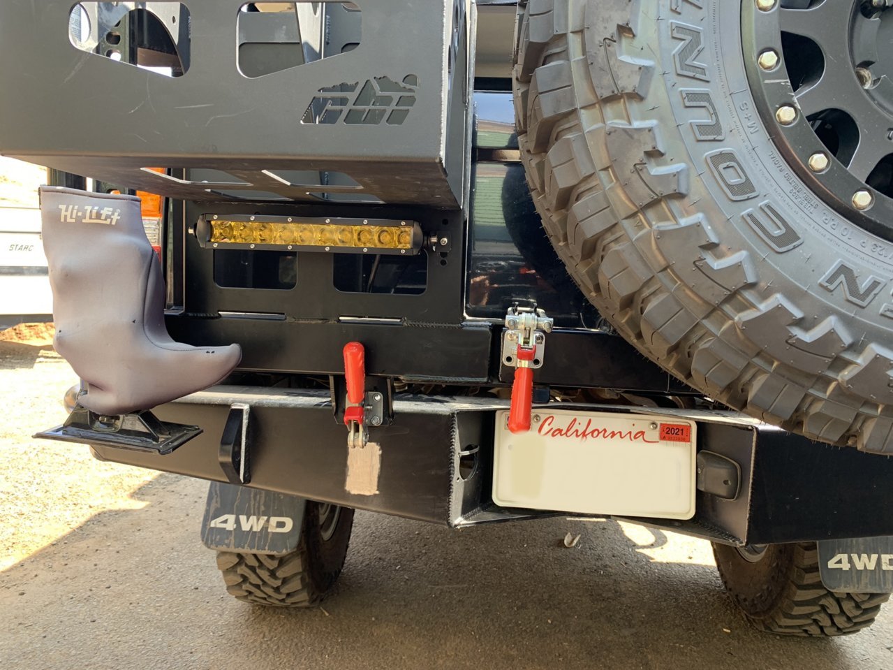

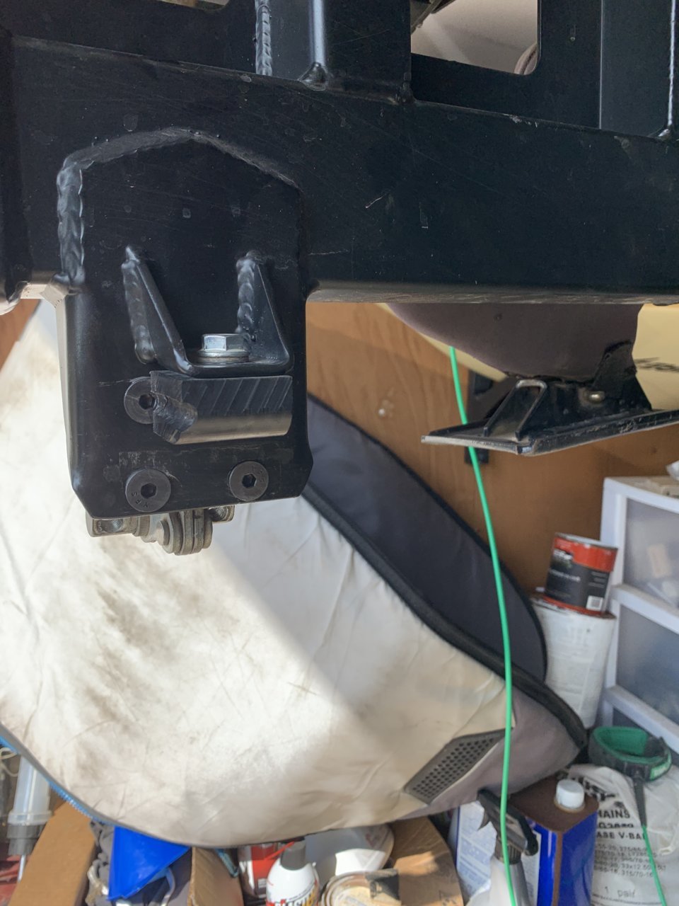

    Soo after ordering the wrong length ubolt I finally got everything squared away on the bumper and the second latch mounted flush. 2A4F63C6-BEE3-4537-9713-C5D54F5E783B.jpg
    this should minimize most of the vertical movement and I want to ad a pin to make sure the swingout wont fly open if the main latch fails again. Also got the dust light wired and set to strobe.
