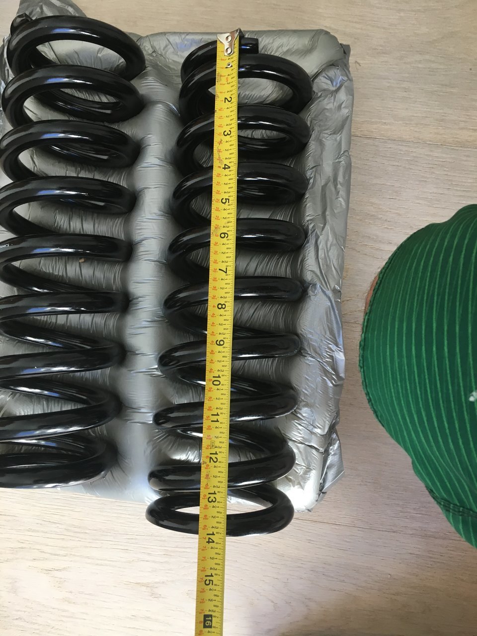

    yeah with the tent, the swingout, and the spare, i need more...my leafs are a little less than flat :(
    I never thought about going with longer coils...hmm well hopefully this leaves me satisfied and not spending more money on more coils haha, if i do I blame you sir haha

    lol Well let me know how you like them. And if you decide to go with 14" coils, you have to go with kings coils.

    also i think once you bump up to #700 it decreases the amount of preload you can have from 2.2" to like 1.5" I cant remember exactly but I would look into that.

    Also, it may be different for the 1st gen trucks, but I know on the 2nd gens if you order 700# springs from Icon they send you the 14" springs. Have you measured yours?

    CBI sliders, ADS extend travel with compression adjuster coil overs, 9” Bilstein 5125 rear shocks, Icon Tubular UCA, Alcan custom leafs, All Pro Apex bumper and skids, NWTI rear diy bumper, 295/70/17 Cooper St Maxxs and nitro 4.88s.

    5100s are a little different than a mid-travel coil. Especially if you are using a stock coil. If you think that’s sketch, try messin with a 700# coil on one of those dinky compressors.

    Looky who works selling car parts haha you are correct, n no i hadnt measured em

    ^ also explains why you can't add as much preload, coil is an inch taller.

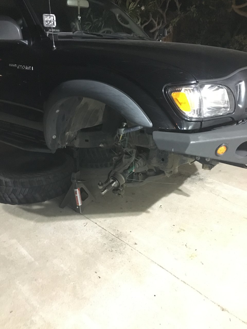

    And then everything was removed, well the things im upgrading :DA4B44CC8-22E5-4C9F-8C31-F996BF9041B9.jpg
