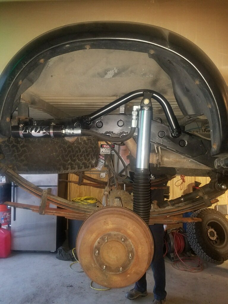

    If you do out board shocks in rear body roll will be even less

    And mount them like a second gen... when i eventually flip my u bolts i will look into that since i will have to weld anyways

    mine are both facing forward. I got the solo kit, def recommend either the solo/total chaos kit. I’m sure 2nd gen style would work pretty good too

    Like these, 2nd gen has one back an one forward
