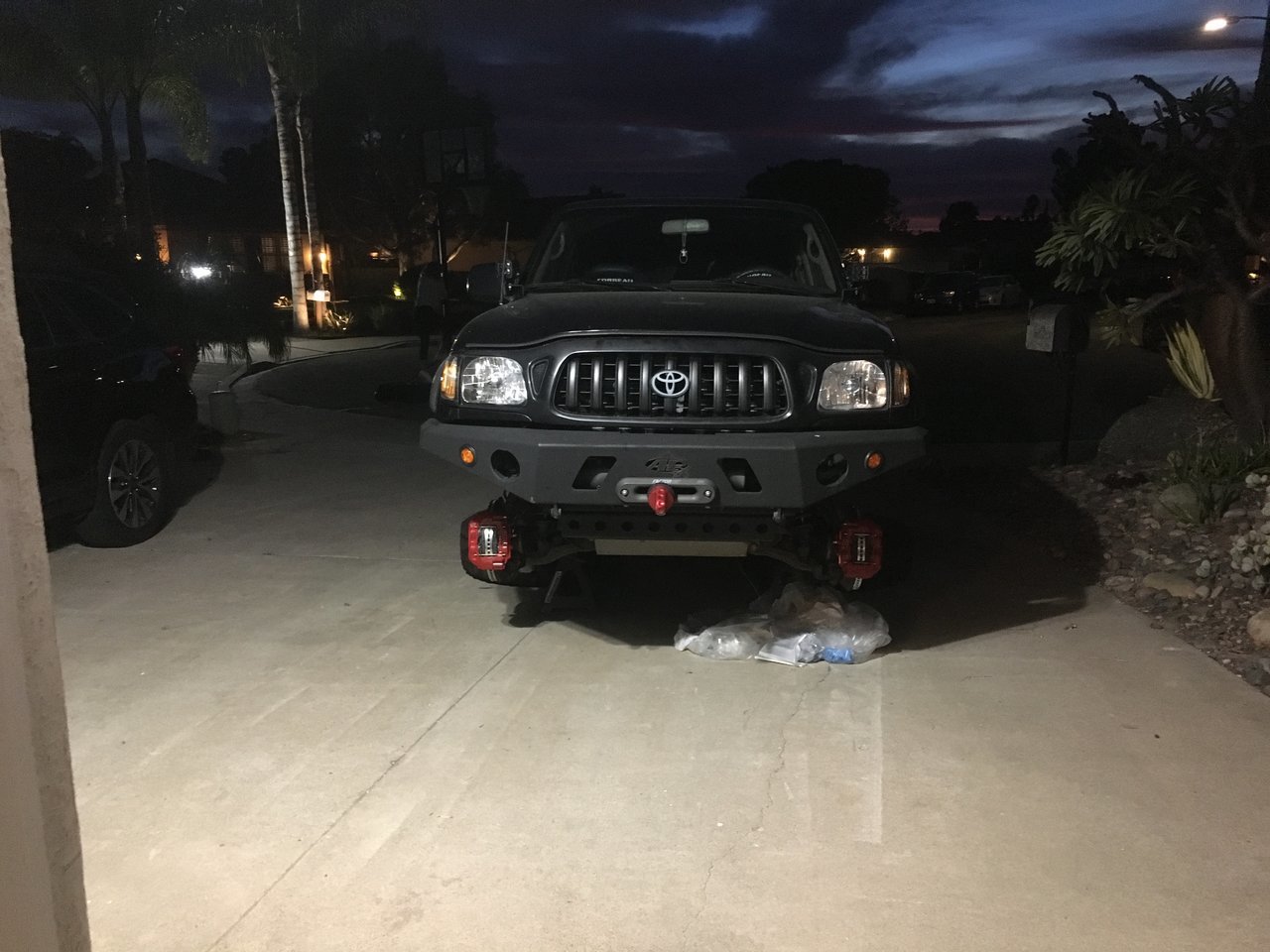

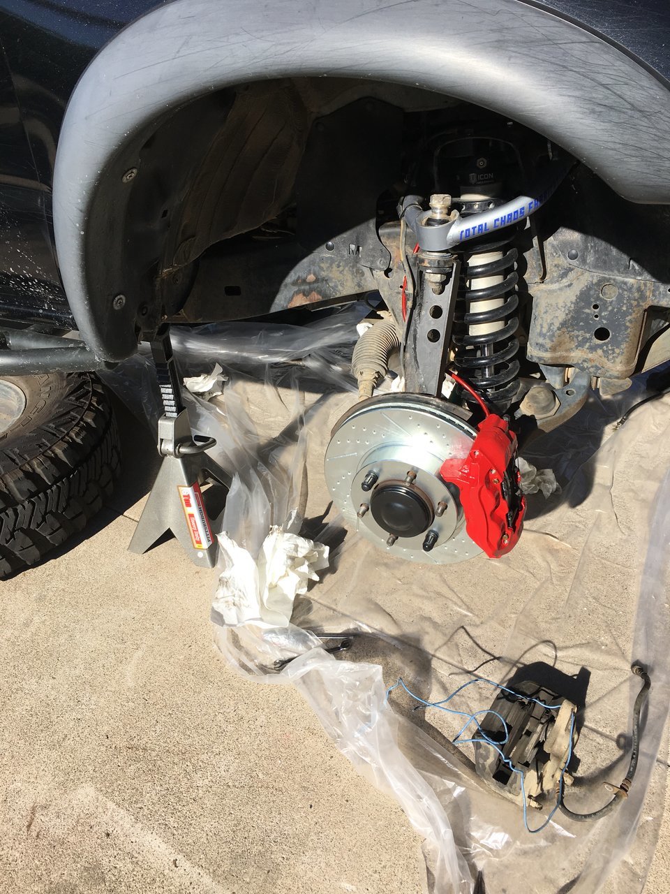

    So still have yet to do the rear cause my og rear brakeline stretched pretty far when i tried to remove the leafs, probably coulda got em out but edged on the side of caution and ordered some brakeline extensions. Then a day later my pads were scraping signaling time for new pads. I said when the pads wore i would do the tundra swap, so...25244A98-C640-4204-98D2-F3F771629B95.jpg 532DF28A-11CB-465D-9F98-A98BB1891FC6.jpg
    I will admit I dont like working on brakes. Was a straightforward upgrade and I lucked out with some difficult hicups, but this one played with my head. #brakefluidisslipperyasfuck

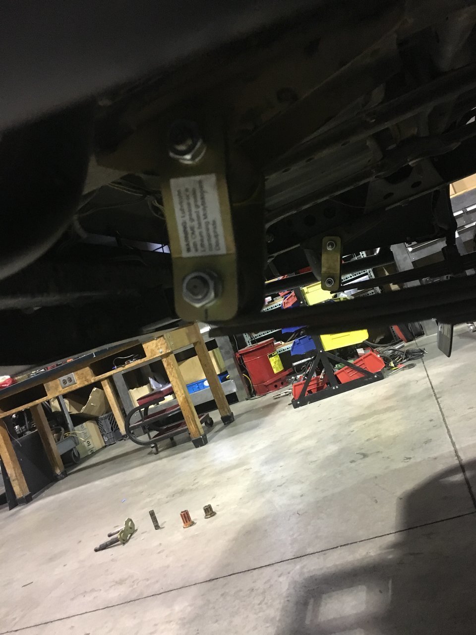

    So this weekend we ended up working on some trucks helped swap a friends supension completely out including ucas..let him n someone else swap his leafs lol etc etc, and last but not least I had energy n time left for replacing my shackles w a kit from toytec that has zerks...was 3/4 for the zerks one snapped yet easily unscrewed and was replaced sunday before painting my fence and sifting dirt to fill my drainage ditch. #mybackhurts
    Good thing is those shackles are quiet as church mice. Bad thing is it isolated the squeak and its the front bushing that is making all the noise. I was hoping it wasn't the culprit to avoid more work. So eventually those will get torched out and the daystars i have put in. By the time I got to work on my truck it was 6hrs in on wrenching n i didnt have it in me to remove another set of leafs n torch those suckers...I was satisfied with my small win. This instal also brought to my attention I need bumb stops n need to address my ebrake line and see if I can do something to keep it from limiting my truck at full droop

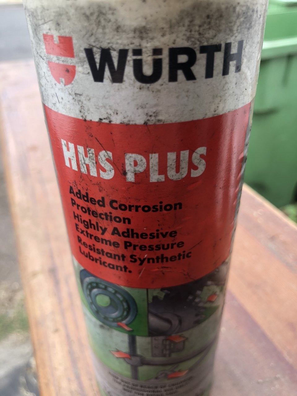

    My ome leafs squeaked too, had old bushings in there an they squeaked, an new ones squeak
    I ended up using that wurth lube on old an new got rid of squeaking

    The rubber care product?

    This stuff
    But just ordered some wurth silicone lubricant gonna try that stuff
