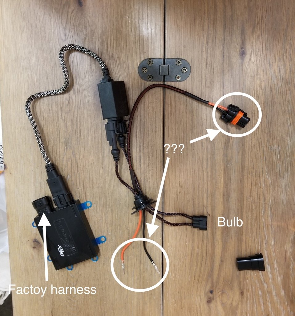

    Does anyone have a link on how to install these kits, im a little lost when I have to two different connectors that plug to the bulb. Do I have to plug the 2 pig tales into anything?

    Did you get the hid with or without the harness?

    Without

    The female plugs go into your ballasts and the male plug where the connector has to be attached by you goes into your factory wiring that used to plug into your factory bulb

    For the part that I labeled ???, I could just get rid of that wire right.
