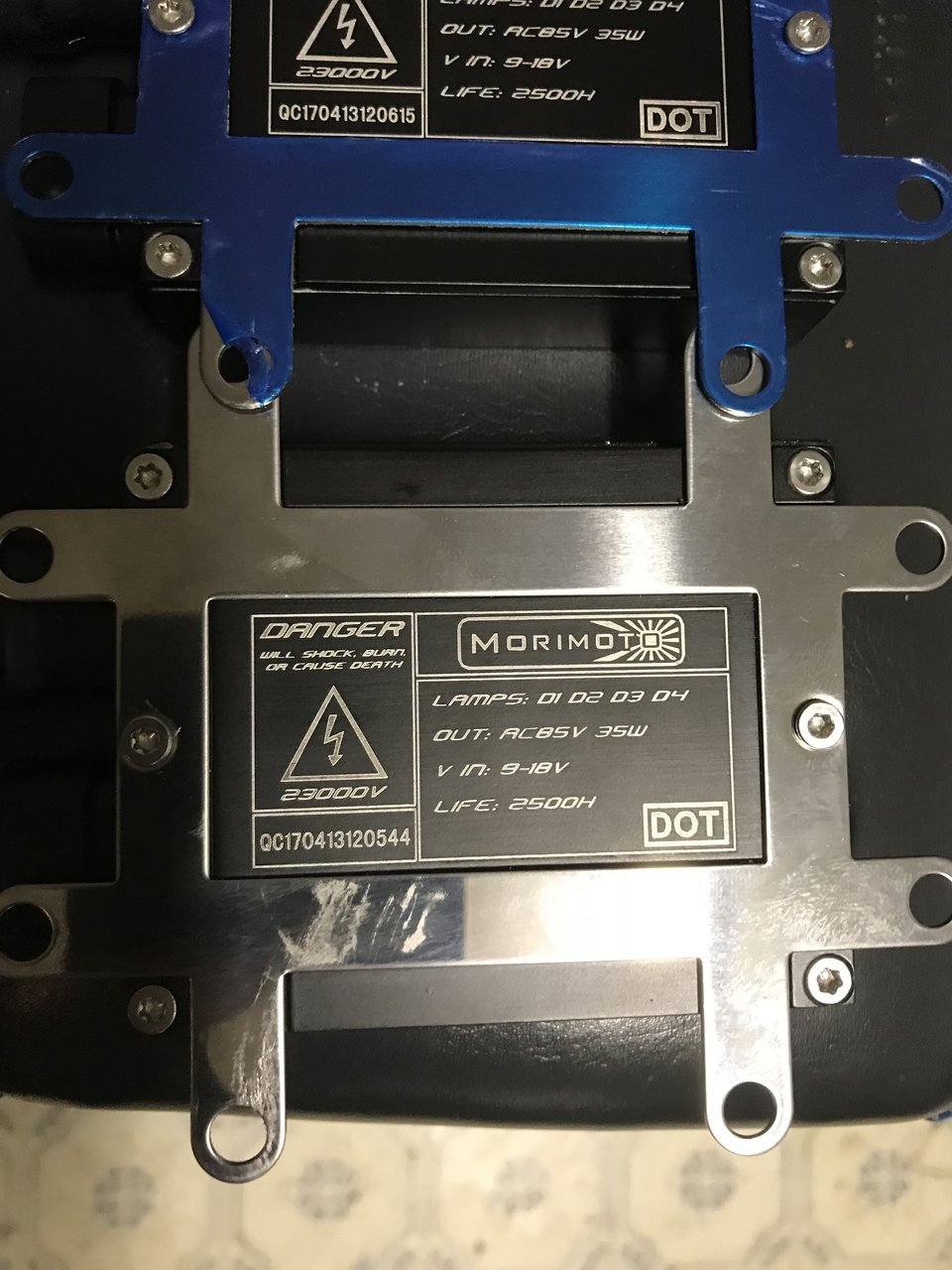

    Hey Tw, not sure if this is correct but the factory harness does NOT fit my ballast. Looks like it's a different input, the back of it says D1-4. I will upload a picture when possible.

    I think I figured it out. This should only apply to the NO RELAY route.
    You should have some loose pieces from the igniter package, two orange rubber pieces and the plastic adapter. You basically have to put that together. If you followed instructions on removing the extra wiring, previously mentioned and I totally missed it, DONT. You’ll need that to compete the setup and it should work from there. Sorry I’m a noob to this but it was pretty confusing to have those extra parts and then the instructions telling you to remove the excess wiring.

    For everything that purchased without a harness, you will need to attach the loose black piece that came with your kit to the orange and black wire and that plug hooks up to your OEM harness, the female end of that hooks up to your ballast. I'll upload a picture shortly
