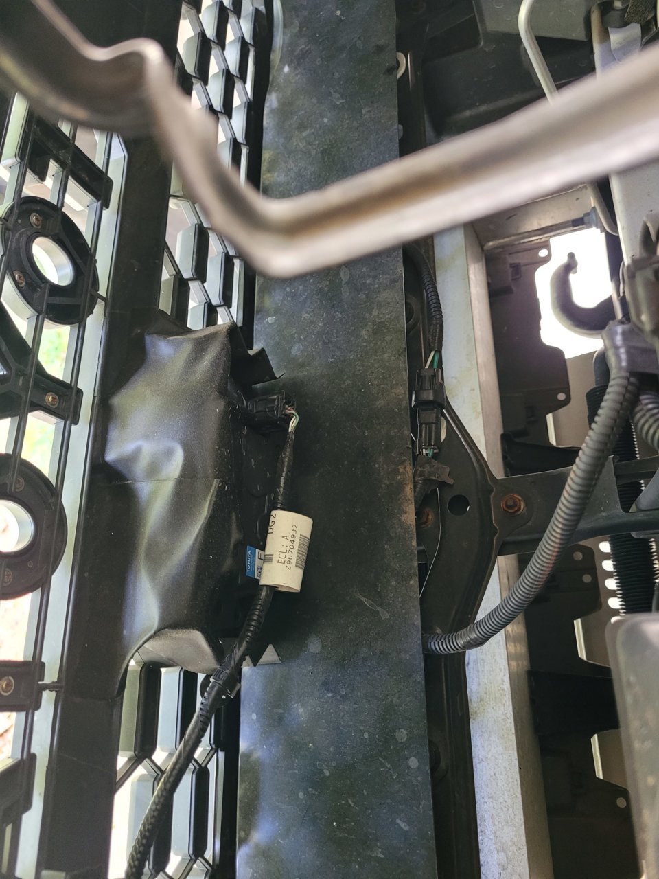

    I "shrouded" the top portion of my radar sensor assembly with some of that Gorilla rubber tape so that very little if any rain or snow can reach the actual sensor through the grill grate. I've had zero weather related issues with the system since doing so. 20230827_171002.jpg
