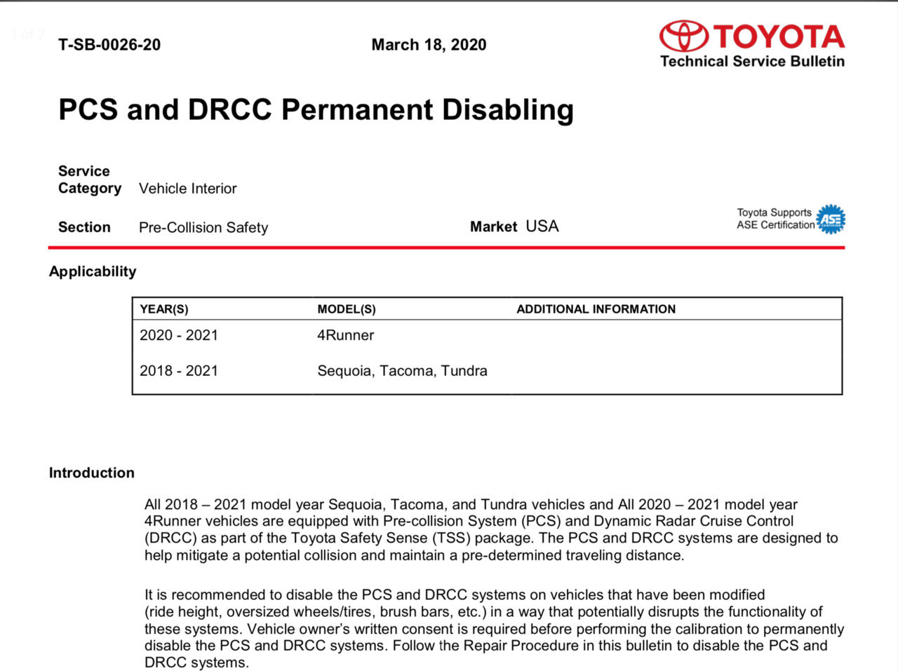

  17. Oct 13, 2022 at 11:17 AM
    #37
    TRD Ted
    TRD Ted Well-Known Member
    Nov 5, 2019
    #309903
    272
    2020 Army Green TRD Pro
    I believe there is a TSB that allows the dealership to deactivate the system if a truck has been lifted as long as you sign a waiver that absolves them of any liability if an accident happens.
    H3llRid3r likes this.
  18. Oct 13, 2022 at 11:27 AM
    #38
    GoodDogRUGER
    GoodDogRUGER 2021 SR ACCESS V6 4x4
    Feb 18, 2021
    #356618
    220
    Heath
    SOCAL
    2021 SR Access Cab V6 4x4
    6112/5160, 285/75/17 BFG KO2 , SPC, Method 703s, BMC/CMC, ARE DCU,
    Agree this is an option! I had to show my dealer how to do this via a TSB, they didnt believe me... Glad I did not go this route so far. One question though, are there any idiot light lit up or messages with this turned off??
