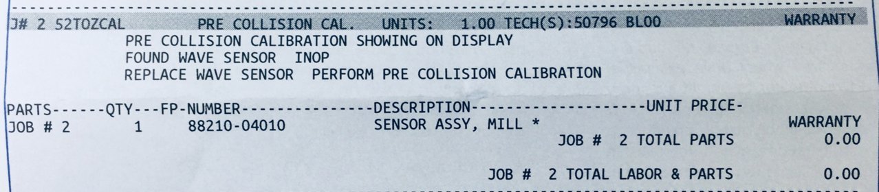

    Just got my truck back from the dealer about an hour ago. Problem solved!

    Glad we have at least one solved case. I DO hope mine is that easy. Especially since it’s similar mileage.

    Dealership resolved my issue within an hour. Said the steering sensor needed to be recalibrated. Drove about 50 miles this morning and the problem hasn’t returned yet. Sounds like my issue was from the lift/alignment. Alignment shop should have done the recal themselves. Toyota charged $150 with tax and everything. Glad to have it resolved but will be fighting with the 4x4 shop to reimburse me. I feel like they should have had it taken care of in house as part of the service. Will see.

    I asked and dealership said the codes give them an idea what the issue is. My issue, the OP’s issue and even JRN001’s issue all had the same symptoms/same lights because of the way the fuses tie together with entirely different solutions.
