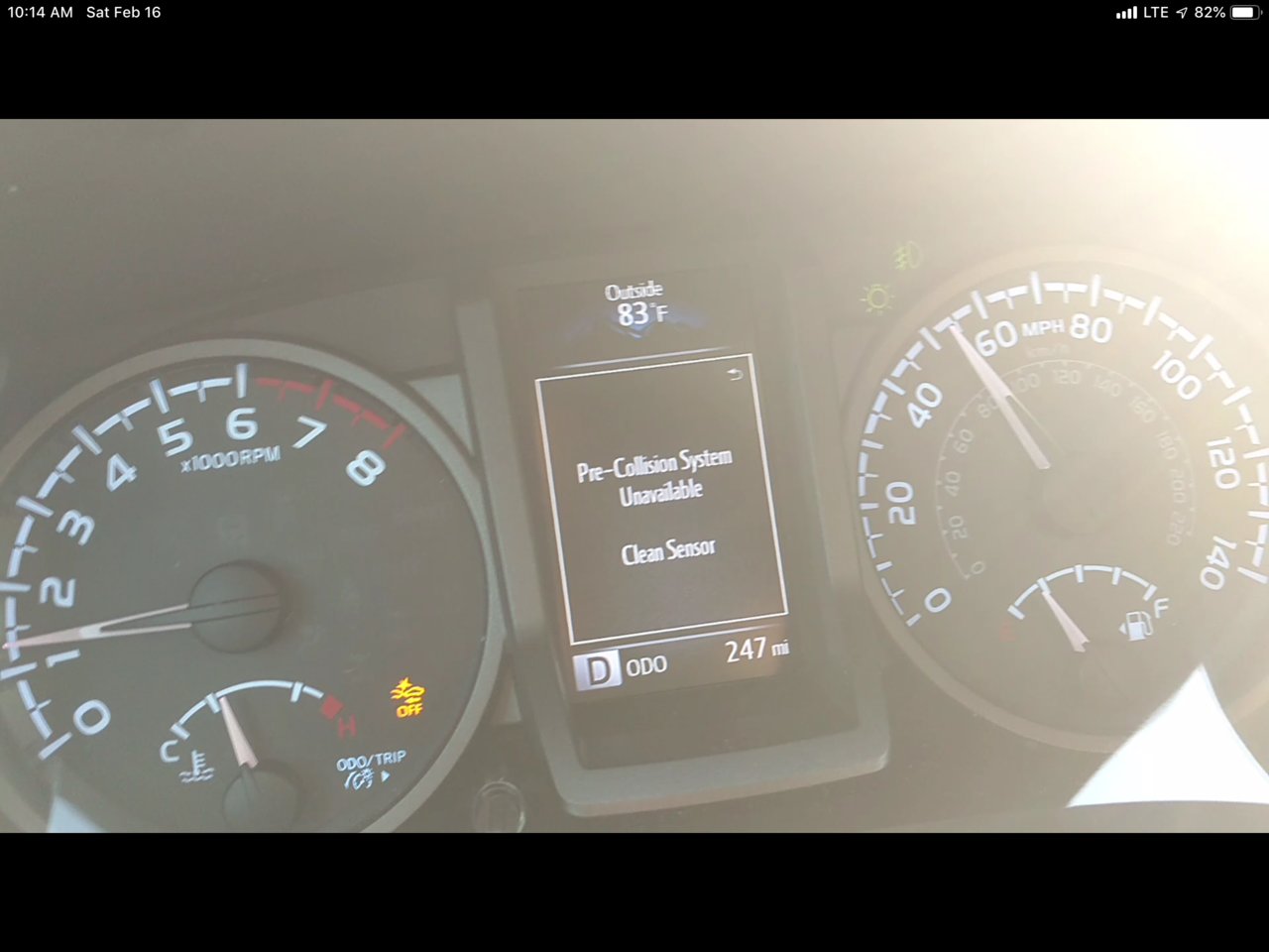

    I’ve been having problems with the sensor on my 2019. The pre collision light has been coming on with a “Pre-collision system unavailable - clean sensor” warning. The sensor is clean and the truck is bone stock with no modifications. I’ll be visiting the dealer when I get a weekend off.
    Also, when this happens the distance monitoring cruise control does not work.

    I would definitely take it in. The only time I have seen this is when I took my grill off & forgot to plug it back in when I was done. Its obvious it's not from snow/ice & road grime on the sensor at 83°

    That has definitely happened to me. When you get the “clean sensor” error and its not there when you head to the dealership, the ecu doesn’t save that error message and even if i took videos and pics of the error message they still gave me the runaround. My experience though once you start getting that message it won’t take long til the “take to dealer” message appears. That saves to the ecu and they wont give excuses after that. Im on my 2nd replacement sensor now. According to the dealer, Toyota is looking into redesigning the sensor to seal it fron moisture but who knows if thats true or when its going to happen
