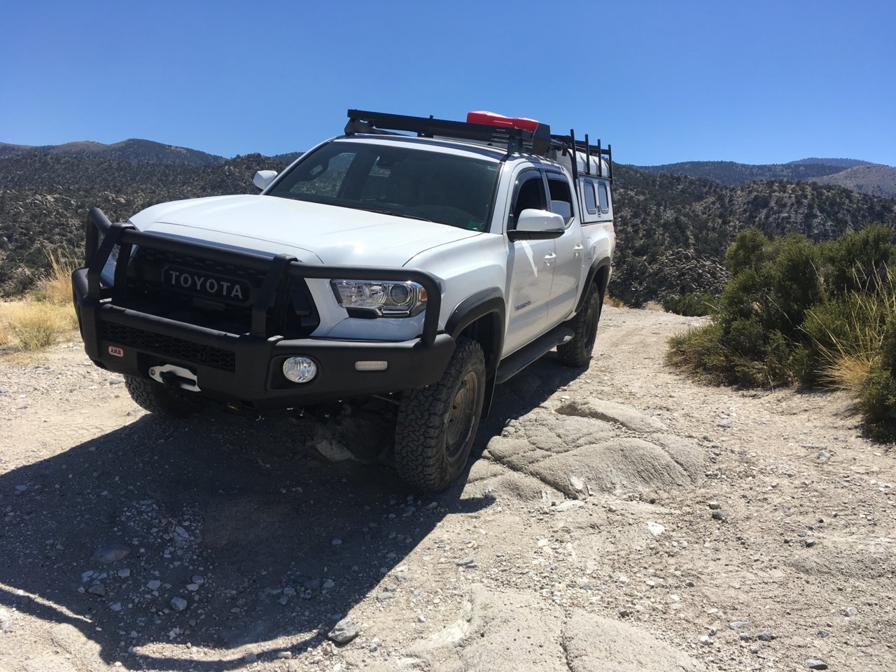

    So I added an ARB front bumper and winch. My front collision avoidance system doesn’t work now. I expected this since it’s partially blocked. This was no big deal initially, as I was still able to use my cruise control, just without the adaptive portion working. Now I get a message that says to see my dealer, and that the collision system isn’t working. I tried to turn it off after the error popped up by disconnecting the battery for about a half hour, this didn’t work. I also tried to disable in the menu and this didn’t work either. Obviously this is outside the warranty. Any thoughts before I take it into the dealer?DB22A4DD-1AB5-49AD-AA7D-E93166A3A7B0.jpg 462B25E9-0D59-48C2-9AA5-098DE0E988EB.jpg

    Get an sr5 grill and move the sensor up out of the way of the bumper?

    Disconnect the sensor?

    Disconnecting the TSS causes same error warnings.

    You can set PCS to default to off (by remembering the last setting) using techstream or carista. TSB 0059-18 tells how to do this with techstream. Carista is similar.

    I was looking at an Arb bumper until I read the small print on their site about “some” trucks having the problem with TSS. Leads me to believe it is because the pro grill has the sensor so low, I would have to think GreyBaldTaco is right, get a grill that moves it higher

    get the toyota grill that keeps sensor behind the logo. Mine works fine with stock grille and arb.

    Techstream is a done with a computer and an OBD cable, carista is done with an app and a Bluetooth OBD adapter.
