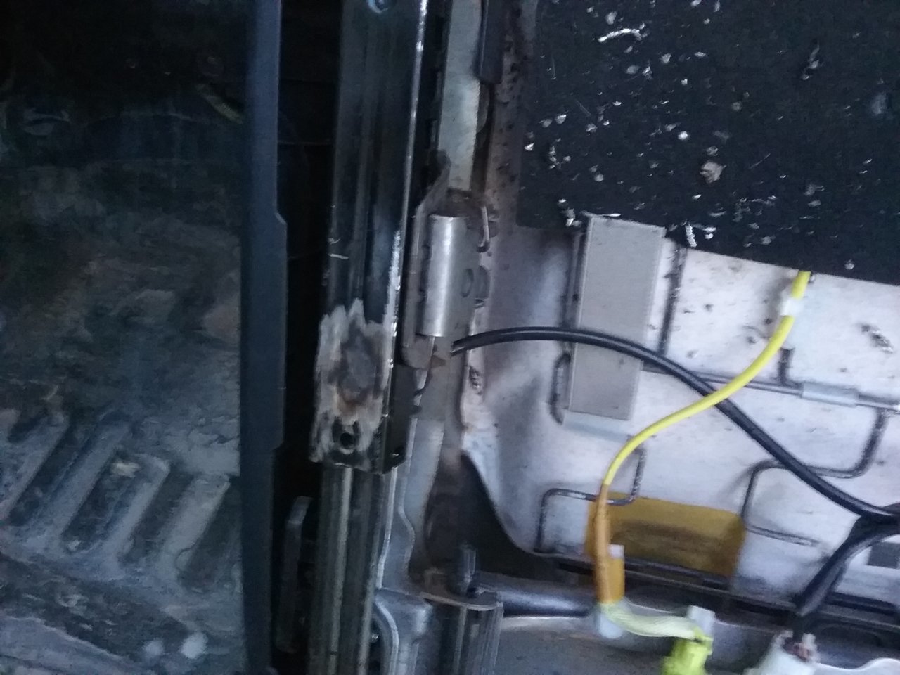

    Started by grinding the scion feet off the sliders. They were riveted and electronically welded. They were buggers to get off

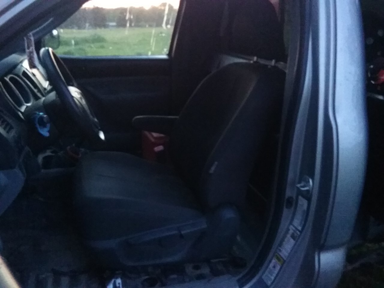

    Then bolted the tacoma feet down and test fit it
    Sits about 1.5 inches higher than the tacoma seats. The spacing is about .75 of an inch too wide on the front, so I may cock the tacoma mounts at an angle to compensate for it
