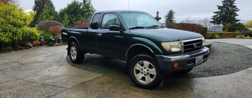

    Seeking inspection advice.
    Came across this 45 min outside Seattle, WA. Owner says it started running rough and wants to get rid of it for $1700. Looks clean, and given that these still sell for $7-10K, this seems like a bargain or too good to be true.
    UPDATE: I checked it out this morning. Passed on buying, as I wasn't sure it would make it home. Not freeway worthy.
    GOOD:
    1. The entire frame had been replaced (but not by Toyota).
    2. 4WD worked
    3. Cold startup and fast idle was good.
    BAD:
    1. The automatic transmission seemed to have a grindy-whine sound and may have been shifting rough and late. Hesitant to transfer power to wheels at times.
    2. It died frequently on idle after driving, and the starter (or battery) were very hesitant.
    3. Full width cracks in the windshield, and the cabin was wet/moldy inside (Seattle).
    4. Couldn't get the e-brake light to turn off. Front left brake seemed to grab--at least at first.
    5. No spare tire, and one of the rims was a cheapo replacement while three were original Toyota alloy.
    6. Drivers side exterior door handle wouldn't operate. Passenger side handle was weak.

    @ $1,700 just assume you'll have to change the motor out, but you'd still be ahead.
    1 - yes- flash light hammer. If it's got non-oem paint on it, then assume there is rust under there.
    2 - put it in 4x4. If it works, it works. If not you'd have to start diagnosing things- fuse, actuators, etc...
    3 - you don't- unless they have the records that OEM ball joints where installed recently, then just change them out for OEM.
    4 - yes

    At that price the only possible dealbreaker to me would be significant rust.
    GOOD:
    2. 4WD worked
    BAD:
