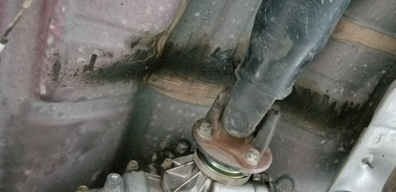

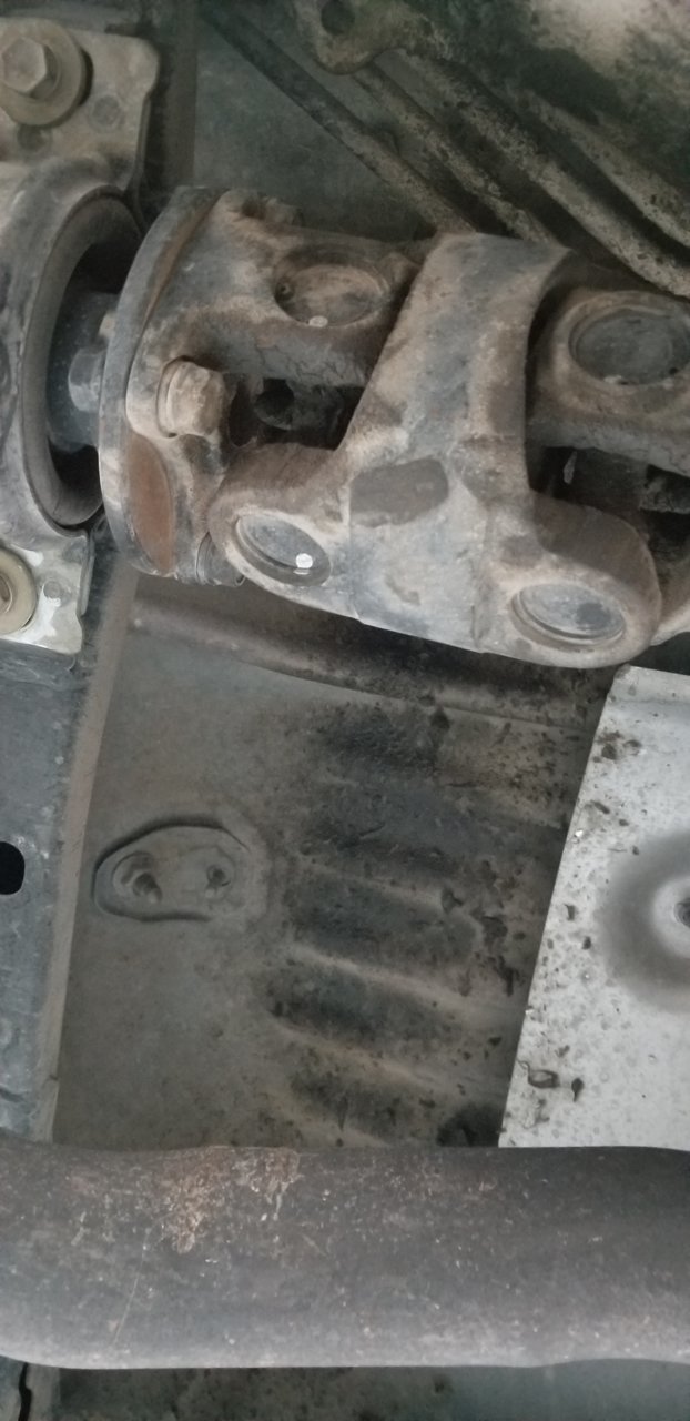

    20180517_192013.jpg 20180517_191941.jpg This is what I saw and freaked out..that to me looks like a blown joint. They all had this same pattern.

    Yeah, that's very smart. I have taken it back to another shop and had them inspect it. The manager at that shop looked at the truck with me himself and another tech. The tech and manager agreed that the other shop missed the carrier bearing. The u joints feel solid, no movement in any direction while on a lift and turning shaft or tires. So they decided that a previous lube shop had overfilled the joints and they sprayed the excess. They offered to make me a deal to do the carrier but it's a cheap and fairly easy fix that I can do myself. I want mad that I would have to replace something or that I couldn't do it, I was more angry because it looked so obvious to me. I would have thought that the tech would have at least mentioned something to me about it.

    Totally normal BTW, they're greasable and you over grease them to force the old grease out, then it sligns everywhere. All of my Toyotas have this

    Can confirm. I over did my U-Joints and flanges with grease to make sure all the old crap was evacuated, and the first drive I took on the highway I smelt burning. Turns out it was the grease sling everywhere (including the exhaust) and burning on the exhaust pipe.
    If anything that grease stain is a good sign, it means that whoever owned it before had the drivelines greased again.
