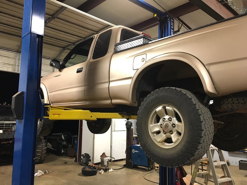

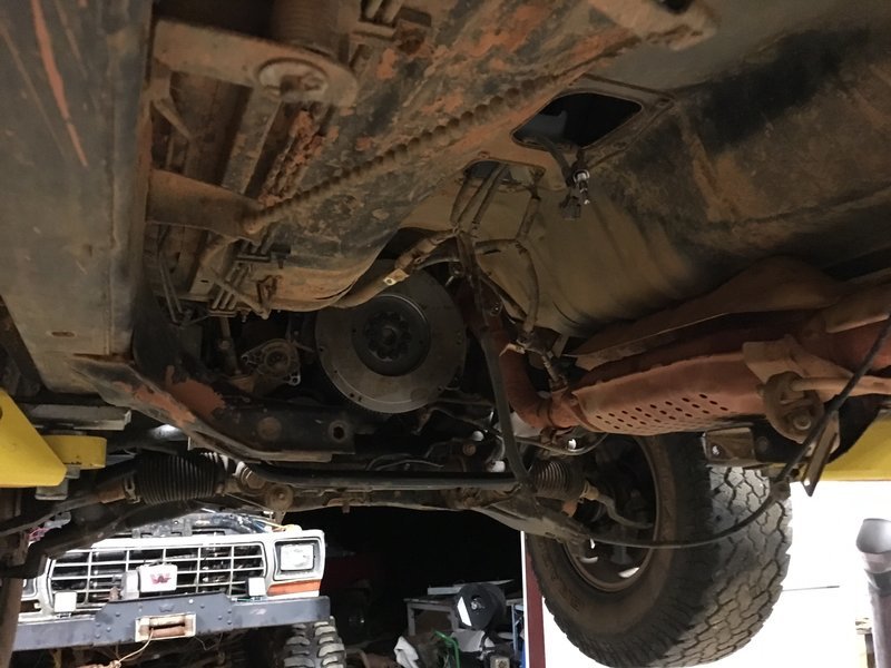

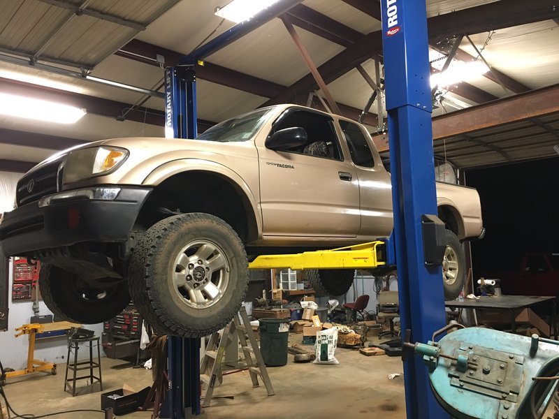

    Here she is on the lift, having this lift made this swap 10x easier.

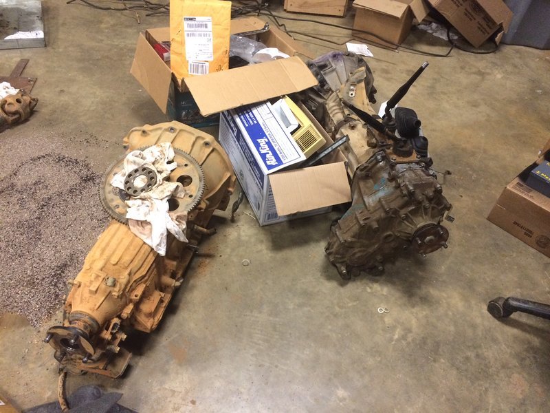

    Here is the A340E removed from the truck. This may be the most involved part of the swap. You have to take your time and make sure that you disconnect all the wires and lines from the auto. My torque converter stuck to the flywheel and when we pulled the trans, fluid went everywhere, just a heads up.

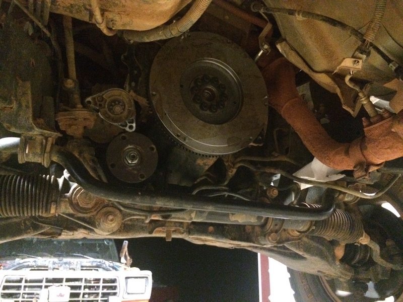

    Here is the new clutch flywheel with new bolts. i ordered new flywheel bolts from LCE Performance out in Cali.
    Here is a closer look at the flywheel, this was right before I put the pilot bearing in. I used an old socket that fit the bearing correctly and just tapped her in.

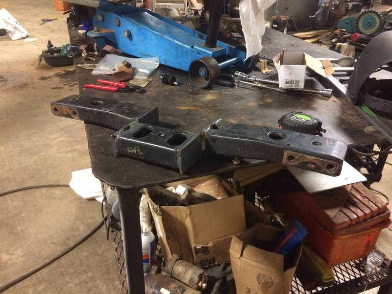

    The crossmember will require some fab work. My friend did the cutting and welding on this X member and so far it has worked perfectly.

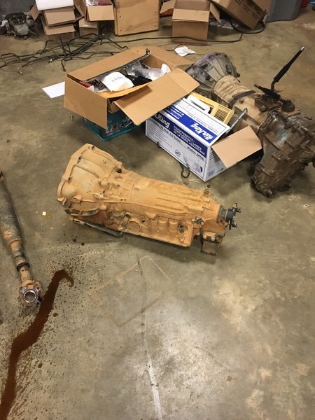

    Here is the A340E and W59/T-case next to each other. I ended up separating the W59 and t case for the install.

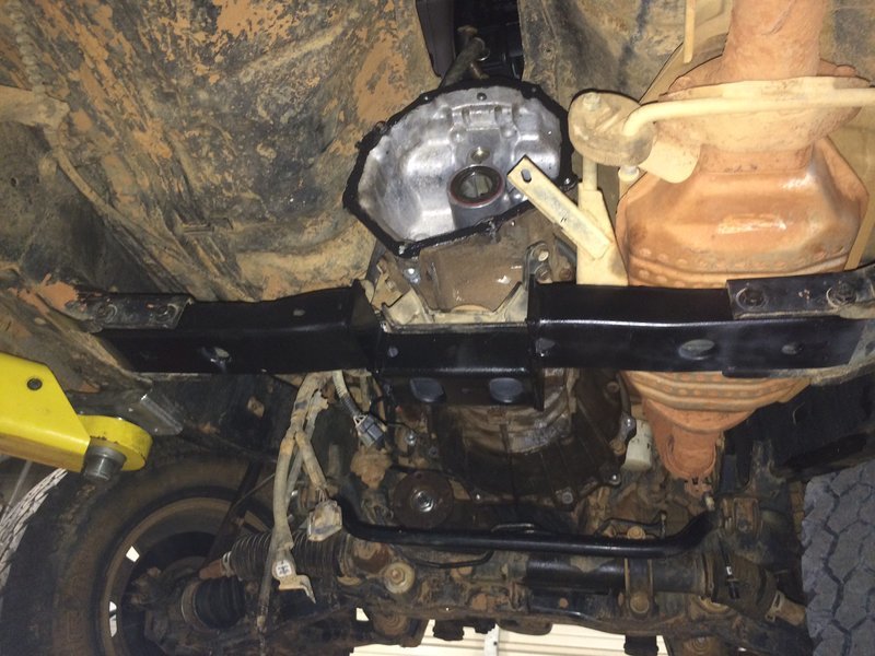

    Here is the x member reinstalled with the W59 trans. I should mention that the trans goes in very easily when the t case is not attached. We may end up welding a piece on the rear of the x member for added support.

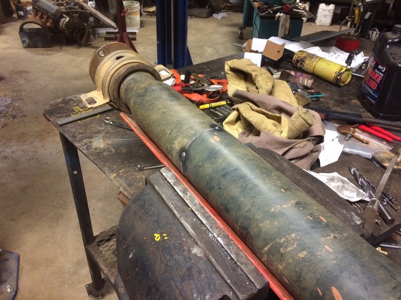

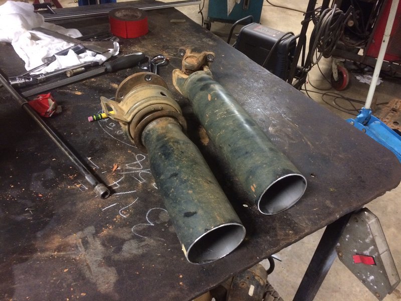

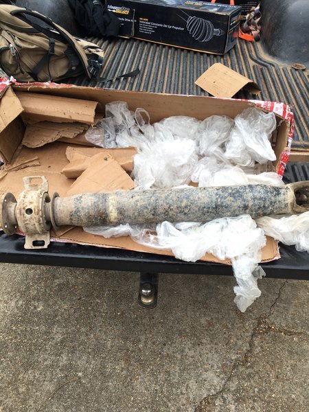

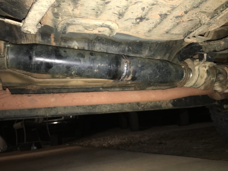

    The front section of the drive shaft was too long, so I bought a stock section from a guy off the forum. But we cut and welded the shaft like this just so we could move the truck. I do not recommend shortening a shaft this way, its not ideal.
    Here is the finished shaft out of the truck and then installed. This shaft actually drove great with zero vibration. My friend did the cutting/welding and this shaft was within a 1/4" of the stock replacement.
    This is the new shaft, bolted right up replacing the welded shaft.

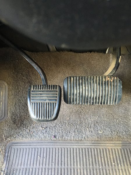

    This is the clutch pedal installed, I will try to get a pic of the master cylinder on here soon. I had a stencil from a friend who did this swap earlier so I was able to just mark the holes for the master cylinder, drill, and bolt it right up. I ended up shifting the pedal to the left a tad to help clear the brake pedal.

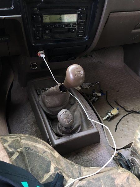

    Here is the interior of the truck now, ignore the wires, they are a work in progress. The drive feels like a completely different truck with the 5 speed. The motor feels stronger and doesn't struggle off idle like it used to.
