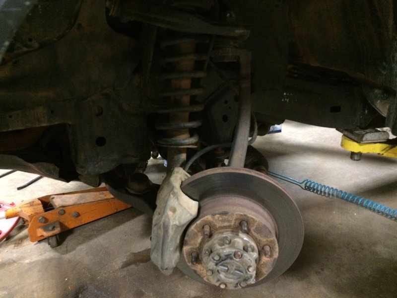

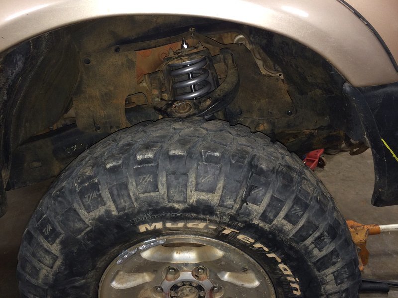

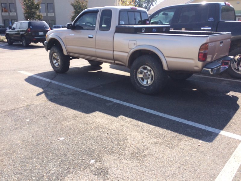

    Update: I ordered Eibach coils from Toytec and Bilstein 5100's. Toytec was great to work with and I got my stuff quickly. The new set up rides so much better then the stock coil-overs. I got more lift than I expected so now I'm lifted the rear and building a front bumper. IMG_7044.jpg
    This is the stock coil over in the truck. Again, I sucked at taking pics of the process. But there is a youtube video on this forum showing how to do this without a spring compressor, thats the way I did this swap. I left the 5100's on the bottom setting, per Toytec's recommendations.
    These are the new Eibach coils and 5100's in the truck easily clearing some 33x10.50 KM2's. There is no rubbing at all.
    As you can see, the front sits higher than the rear, like a Chevy with the torsion bars cranked up. I'll be lifting the rear in about a week and will try to actually take pictures of the process.
