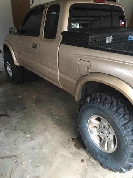

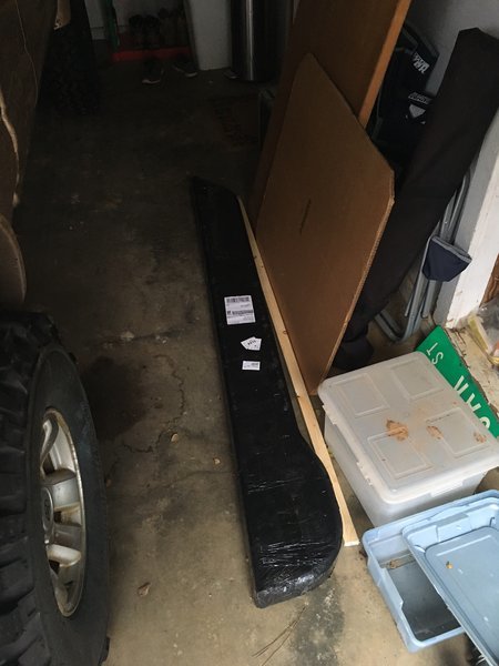

    Update: I have swapped the KM2's for a brand new set of 34x10.50 Super Swamper LTB's. I got these tires specifically for hunting season only, these are not a year round tire. I also purchased a set of sliders from 4xInnovations, have not had time to get them on, its finals week but hopefully I'll get them on within the next week.
    Heres the sliders as they came, wrapped and waiting to be welded to the frame. The shipping from 4x was fast, I got them in three days.

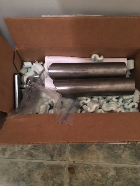

    This is the notched tubing that runs from the frame to the slider with the frame plates and gussets.

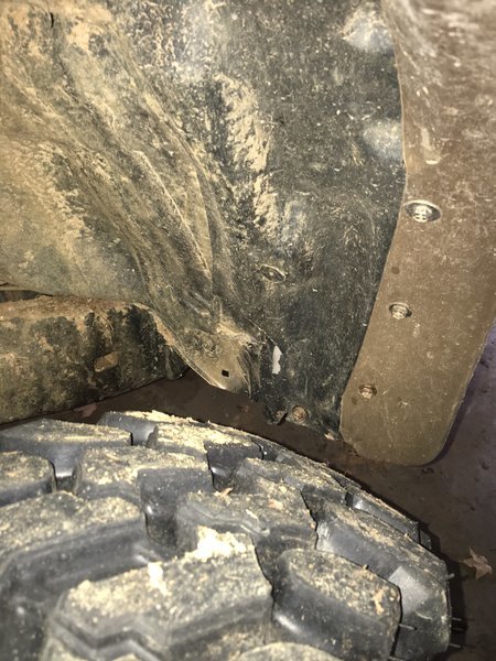

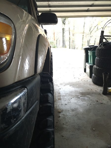

    Here is my truck as it sits with the LTB's, they rubbed at the pinch weld and the UCA's when the truck flexed. So, I ground down the pinch weld, which may hard to see in the picture I took. I am also running 1.5" wheel spacers, which I did not want to do, but had to to get the lugs off the UCA's. Also trimmed the front bumper a tad, but it'll be getting replaced with a plate bumper soon. Now I have no rubbing anywhere, and I love these tires, they are the best set of swampers I've ever run on a truck. They are honestly not the loud on the highway, I realize they are new though and will gradually get louder as they wear. I plan to rotate these every 1000 miles and get as much life out of them as I can. Once I get the sliders on I'll add some pics of them. Thanks for looking!

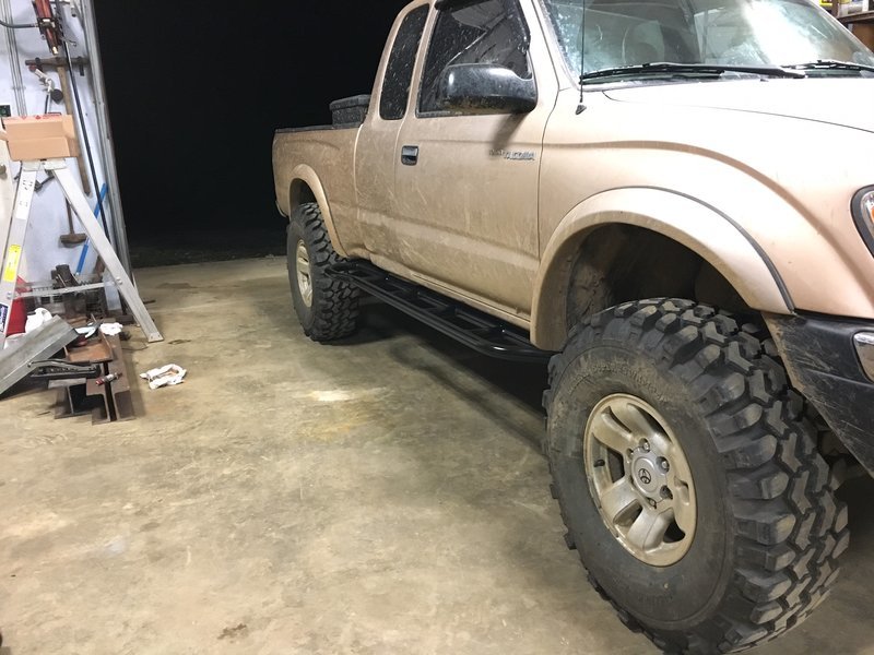

    Also got my sliders on, but my phone screwed up so I only have one pic of them. These are sliders with a kick out from 4xinnovations, and these sliders are great and I recommend them. Sadly, I dented the cab years ago before I had sliders but hopefully these will prevent anymore dents.
