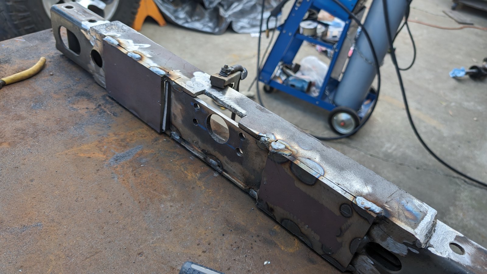

    Yeah I tried to reuse the existing crossmember, but it was ridiculous with the curves. So it was easier to fab up one out of 1/4" steel instead.

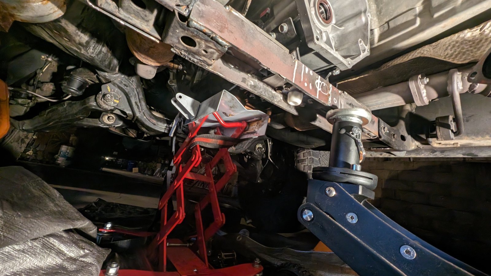

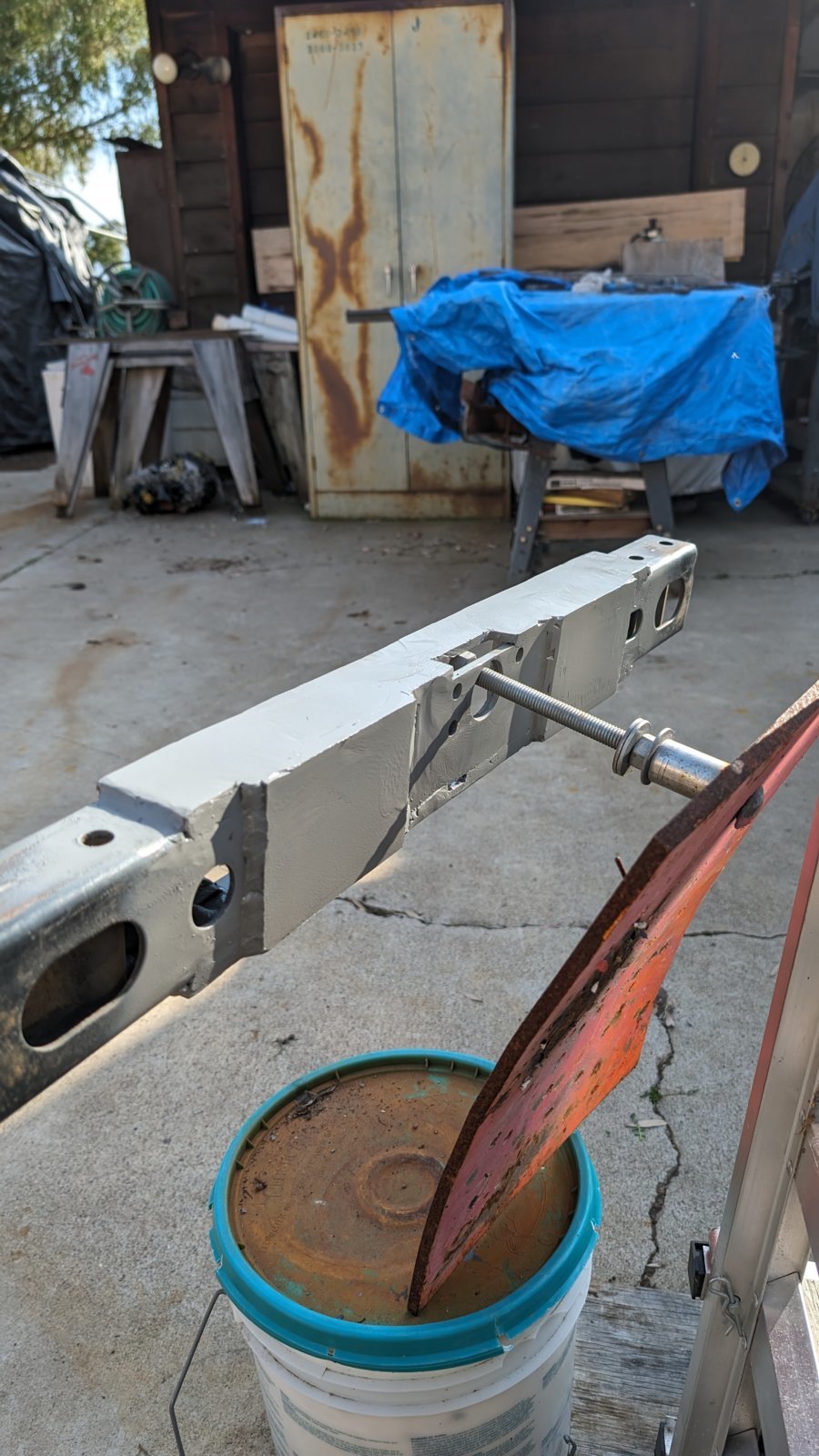

    PXL_20240117_030153590.MP.jpg The quick rundown is I used the existing mounting hole ends cut them off and put the bolts in made sure they were in the same plane across and then measured. This isn't something you can really fab up until your at the step as everyone's numbers I asked for were different. Specifically how high the transmission sits for your truck.PXL_20240117_193618419.MP.jpg

    The transmission is in the same spot, the crossmember is a bit lower because it uses the different transmission mount. So that's why you kind of have to have it in place to try to mock it up.
    I welded the crossmember and then made the mounting holes on a plate that I bolted in and welded it in place just to make sure it would fit. There's is very little tolerance on those stupid things lol.
