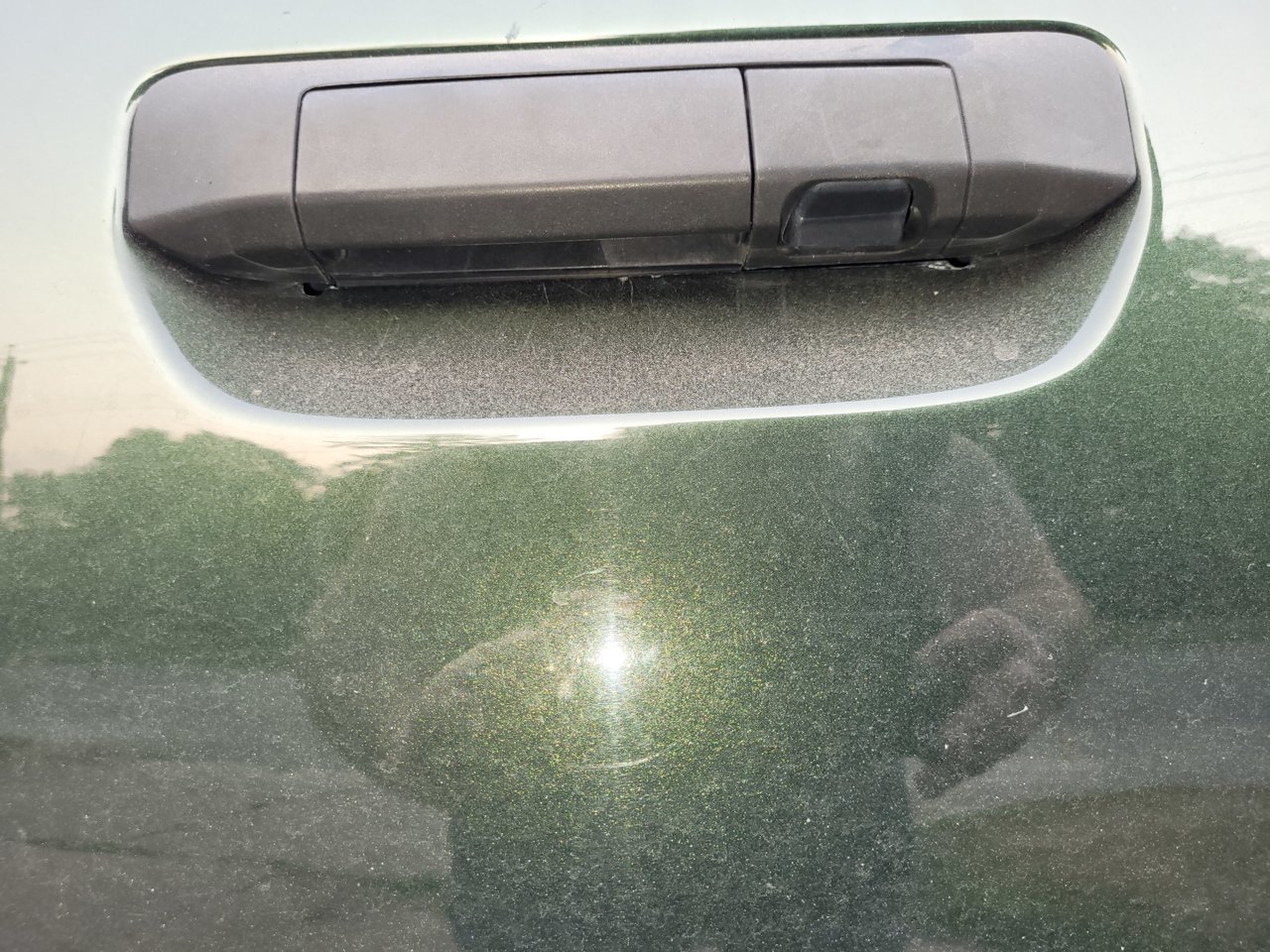

    I have a 2012 base model Tacoma 4x4 4 cyl. It was pre wired for cruise control and intermittent wipers but not fog lights. I added cuise and intermittent wipers. My question is. I have a wire harness that goes from the bed of the truck to the tail gate. Does this mean I'm pre wired for a back up camera? My tailgate latch has a camera blank. If so what all do I need to get to get it working? The image shows up in the rear view mirror correct? Where does the harness come out of the headliner? Thanks for any help.

    I have a base 2013 and I'm looking to install all 4 upgrades myself too (back up camera (have the wire harness), cruise control, wipers and fog lights), how'd you identify what you were prewired for? I called the dealer and they said I'd need to pay and bring it in but I'd like to identify it myself and install if possible.

    My 2014 had the blank for the camera and was pre wired. All I did was buy the actual Toyota camera, plug it in a wa-la, backup camera worked.

    Did you have the overhead storage area? Mine does not and I'm not sure I want to remove it only to not find one. The headliner does have a small slot for wires to fit through.

    Yeah mine is a base model 4x4. No over head anything but there is a little notch for some wiring to a rear view mirror. Maybe I'll just buy the camera but get a different stereo and wire it up to that.
