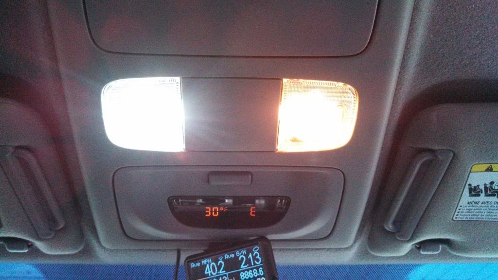

    Here's a pic of mine.IMG_20150210_160411_951_zpsx9dltpng_c3d9f2d9bfd74af9e5e5f91e705b034a1f67e5a4.jpg
    This pic also compares the OEM bulb to LED.

    Not to thread jack, but I do recommend the LED interior lights. Plenty bright for most lighting needs:D
