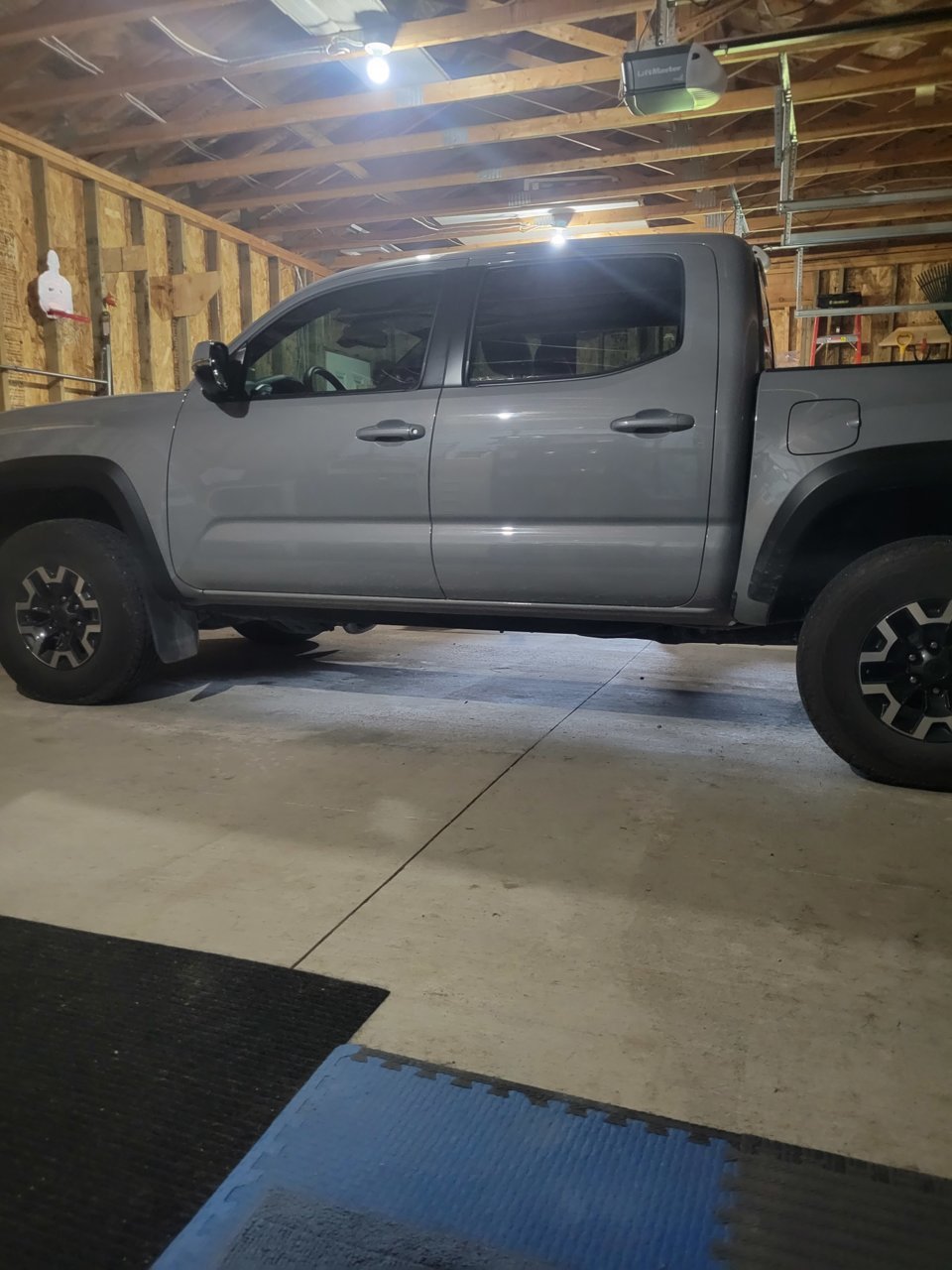

    20220719_190534.jpg I matched the rear tint on the front but found it a bit dark at night. Had to open window to park truck in tight garage. Redid a shade lighter

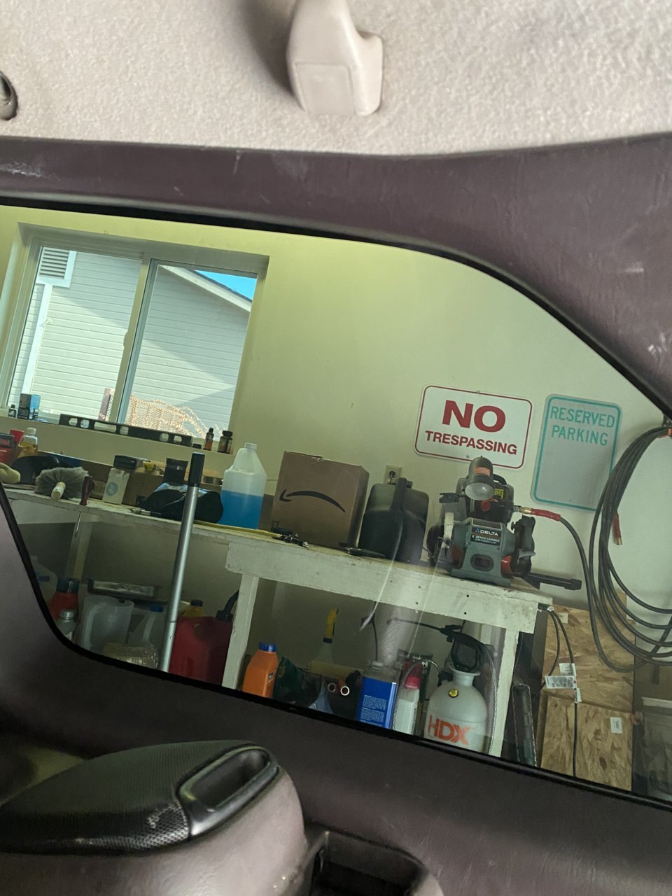

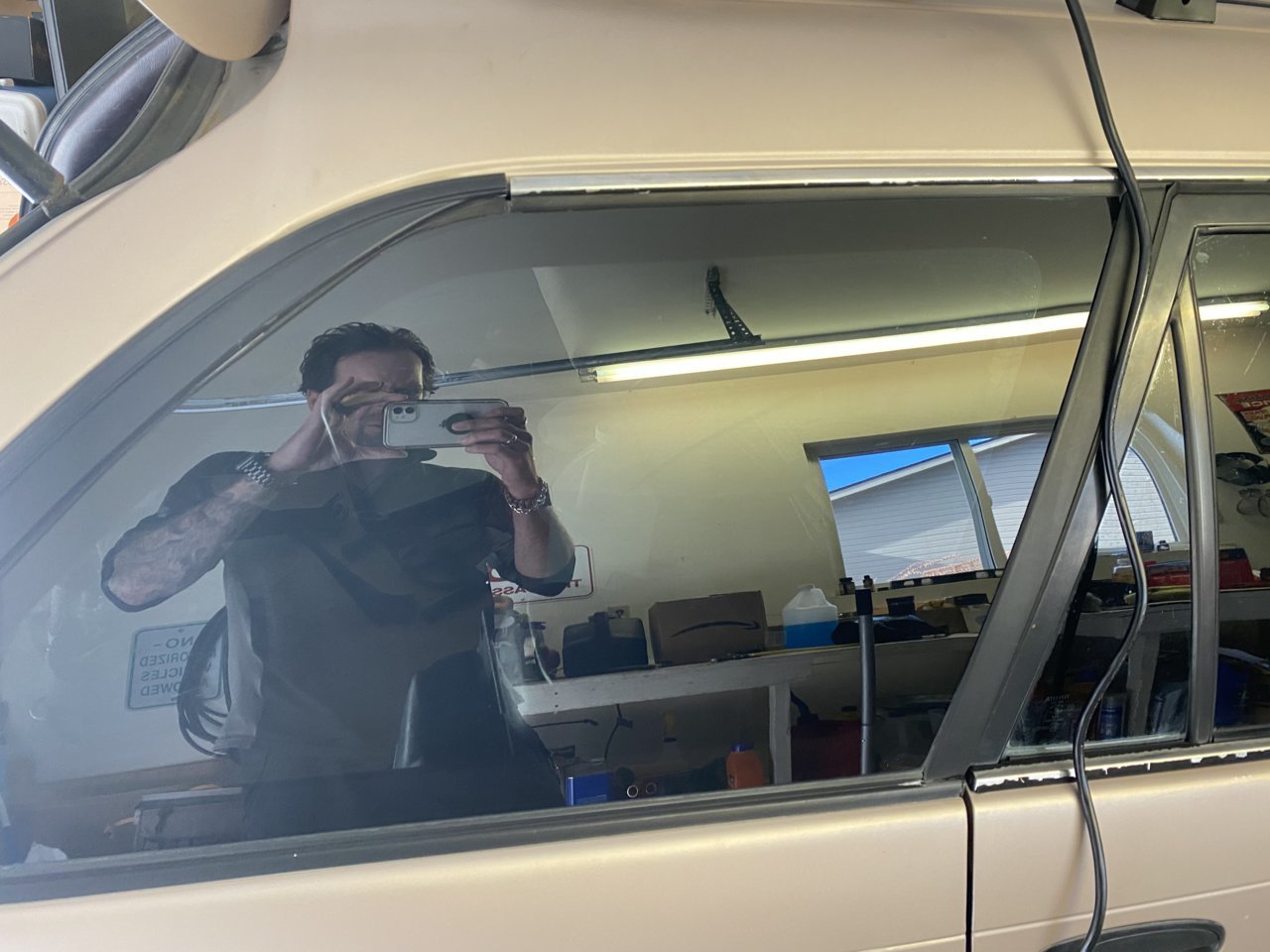

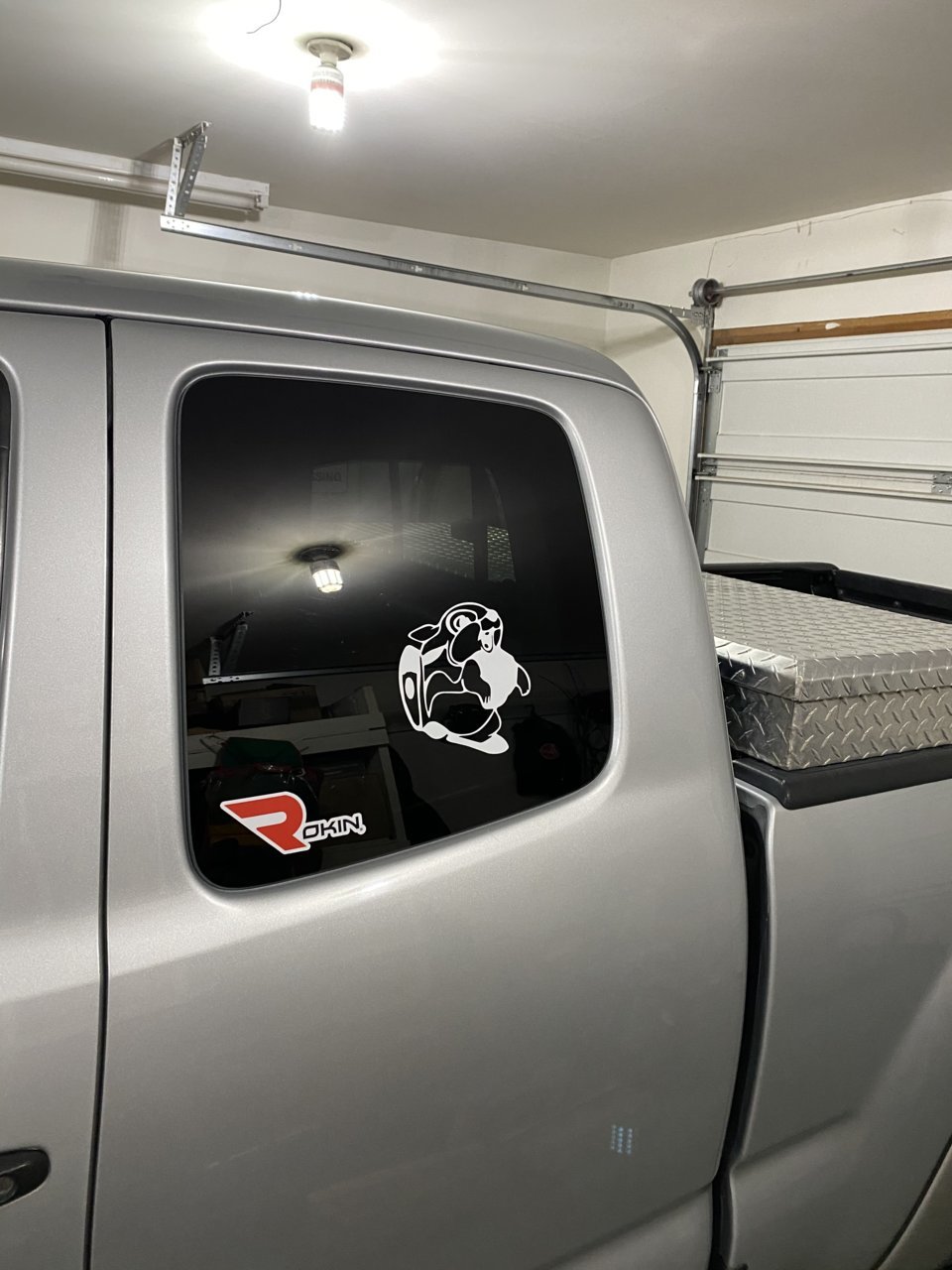

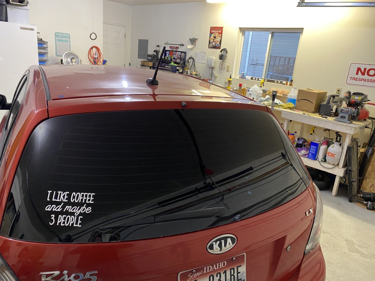

    Don’t give up if you really want to learn. There are a ton of instructional videos online you just have to practice the different techniques. Cutting is a lot harder then you would think and your going to mess up all of them at first. Also the glass is not flat so you have to heat shrink everything or it will never come out perfect. Cleaning and prep is also super important. I did probably 20 or more windows before I started getting it perfect. Some your cut will be messed up and you will have to much gap or a bad corner. Some you will have a perfect cut then mess up and get a wrinkle while your tucking and it’s trash and you start over. The heat shrinking is not to hard to get down but you have to work slowly with it and not try to shrink to much at once or it will Crystallize or fold over and itself and cause a wrinkle. You will need to invest is some tools of the trade but they are all pretty inexpensive. Start with the cheap rolls from Walmart and don’t waist your good stuff till you feel like you have it down pretty good. I have found baby shampoo in water works just as good as the more expensive stuff for slip solution. Anyway just have fun with it and don’t worry if it’s not perfect right away it takes a little time like learning any new skill. I’ll post a couple pictures of one or two of the cars I’ve done. If you keep going and I can be of any help just let me know.

    9D399731-1985-45F9-830B-1139B77E751D.jpg 3058ED75-BFB1-4CF6-89B0-37E011D7C65A.jpg
    Sorry man got distracted with a movie. Here are a couple pictures of the first few jobs that started to come out well. You can absolutely do this yourself it’s not like painting. 50 bucks in tools and another 50-100 in practice film and you will have it down. By the time I got to my truck you couldn’t even tell it wasn’t done at a shop.

    Those look great! I used to be able to do tint when I was younger, I just cant do it anymore though... might be too out of practice.

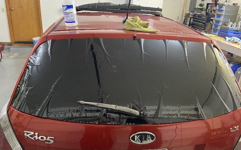

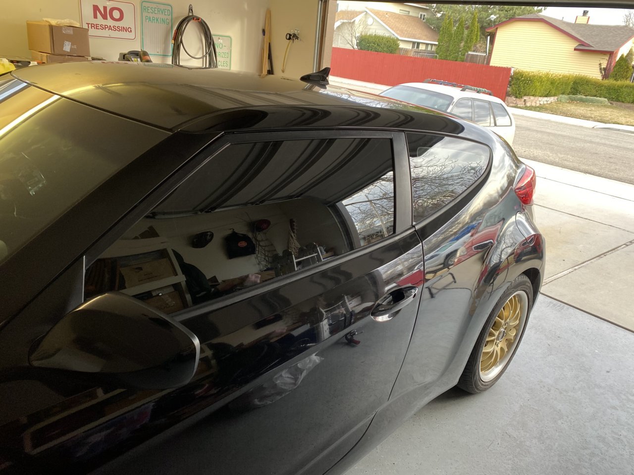

    26C794F3-6DE6-4C78-904C-3C0E705EB844.jpg 83D58462-DFDE-4926-8226-2196DF145F01.jpg AC762819-6FFD-44E0-A75D-4D37AF89097B.jpg

    Na man you got this. No way it’s worth 800 bucks for a tint job. Whatever you choose to do though I’m sure it will come out looking good. Toss up a pic or two as you go or after you have it done have it done. It’s always fun to see the end result.
