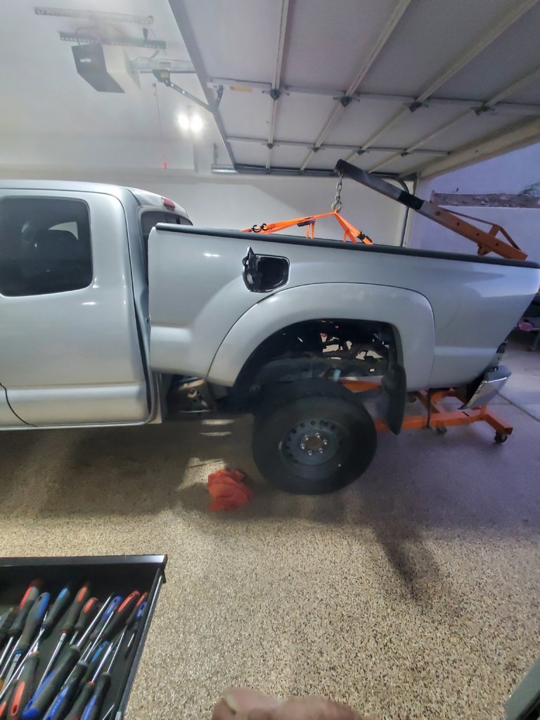

    I didn't have access to a lift here so I raised the box. It was a very easy job. New pump went in without any problems.

    I used an OEM pump from Toyota. I figured the previous one was still working at 238,000 miles so why not, so it was just a plug and play, no extra pipe. The cap lock has a bunch of ridges on it so I just tapped it with a screwdriver and it came off and went back on easily. I actually had great access with the box lifted partway.
