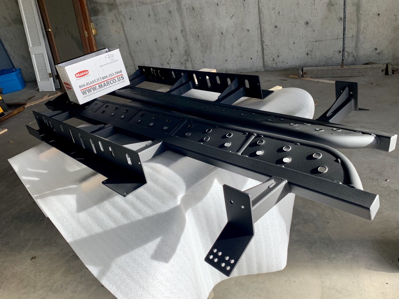

    I just picked up a new set of Victory sliders. Being able to touch them up after they inevitably get scratched/dinged is a huge plus. I've never bedlined any of my skids before, but I am very pleased with the rustoleum spray on bed liner. It self leveled nicely, provides a small amount of grip, and can easily be touched up as needed.
    1) CLEAN all debris/oils off sliders
    2) Two coats Rustoleum self etching primer
    3) Two coats Rustoleum semi-gloss
    4) At this point, my wet dog decided to shake all over the fresh paint and I decided to clean again and top coat with Rustoleum spray on bed liner.
