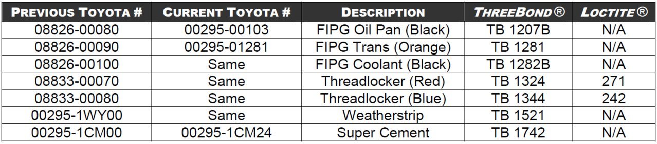

    Use the 00080 on oil sections and 00100 on water pump sections (or their equivalents).

    00080 is old, the updated # is 00295-00103
    I’ve heard Permatex “The Right Stuff” is as close as you can get on a budget.
    It too, is immediate return to service. I don’t know anyone that can get all the stuff bolted back on the front of the engine “immediately”. It’d take me hours:rofl:

    Yes, I'm aware the 00080 has been superseded. I just wanted to point out to OP which rows on that chart he needs to go with and he can cross reference them to whatever equivalent he decides to go with.

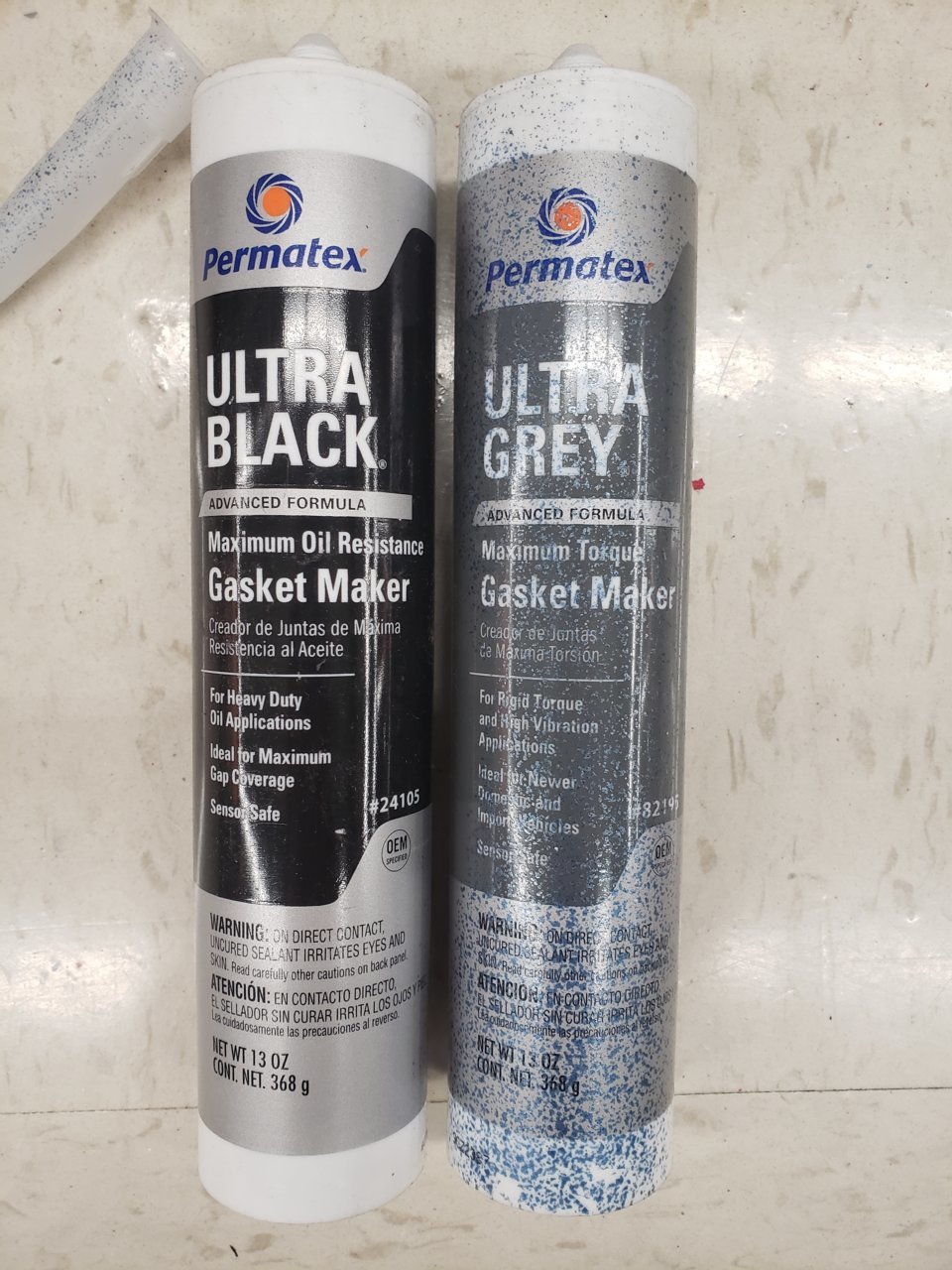

    So I am thinking to go with a small tube (3 oz) of Ultra Gray for the pump inlets and a large (caulking sized, 10 oz) tube of The Right Stuff Black for everywhere else.
    But is the Right Stuff really that much preferable to the Ultra?

    When my brother and I did my truck we used the OEM black but after doing it I wouldn't hesitate with the Permatex black.
