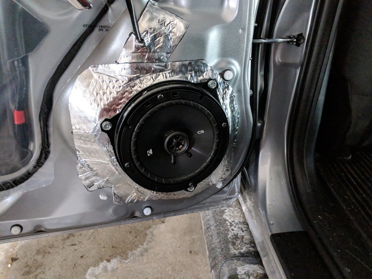

    I simply swapped speakers. No amp. And I applied Noico sound dampening to the doors while I had them apart. Looks like the Infinity Reference speakers I purchased over the Black Friday sale are no longer available. Perhaps they are discontinued items. These were all half price if I remember correctly.

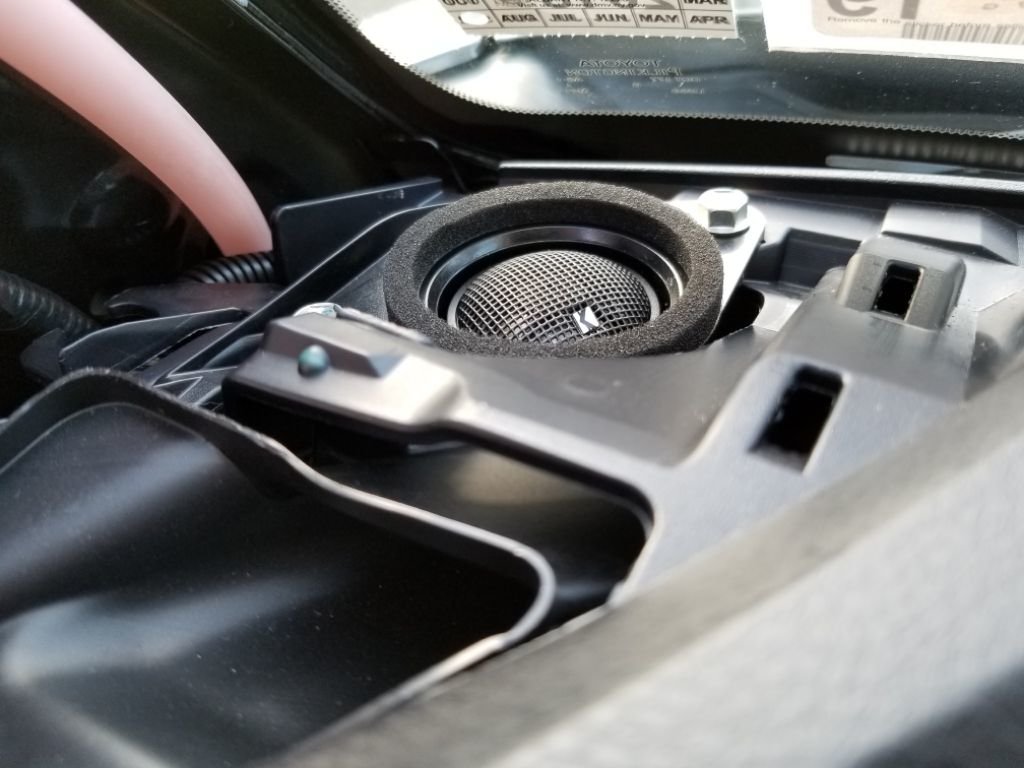

    Well, Subaru tweeter installs went well last night. Took 15 minutes a side. I tested the waters a bit by loosening the front panel without removing the pillar covers and I'll be honest with you, whoever said or suggests you can do that and not damage the panel or snaps is either brave, foolish or lying. I could tell very quickly that going that route was going to cause more problems. So I snapped them back in, took the extra 5 minutes to remove the pillar covers and carefully moved them out of the way.
    I will say that you do not need to remove the rubber seal trim. If you're careful, the panel will simply pop a little and come right out and putting them back in is a simple matter of taking your removal tool and tucking the plastic underneath the rubber trim. The tweeters were stupid simple to remove, unplug, and get back in. Snap the covers back in, snapped and bolted the pillars back in place and the whole thing looks like it was never touched.

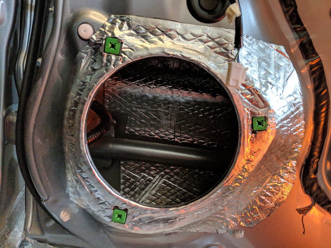

    I like your method on the sound deadner. On the second picture did you run the connector behind the door to the speaker, or just cover it with the noico.
