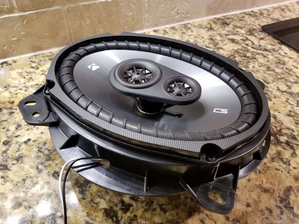

    Does anyone have a step by step instruction on how to install these speakers?
    I was getting ready to install these speakers today and I’m already lost by just opening the box. I have no idea where all these hardware are supposed to attach, is there a left and right speaker? The kickers also came with a grill? Am I supposed to install that too?
    The 6X9 adapters also didn’t come with any hardware but the 6 3/4 did.
    Sorry, I have no audio experience whatsoever...
    Any input will help before I say screw this and go with oem audio and have them install their kit lol
    Thx guys

    You do not use the grills. Attach the speakers to the mounts like this (another member's photo I found)...
    Screws were included with mine. I had to angle them slightly to fit all four corners. Make sure the hole for the wire feed is upward when bolting to truck door.
    Also, you need to break off the inner tabs on the round rear mounts with a pliers to fit the speakers to them.
    Hope that helps you some.
