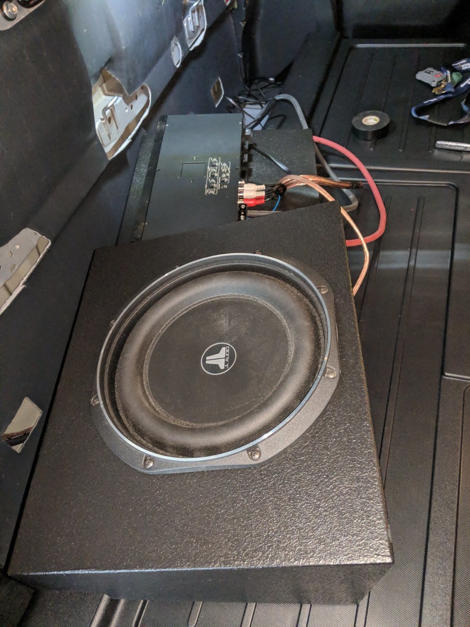

    @CoastieRon what amp and sub did you install? Any pics? Did the amp also hook up to the other six speakers (I’m assuming you did the tweeters, 6x9’s, and 6 1/2’s)? This is the route I’m planning but clueless to the wiring needed!

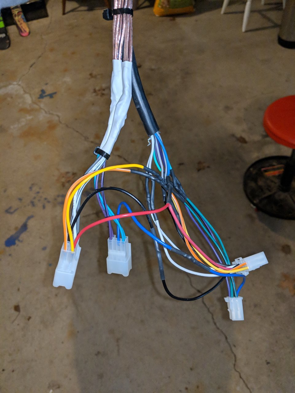

    Ok. Here is what I did for wiring:
    These harnesses go from the head unit to the amp, then from the amp back to the OEM harness that unplugged from head unit. In other words, I used all of the OEM wiring.
    I used an Arc Audio 850.5 amp, but you could use any amp that accepts speaker level inputs.
    There was a lot of soldering involved. Like a lot. If you can solder, you can do this. I just need to write down what I did.
    The sub was a left over 10tw1 by JL. The box is by @Mr Marv . He was very supportive and I spoke on the phone with him a lot.
    Ping me outside of the thread. If I don't get back to you right away, it's because I'm trying to get everything on paper.. .
