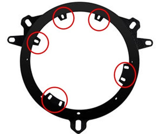

    - As already covered, the front Metra speaker adapter screw holes don't line up nice with the 6x9 speakers. Apparently this is an issue with both the Kicker and JBL speakers, so not sure what Metra is using as a standard. As mentioned, start the screws at an angle and you can get them cinched down, it's not that far off.

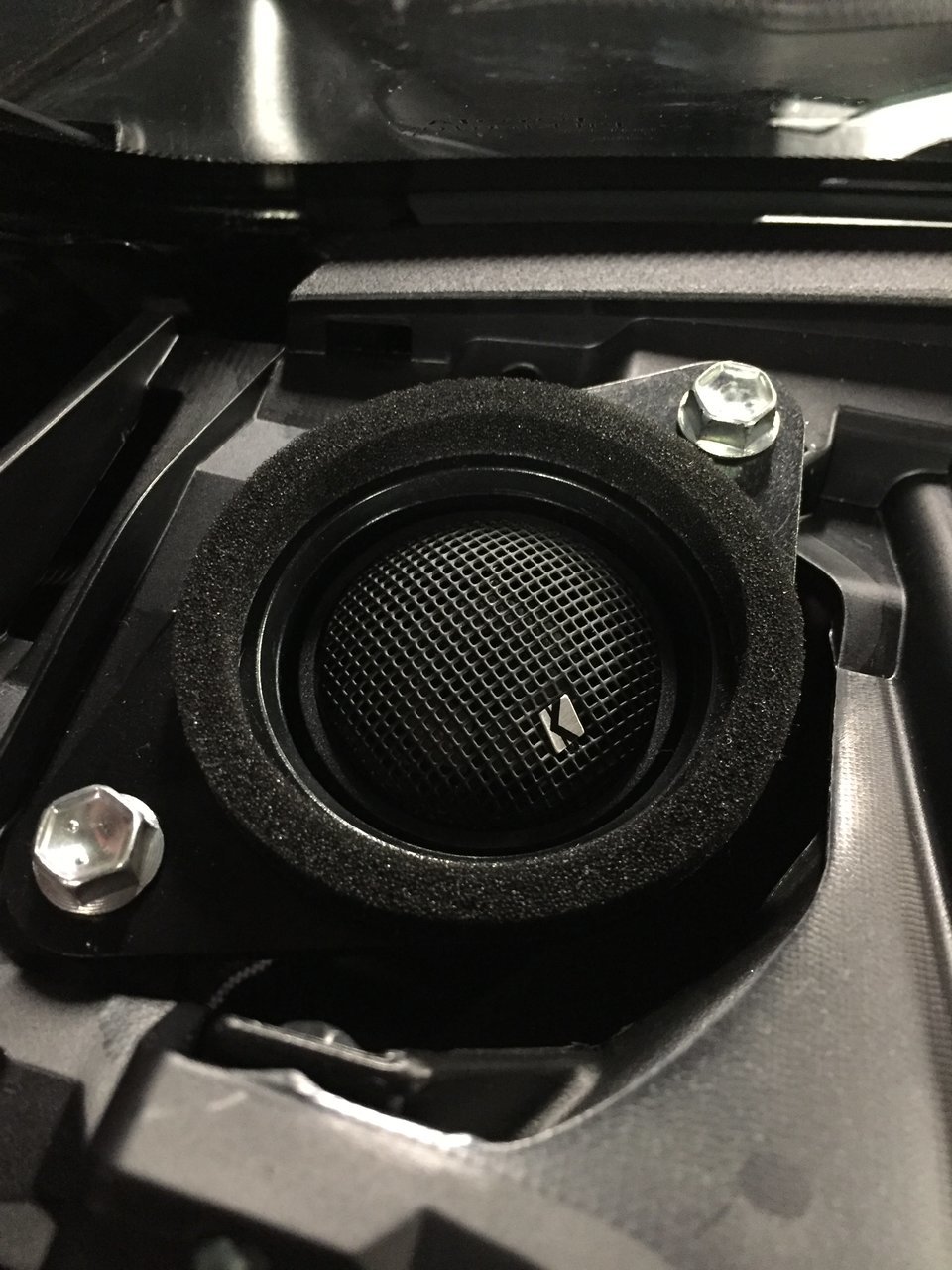

    B14612E6-B427-4348-9BC9-D4236E71D868.jpg Replaced my JBL tweeters with the Kickers.

    I thought the same thing on the tweeters, but they are actually Kicker tweeters and do have a high pass filter that allows more frequency through than the stock speakers. This is covered in the thread. Way better than stock and just bolt right in. I think most everyone here has been ordering from Crutchfield and getting the free installation gear, I don't recall anyone cutting anything up. For component tweeter mounting (not covered in this thread), Crutchfield sells strips of back strap to make your own mount now. That's how I have done it on previous installs and it works well. This thread is all about cheap plug and play improvements, though.
