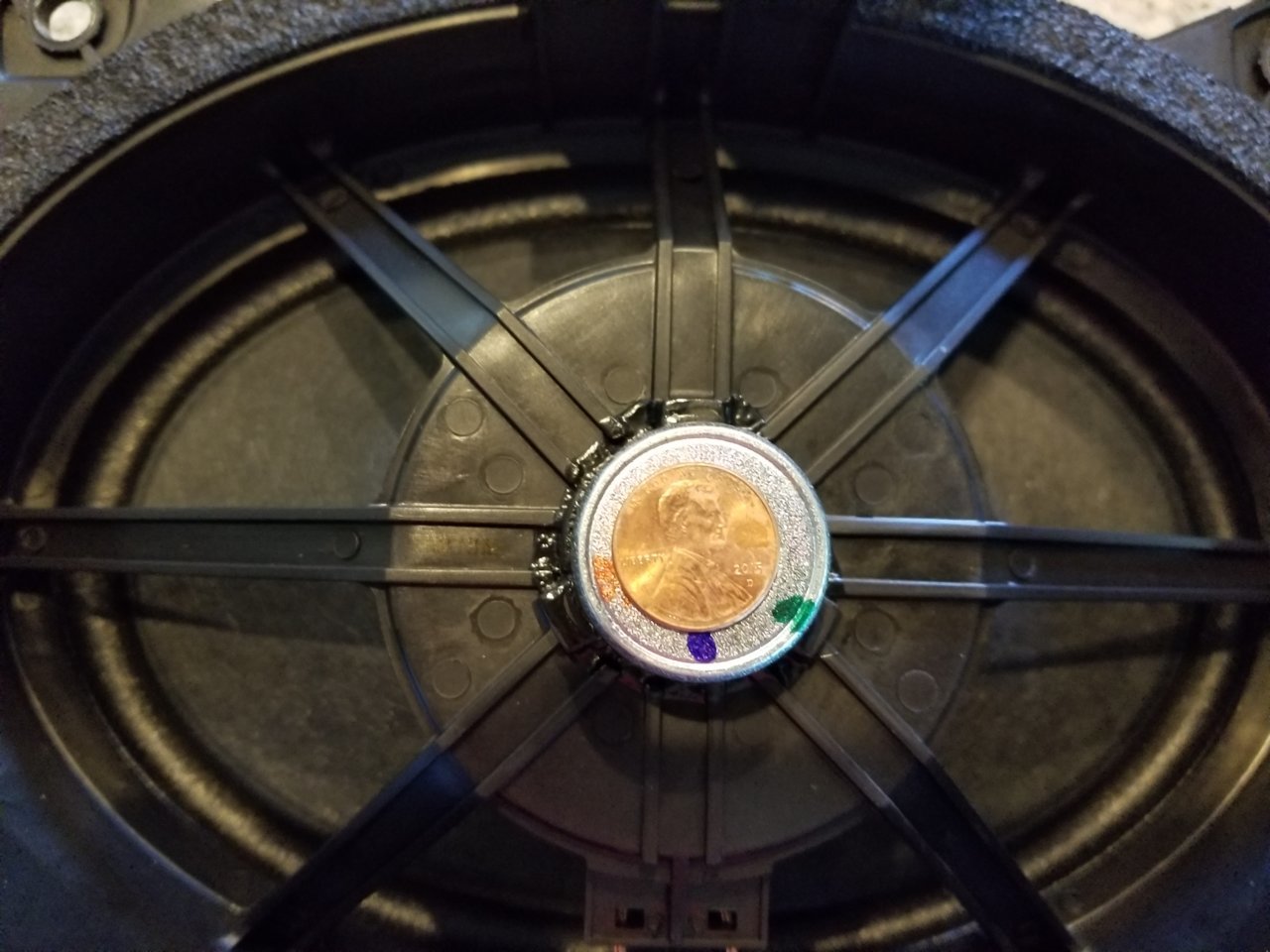

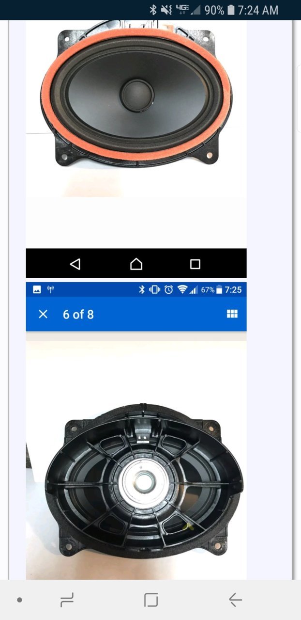

    The JBL has the same speakers all of us complain about with the non JBL (pictures somewhere on here prove that). My theory is that it sounds different because they have an amp and a sub, so you hear the bass and don't have gripes with the muddy door speakers because they're drowned out. They're also running 2ohm instead of 4ohm, I don't know enough to understand what the difference that makes.

    Higher impedance= less usable power. The JBL system I thought actually had upgraded JBL speakers, more power from the head unit, as well as a the sub. I had it in my second gen, but never saw the non-JBL to compare them to.

    Gotcha. I found the picture of the JBL. My pic below on the non JBL with a magnet a tad bigger than a penny.
    JBL
    Non JBL
