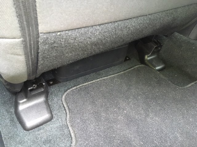

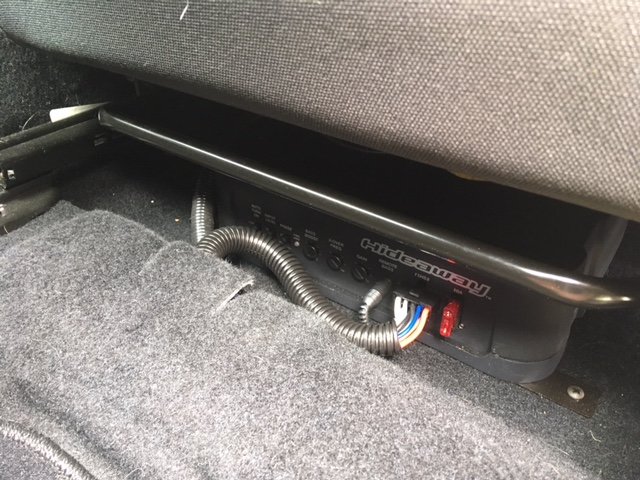

    If you on the fence about the kicker hideaway. DO IT !!
    Filled everything out perfect, don’t go half way, picked mine up online for 149.00 factory refurbished

    Did you install under the seat of a double cab? Any pictures?

    Mod fan
    Mod fan Well-Known Member
    Jan 21, 2018
    #241938
    227
    Drivers seat fits perfectly

    #241938
    227
    There is a vent under that seat you can mess with / seal off for a cleaner flatter install. That’s what we did

    itsmike
    itsmike Well-Known Member
    Feb 23, 2018
    #245397
    98
    SoCal
    2018
    @Mod fan. Looks good! Thanks for posting the pics!
