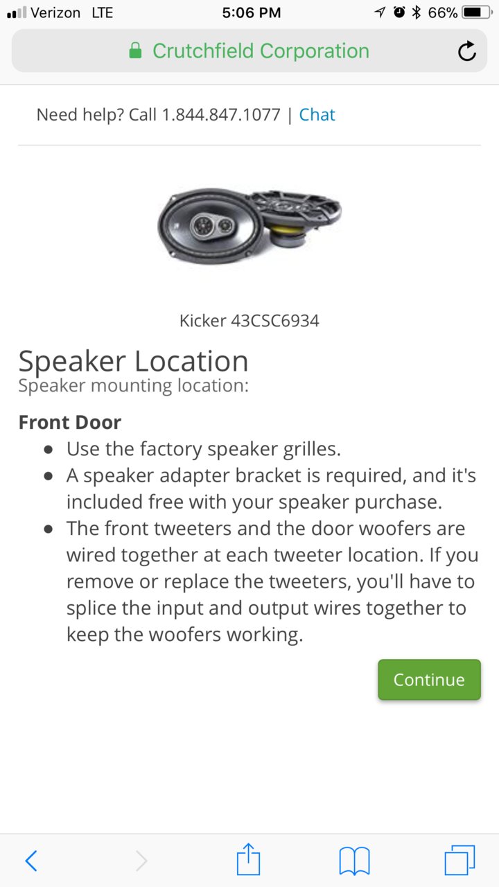

    Can anybody explain what Crutchfield is day in the last bullet point about the theaters and woofers being retired ?

    The wire for the front speakers leaves the head unit and runs to the tweeter. From there, it then runs to the door speakers. The door speakers will not work if the tweeter is unplugged, therefore you may have to splice some wires depending on the speakers you install. If you use the speakers in the OP, you don’t have to worry about this at all.
