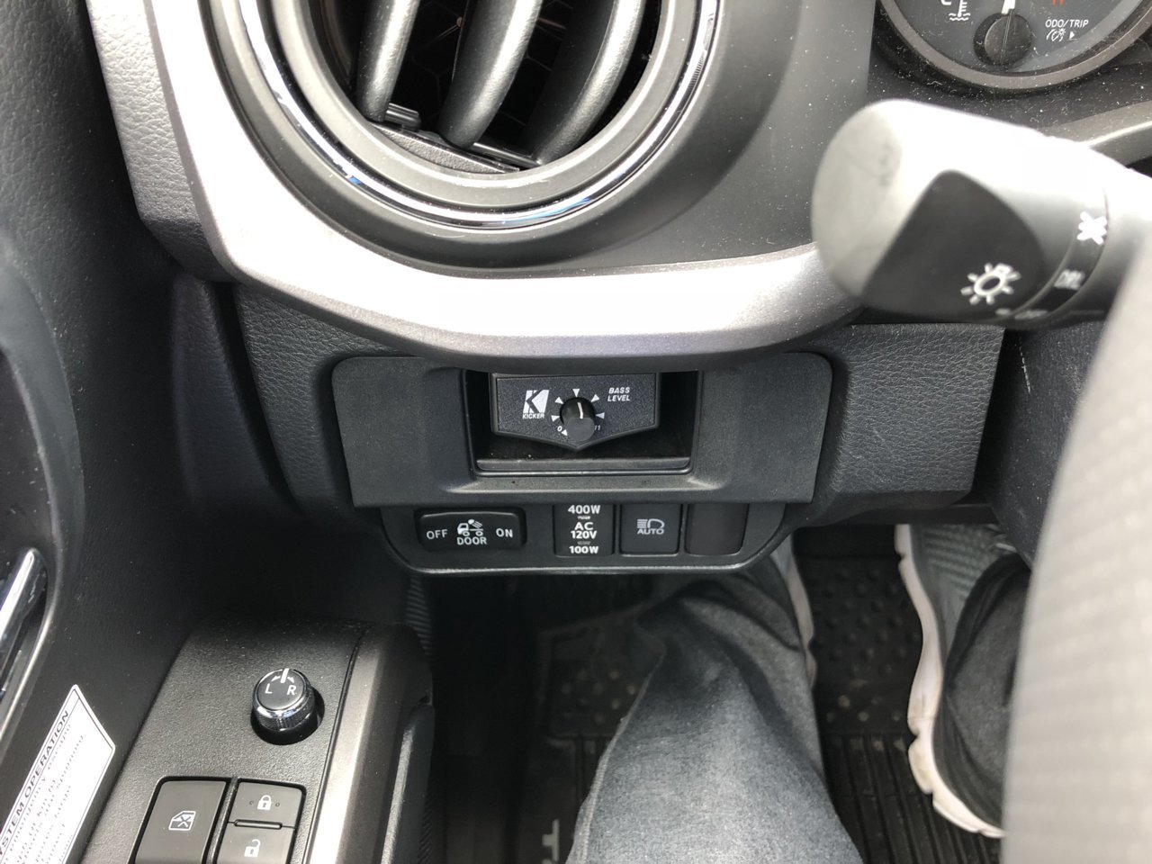

    Yeah, I keep a tool bag and raincoats back there. I wired in the volume control that comes with it.

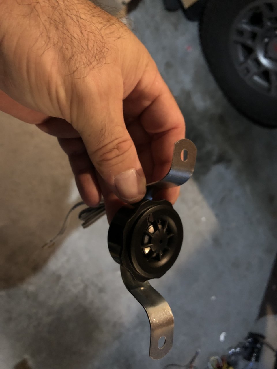

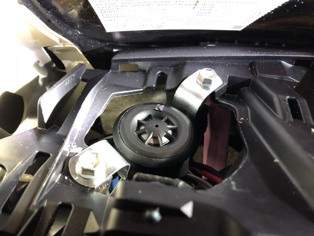

    If you aren’t worried about plug and play for the 3rd gen, you can also easily mount a tweeter in the dash, I just removed the setup in the OP and installed components. I used a pipe strap to make my own tweeter mounts.
