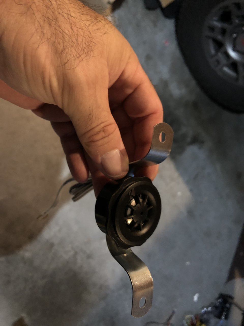

    Anyone use these to mount component tweeter in dash:
    https://www.amazon.com/Speaker-Adap...1-5&keywords=toyota+speaker+adapters+tweeters
    With the JBL crew cab setup. Can I change the dash and front door speakers to the below linked component speakers and NOT use the crossovers. Will it work. It seems the JBL amp controls the crossover point, However that may or may not be correct. I have not found any evidence that each speaker has a crossover of some sort attached to it. Supposedly the JBL amp is an 8 Channel DSP amp supplying different wattages based on resistance to each set of speakers (the sub as 2 speakers in a DVC setup). I am hoping the amp is also the crossover, yet I cannot prove this.
